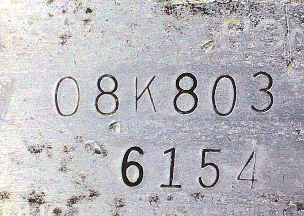

Anyway. He has a B-80 8 Speed. It has some numbers stamped on it: 08K803. Underneath that, is a number stamped 6154. I'm not sure what the significance of that is... maybe some kind of date code (a conclusion I came up with searching google..... much how I found this place).
That being said, there is no prefix 2 digit number before the 08K803... which would indicate the year from what I gather.

We have a B-80 model number #61-08K803...this would be a 1976.

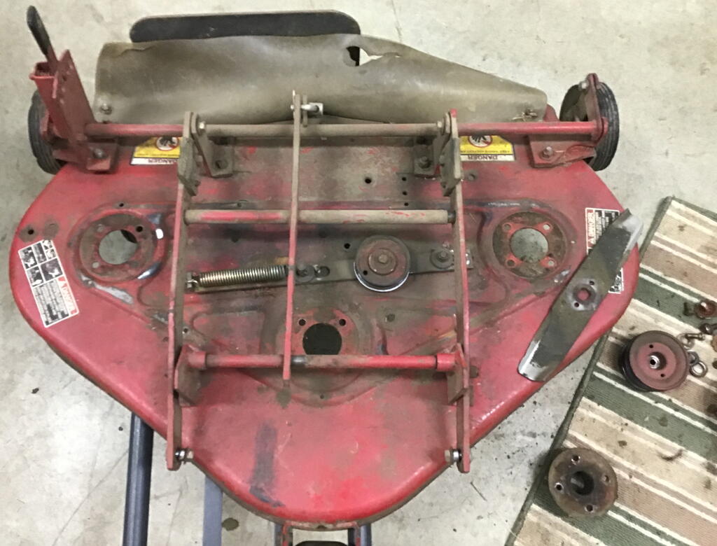

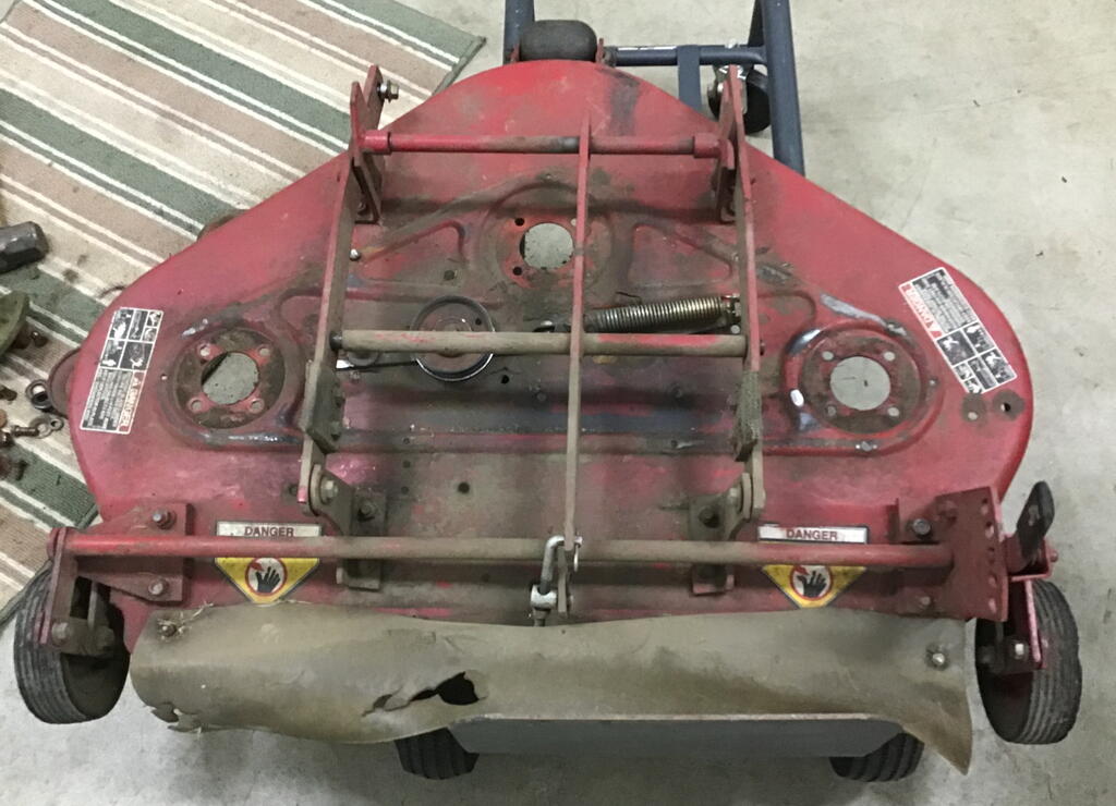

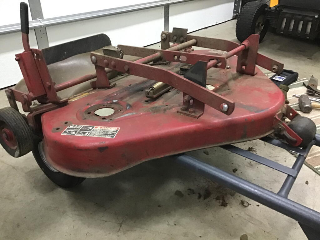

   A good picture of the deck would let us identify it for you.  At the top of our "Implements and Attachments" Section is a thread pinned at the top.  It is the "Chart Attachment Inter-change" ...you can use this to see if that NOS deck will fit that horse.  Some guys may join in here that may already know, but a picture of your deck would go a long way.  We have a few vendors that have used parts for everything that is Red.  Welcome to Red Square.  :occasion-xmas:

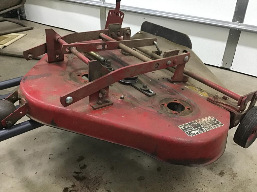

Here is the 1976 deck
The tractor model number 61-08K803 had the first 2 digits printed on the ID plate so likely fell off or faded.
The spindle bearing assembly is no longer available from Toro but Stens and Napa have them.
There is info here on the bearing
Click on the pictures to see notes on the files.

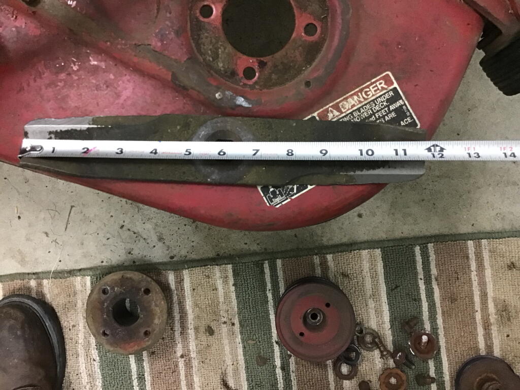

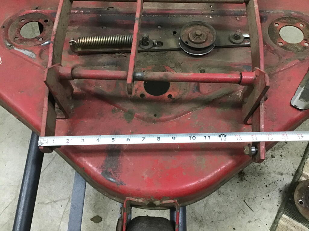

Alright, here are the deck pictures!
Also the blade length, which looks like it's 11-3/4".
And what I had to work with with a serial number on the mower.
So, what do I have? Where can I get parts? Thanks

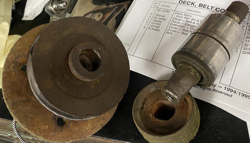

I have those spindle assemblies listed in the vendor's section of the classifieds- K & B Horse Parts,  pm me if interested.
  • Like 1
gappvembe
Done!

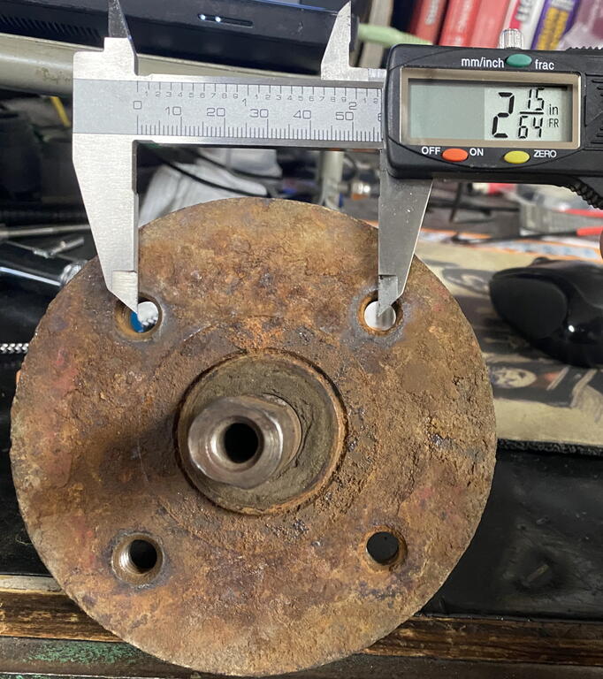

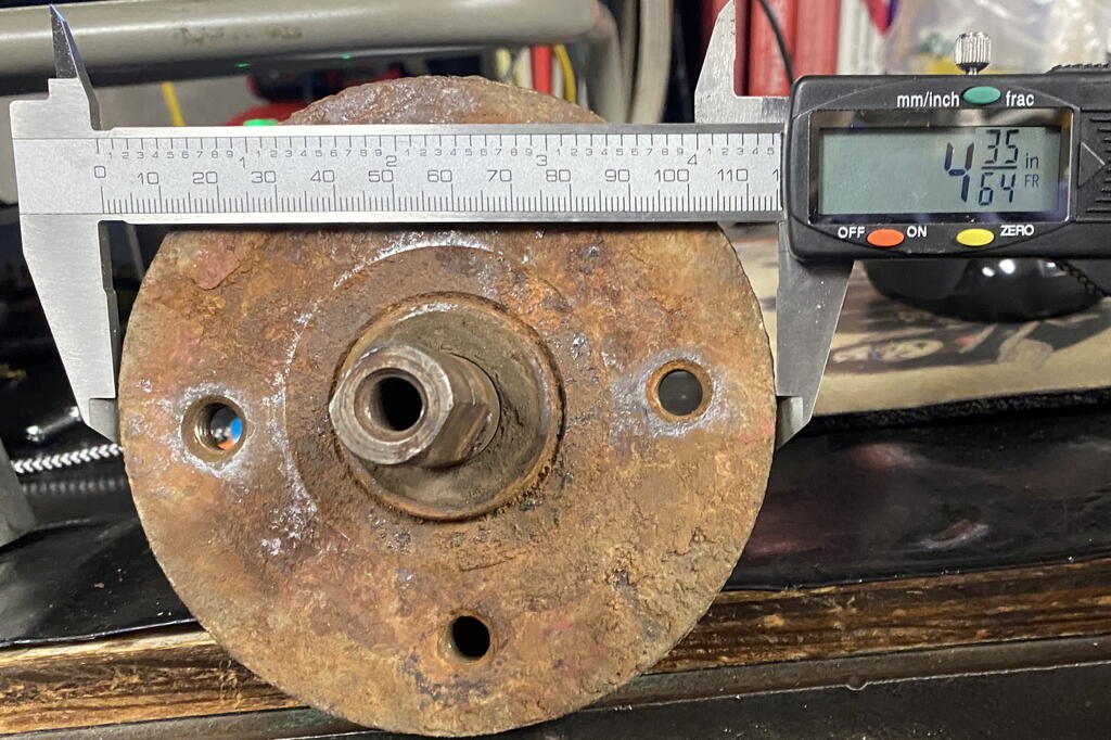

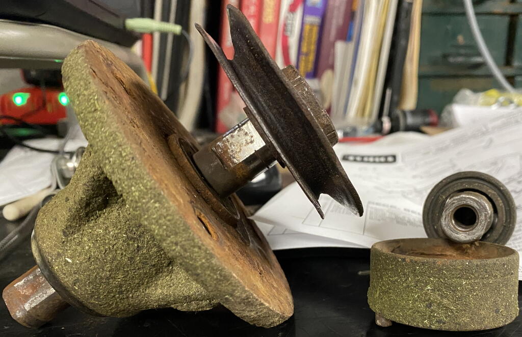

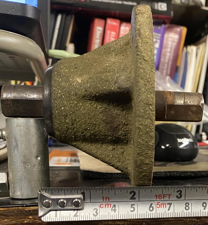

Here are the spindle housing dimensions/pics

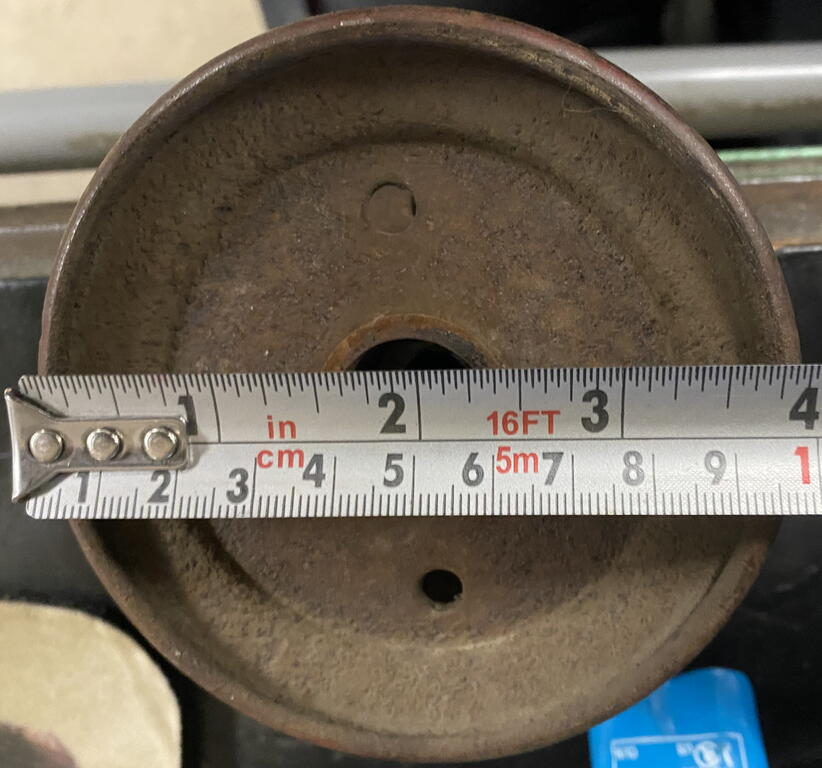

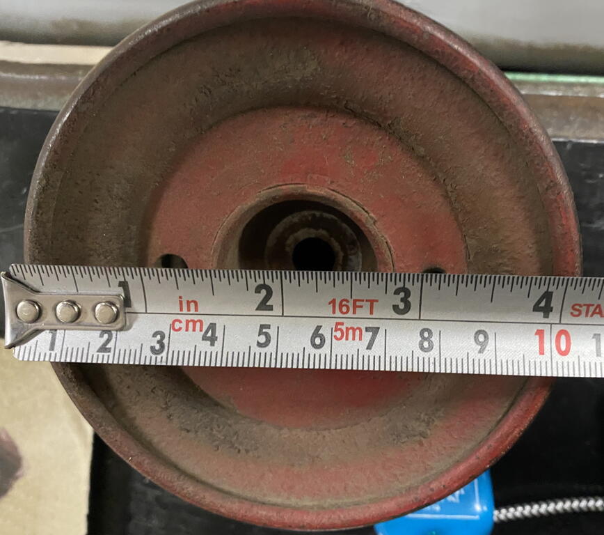

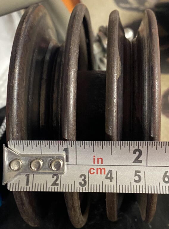

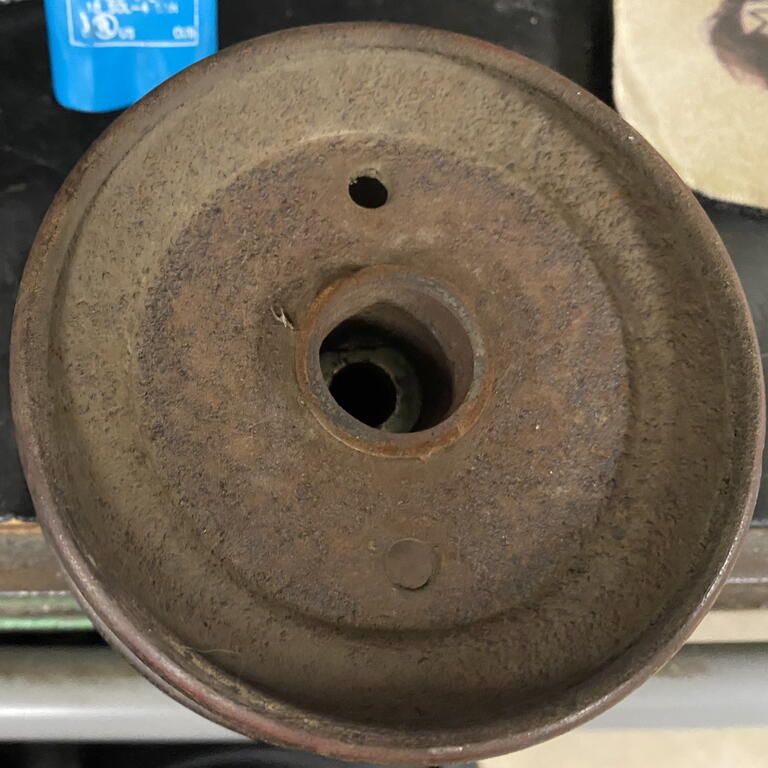

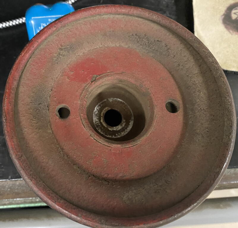

Main Pulley
  • Thanks 1

There are 2 belts.
I used the belt reader we have here at my work (I'm not too familiar with it and that's not what I do here... I'm the electrical guy).
They both are a 15 v belt.
The main drive one, from tractor to deck, and is broken, reads 910.
The blade belt that goes around the blade pulleys, reads 755

Just wanted to say 76c12091520h had all the parts I needed, and the mower cuts like new. Thanks for everyone's help!
