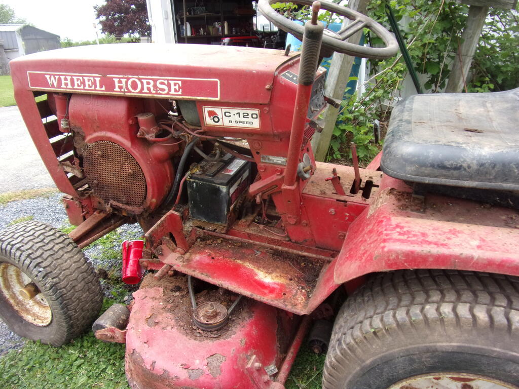

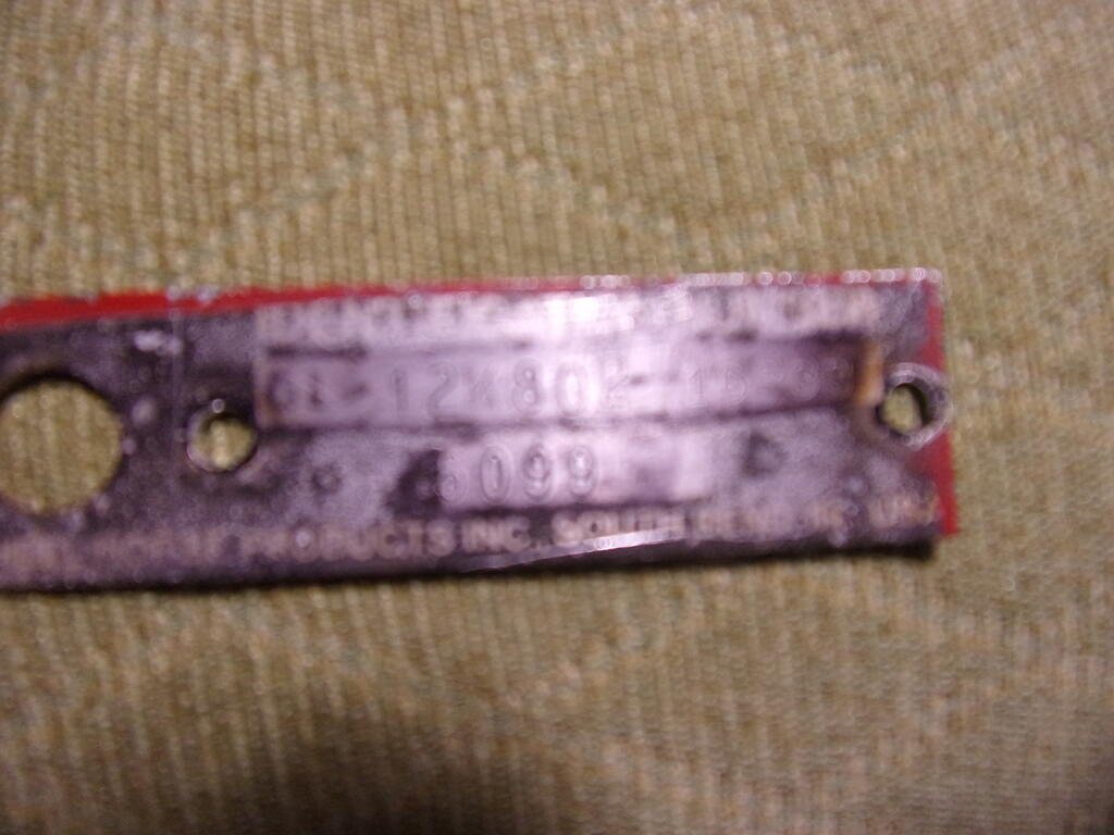

Ed Kennell 44,141 #1 Posted May 27, 2020 The tranny in the recently acquired C-120 -8 is locked in third gear. I pulled the shifter out and the 1/R fork is centered, but I can not pry the 2/3 fork out of 3rd. The input pulley, brake pulley, and axles all turn as they should. The oil looks good and there was no water in the case. Any ideas how to free this without splitting the case? Garry, @gwest_ca here is the ID plate on this '76 C-120. 61-12K802-16333 6099 Share this post Link to post Share on other sites

The Tuul Crib 7,340 #5 Posted May 27, 2020 12 hours ago, Ed Kennell said: The tranny in the recently acquired C-120 -8 is locked in third gear. I pulled the shifter out and the 1/R fork is centered, but I can not pry the 2/3 fork out of 3rd. The input pulley, brake pulley, and axles all turn as they should. The oil looks good and there was no water in the case. Any ideas how to free this without splitting the case? Garry, @gwest_ca here is the ID plate on this '76 C-120. 61-12K802-16333 6099 Yikes! Share this post Link to post Share on other sites

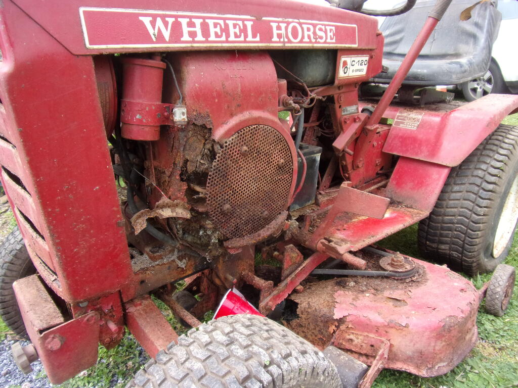

Ed Kennell 44,141 #6 Posted May 27, 2020 2 hours ago, stevasaurus said: I know Richard. I feel like I should get a Tetanus shot just looking at it. C'mon guys. Yeah, her front is sorta ugly, but her rear end looks pretty good. I wasn't her fault that some stored a leaking bag of rock salt or fertilizer on her left front tire. I'm just trying to determine if she was parked due to the tranny being locked in 3rd gear or because the engine locked up. 1 1 1 Share this post Link to post Share on other sites

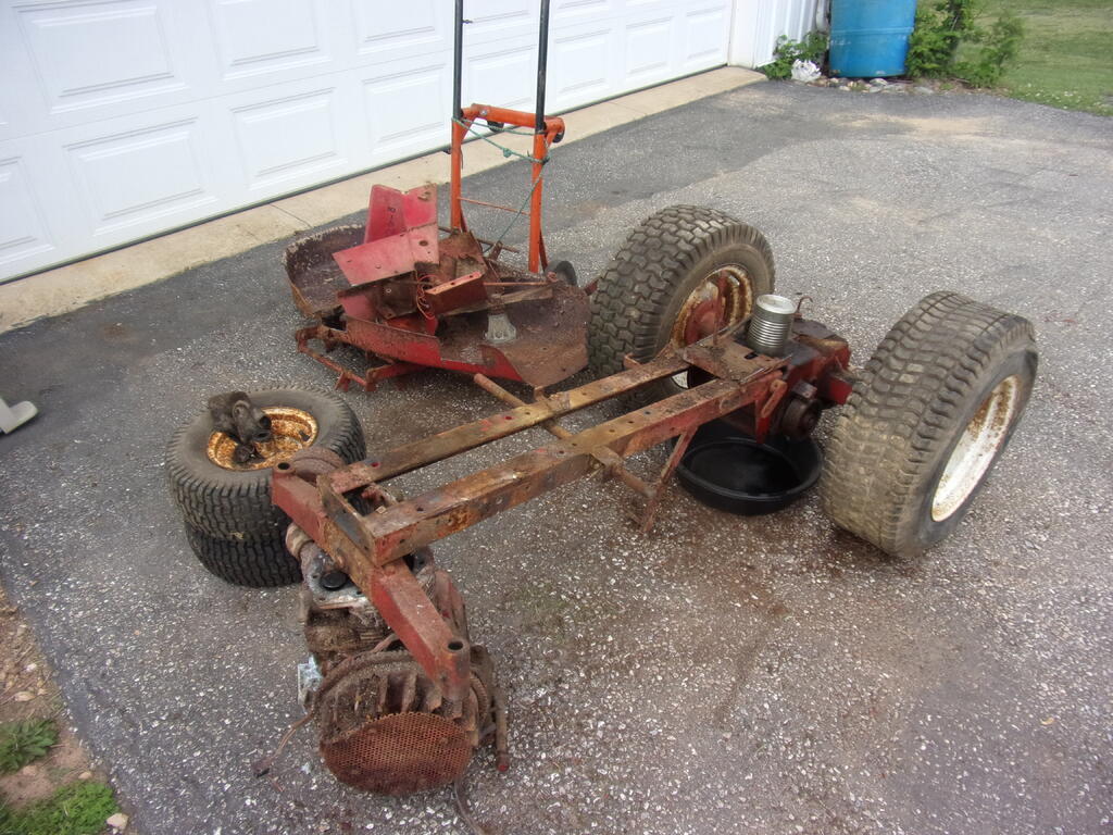

Ed Kennell 44,141 #9 Posted May 27, 2020 OK Steve, thanks for the detailed write up. I have done exactly as you suggested and I also am convinced this is a good tranny. The axle bearings feel good and the seals are not even leaking. She is full of diesel and soaking. The brake shaft seal is weeping a little. Input shaft is dry. I have declared her a parts tractor. Everything will be saved except what you see on the bag truck. I was surprised, one of the deck spindles was good and actually took grease in the zerk. I cut it out of the deck along with the rollers and brackets. The engine will be a boat anchor. It is locked up tight. 1 2 Share this post Link to post Share on other sites

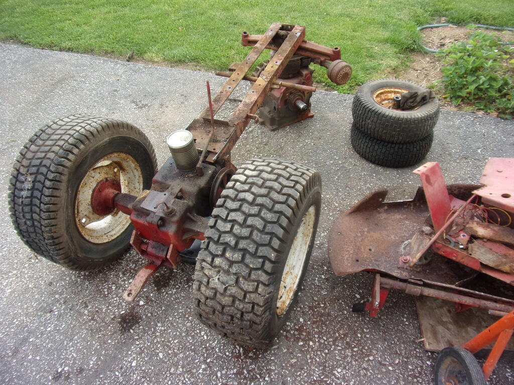

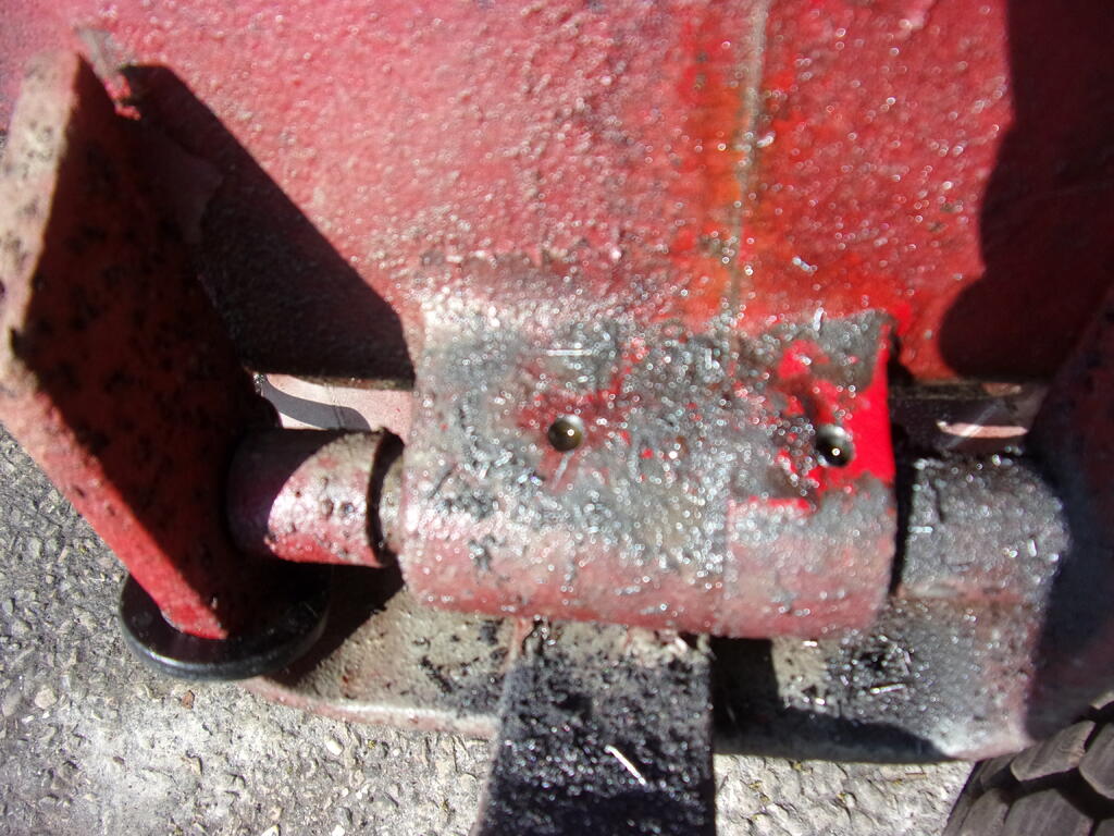

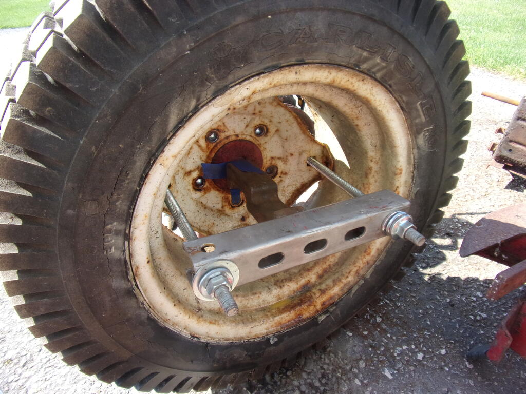

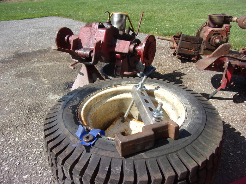

Ed Kennell 44,141 #11 Posted June 1, 2020 Getting ready to split the case just in case the shifter rail doesn't loosen up. Had to make a puller just to get the wheels off. Then drilled the tranny lugs to get PB Blaster into the hitch pin. Removed the hub set screws and filled all the holes with PB. Now we wait. 2 3 Share this post Link to post Share on other sites
953 nut 63,633 #12 Posted June 2, 2020 12 hours ago, Ed Kennell said: Now we wait May need to mark your calendar for a couple months from now on this one. That much rust won't go down without a fight. 1 Share this post Link to post Share on other sites
