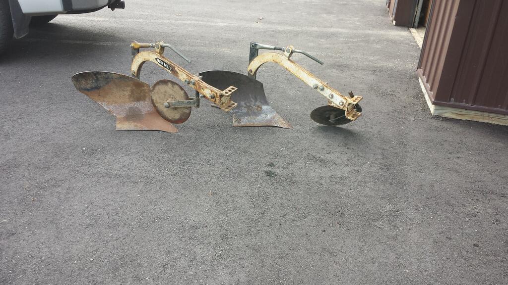

WHX?? 56,845 #114 Posted September 15, 2020 Sorry Green but trail ride tractors and plow mules don't mix. Be like using a diesel pulling truck for top fuel drag racing ya get my drift. Suck point on a Brinly should look like these. 1 Share this post Link to post Share on other sites
Greentored 3,220 #115 Posted September 15, 2020 @WHX24 maybe once I get another trail toy built ill go back to stock pulleys Thanks for posting that pic, mine definitely has an issue! Will be up there tonight again and will snap and post a pic. 1 Share this post Link to post Share on other sites

Greentored 3,220 #120 Posted September 15, 2020 @WHX24 I think we gots a problem here eh? Share this post Link to post Share on other sites
