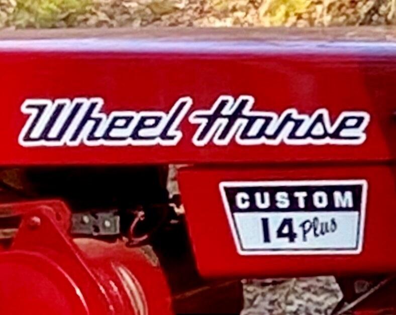

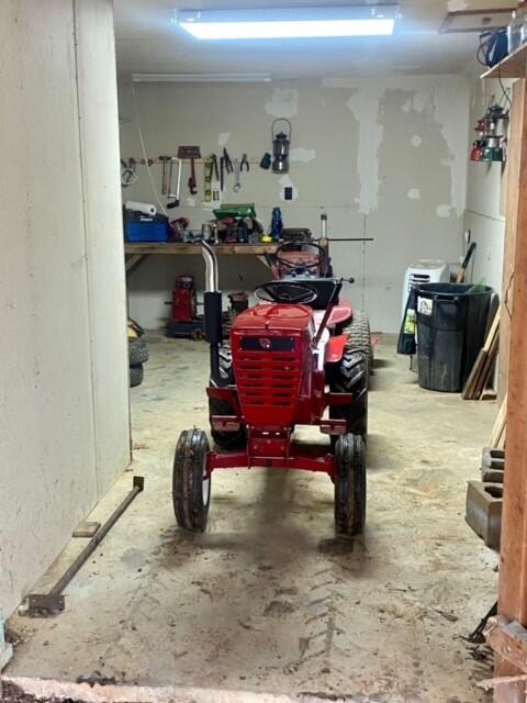

Greentored 3,220 #181 Posted February 17, 2021 Update: Hoss got the near-final adjustments and assembly, got a bath and went home to his stable yesterday, where he will have lots of room to play and lots of work to do! Still need to get a lift cable on and install some lights, and sometime down the road a PTO setup. Once the weather breaks (not long down here in nc) I'll throw a coat of wax on, do a quick photo shoot, and call this thread complete! Sure has come a long way from photo 1 eh? haha 6 2 Share this post Link to post Share on other sites
