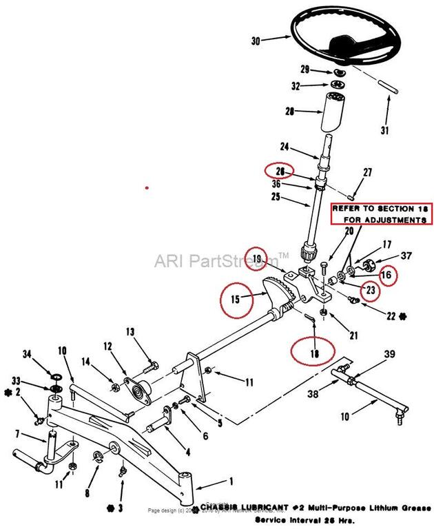

daveoman1966 3,884 #4 Posted May 24, 2020 (edited) 1) Use the COLLAR #26 to zero-out vertical movement of steering column. 2) draw the fan GEAR #15 back into the steering column gear by adding SHIM WASHERs 16 or 23 onto end of Lower Steering gear # 15 until slop is reduced and little play exists.. This image has a NUT on the end of the lower steering gear...MOST have just a COTTER PIN. Adjustment is the same. Edited May 24, 2020 by daveoman1966 1 Share this post Link to post Share on other sites

squonk 48,338 #6 Posted May 24, 2020 Part # 19 in Dave's diagram is prolly wallowed out. I probably have changed a dozen. And if the tractor has hyd. lift it's prolly busted at the mounting bolts as well. Share this post Link to post Share on other sites
BBELL94 25 #7 Posted May 24, 2020 3 hours ago, squonk said: Part # 19 in Dave's diagram is prolly wallowed out. I probably have changed a dozen. And if the tractor has hyd. lift it's prolly busted at the mounting bolts as well. 17 hours ago, daveoman1966 said: 1) Use the COLLAR #26 to zero-out vertical movement of steering column. 2) draw the fan GEAR #15 back into the steering column gear by adding SHIM WASHERs 16 or 23 onto end of Lower Steering gear # 15 until slop is reduced and little play exists.. This image has a NUT on the end of the lower steering gear...MOST have just a COTTER PIN. Adjustment is the same. I can't get enough travel out of the fan gear shaft to tighten up the lash in the fan gear and steering shaft gear. It seems like part #12 isnt allowing the fan gear shaft to slide back towards the steering wheel enough. And the fit of part #19 on the fan gear is not too sloppy, actually a slip fit 1 Share this post Link to post Share on other sites
squonk 48,338 #8 Posted May 24, 2020 The hole the steering shaft from the steering wheel goes into wallows out. This causes the little gear to move away from the fan gear.The support hole for the fan gear shaft does not wear out Share this post Link to post Share on other sites
BBELL94 25 #9 Posted May 24, 2020 2 hours ago, squonk said: The hole the steering shaft from the steering wheel goes into wallows out. This causes the little gear to move away from the fan gear.The support hole for the fan gear shaft does not wear out Gotcha, mine doesn't seem to wore out so I guess I got lucky. I ended up putting washers between where #12 bolts to the frame on the front of the tractor, so it moved my fan gear back about an 1/8". Then I adjusted the collar on the steering shaft up to make it a snug fit on down into the fan gear. Seems much much better now. Any idea what washers #29 and #32 are for? 1 Share this post Link to post Share on other sites
squonk 48,338 #10 Posted May 24, 2020 They are to take up slop and center the shaft in # 28 Share this post Link to post Share on other sites

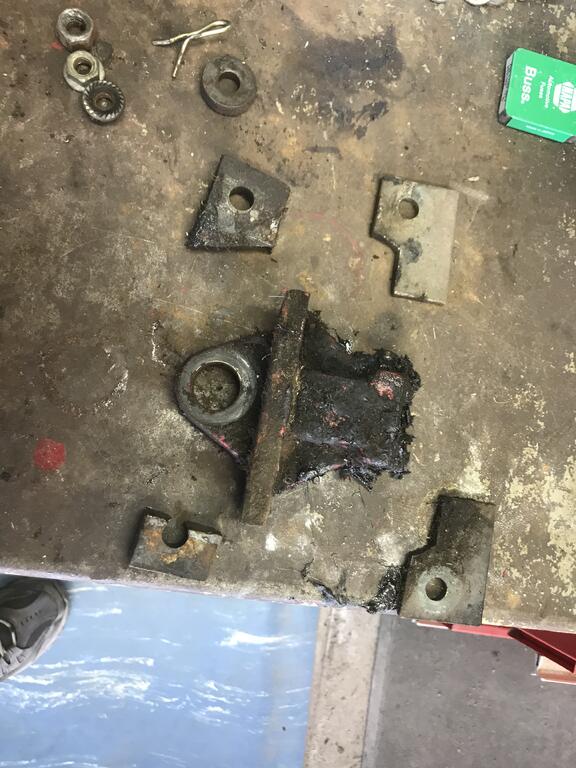

BBELL94 25 #11 Posted May 25, 2020 (edited) Got everything back together and it works great! I went and checked the piece the fan gear mounts to on my 417-A just for fun and sure enough its cracked where it mounts to the frame... go figure Edited May 25, 2020 by BBELL94 Share this post Link to post Share on other sites
