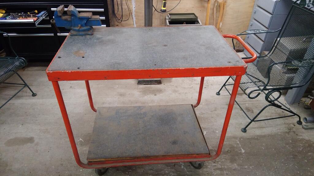

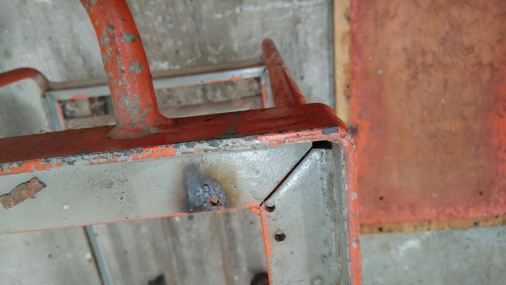

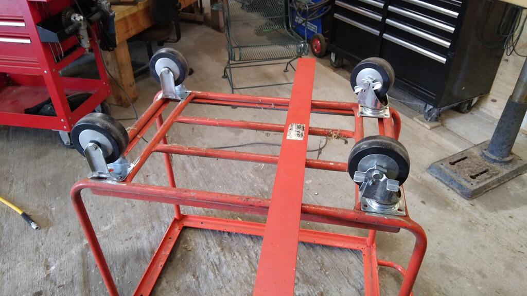

RandyLittrell 3,944 #1 Posted May 23, 2020 I am taking a heavy duty cart that was my Dad's and turning it into a mobile welding table/cart. Welder will mount underneath and adding on to it to hold the bottle. It will have 5/16" plate in the top, and I plan to add some holes for doing some fab work. I don't know what it was originally made for but its 1/4" T shaped steel on the top what seems like pretty heavy duty tubing. The wheels you see are what I am adding to it, they came off of a tool box I use for a dresser in my bedroom. I may take a while to get done, I will keep posting pics as I work. Enjoy! 8 Share this post Link to post Share on other sites

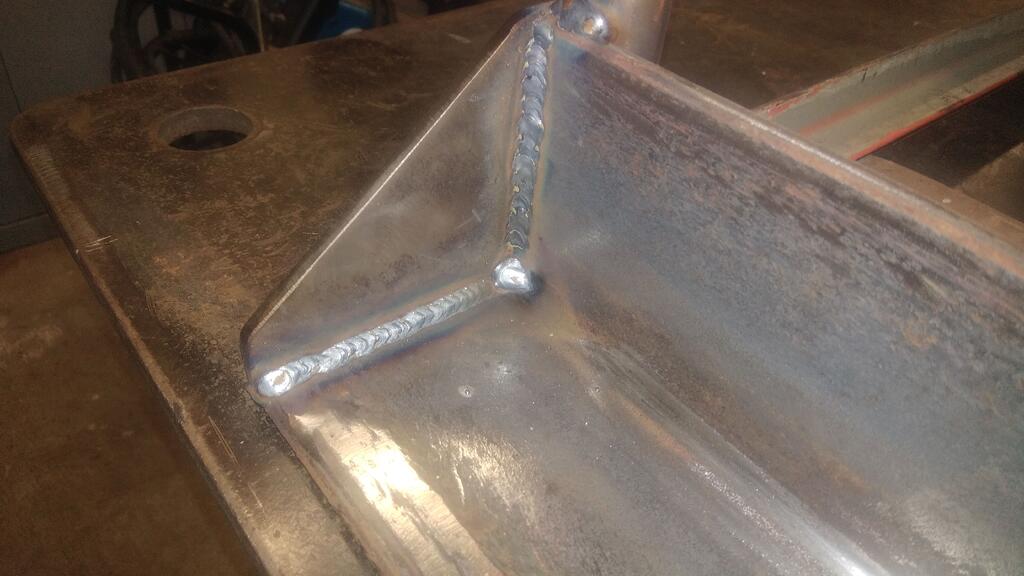

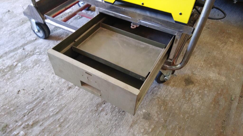

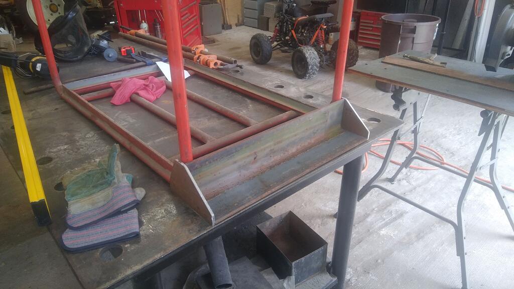

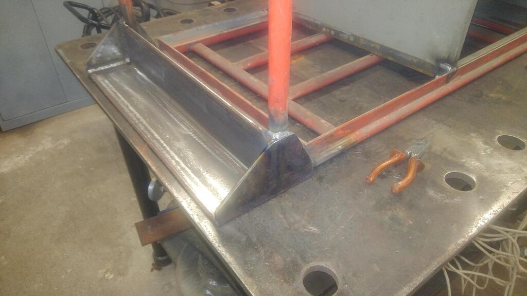

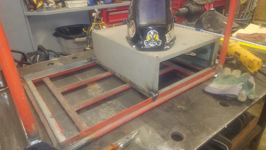

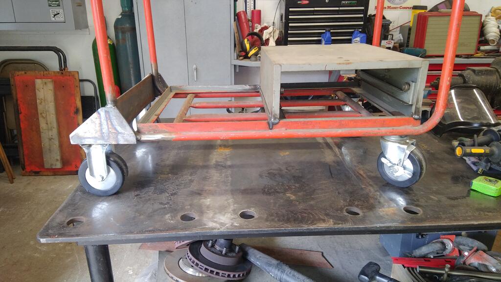

RandyLittrell 3,944 #5 Posted May 27, 2020 Got a little more done today. I had an old metal drawer with bearing slides that fits just perfect. Welded it in and the end plates that the bottle's and wheels will go on. I'm not the best welder, but I'm working on it. 2 Share this post Link to post Share on other sites

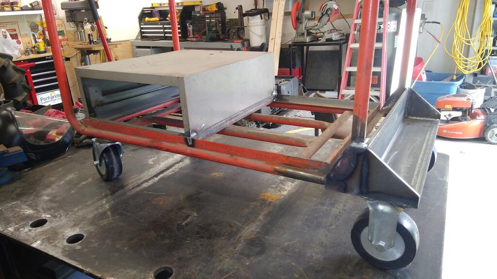

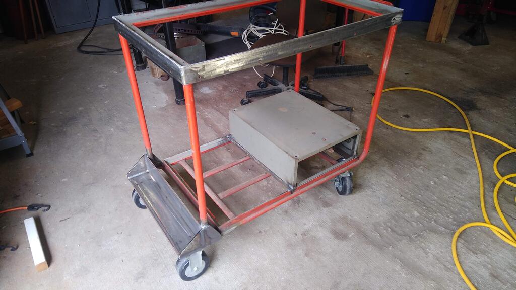

RandyLittrell 3,944 #6 Posted May 27, 2020 Welded the wheels on this morning, rolls good and everything still flat and square! I think I will weld up the mount for the welder and hose reels before I weld on the top. 2 1 Share this post Link to post Share on other sites

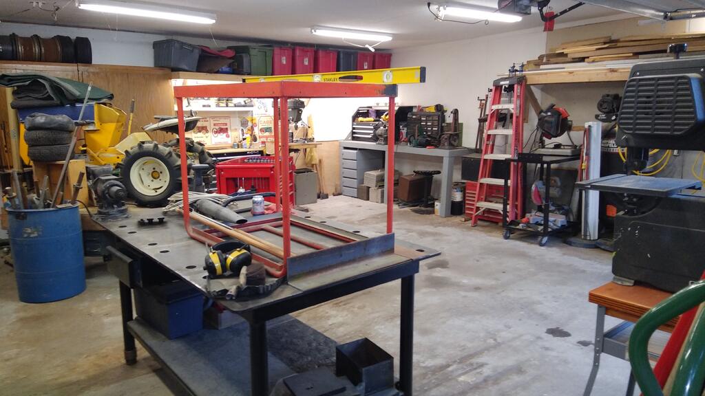

RandyLittrell 3,944 #7 Posted May 27, 2020 (edited) Probably all I will get done till next week, going camping this weekend. Removed pretty much all the paint I need except for the steel drawer, which I will DA that. Gotta decide what color to paint, I have black and red tool boxes and we have Miller welders. Gonna buy a Titanium mig 170 and it's green. Gonna have to cogitate on it. Edited May 27, 2020 by RandyLittrell 1 Share this post Link to post Share on other sites

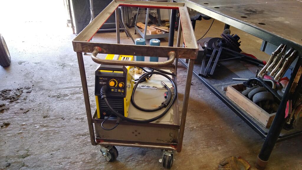

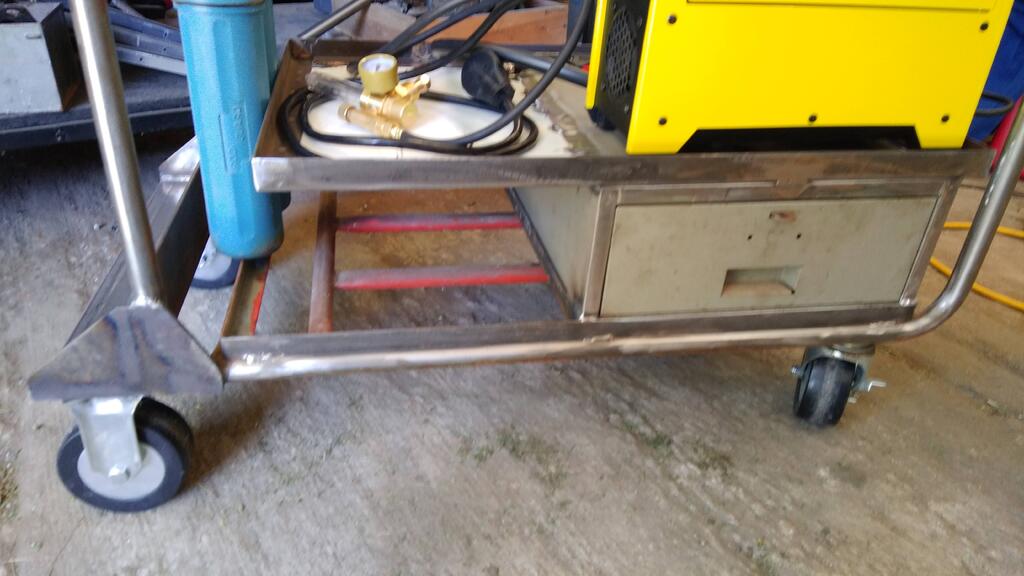

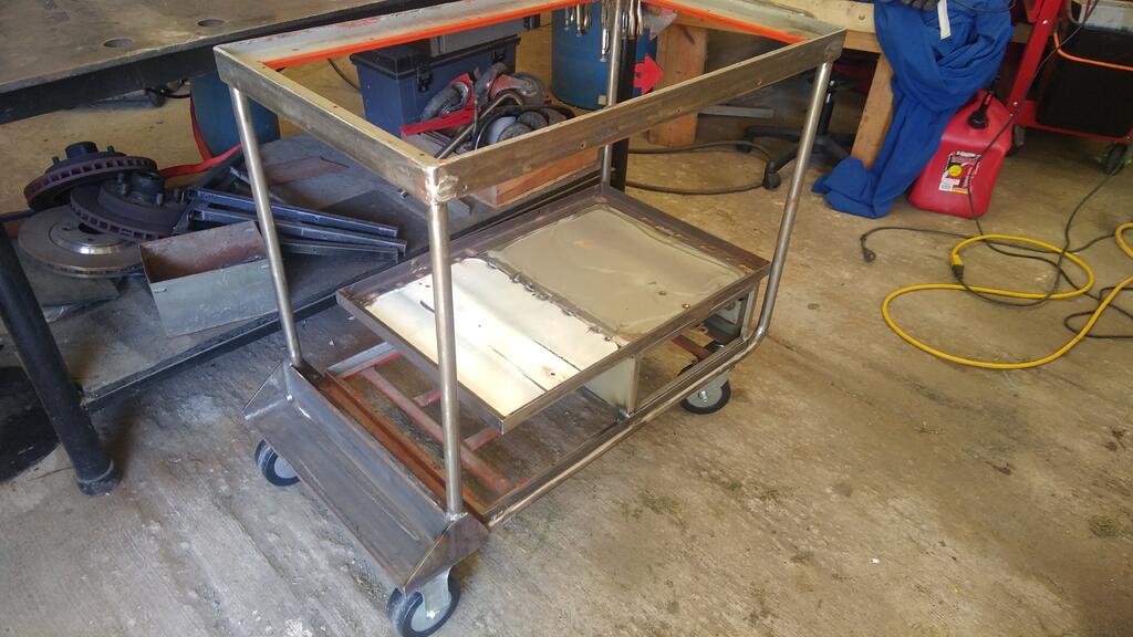

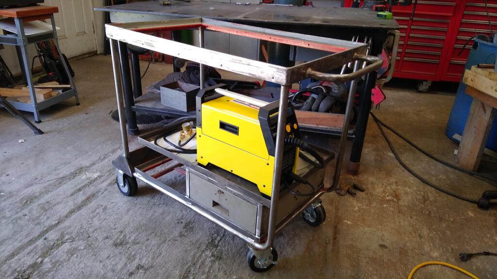

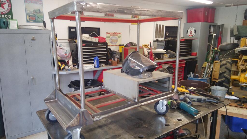

RandyLittrell 3,944 #9 Posted June 25, 2020 Have some more progress. Welded the shelf on that the welder will sit on. Kinda dwarfs my welder, but made to fit my Son's Miller as well as a plasma cutter or another welder could sit next to it. Will be putting expanded metal on the bottom shelf. Need to weld on some hangers to put hoses on yet, haven't decided just what to build yet. More cogitating! I have been happy with the welder, my son likes it too. My scratch tig set up has shown up and will give that a shot one of these days. Need to procure an argon bottle yet. The shelf is made of steel from a bed frame and some blank sign metal my Dad had. Don't know where he got it, but free is free!! Okay, on with the pics. 1 1 Share this post Link to post Share on other sites
