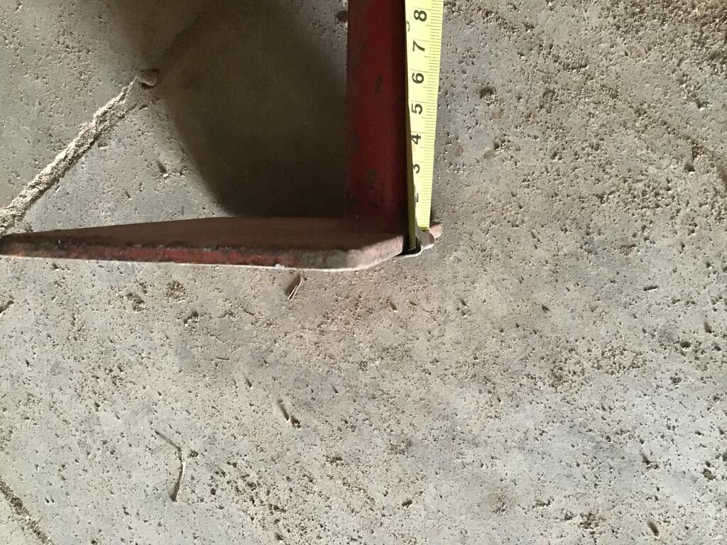

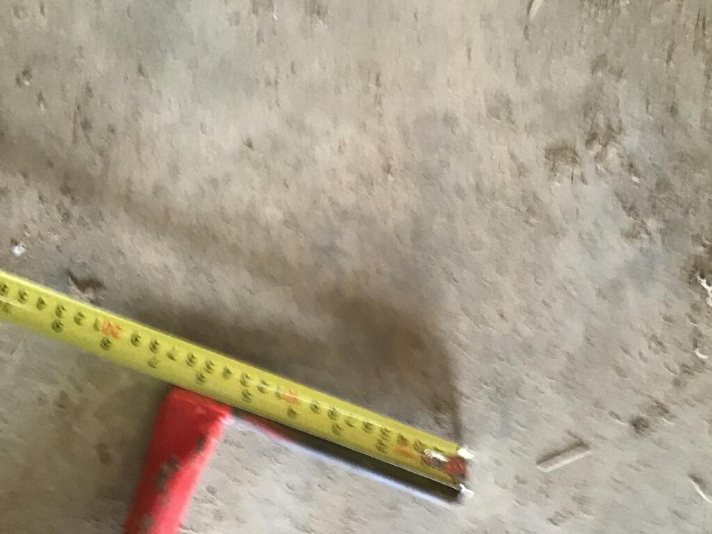

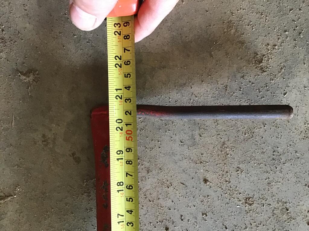

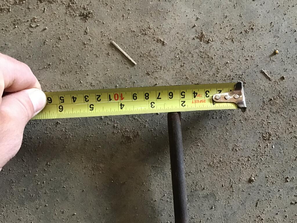

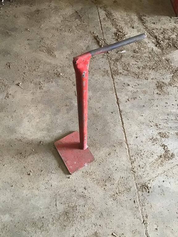

cpic1 0 #1 Posted May 23, 2020 Hi, does anyone know where I can get the specs for the parking stands for the ark 97-40FL01 or pics Share this post Link to post Share on other sites

Pullstart 71,102 #5 Posted May 28, 2020 Do these help? 20-1/2” bottom of stand to center of 7/16” pins. Pins are sticking out 5-1/8”. Bases are about 4-1/2”x6”. Share this post Link to post Share on other sites
