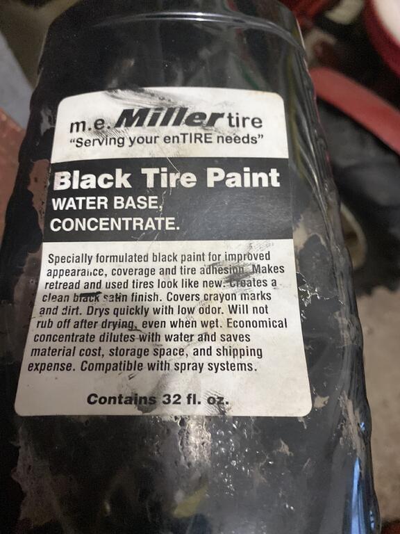

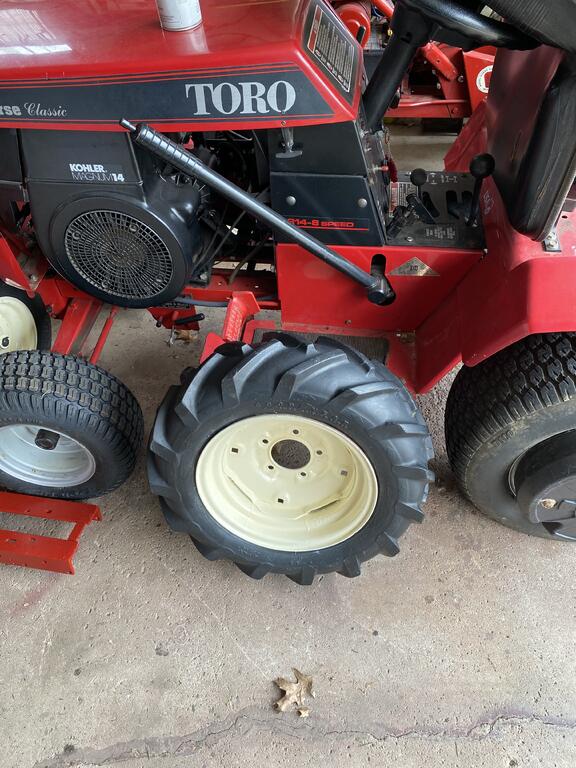

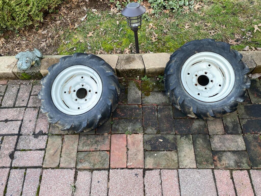

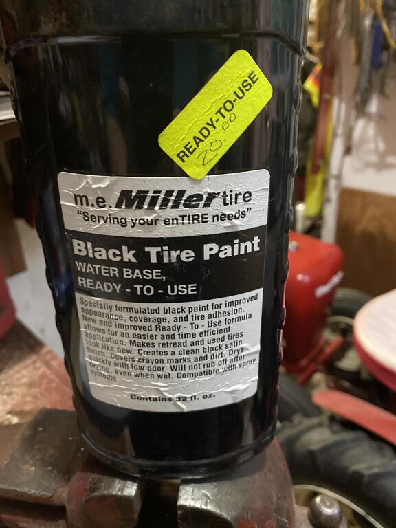

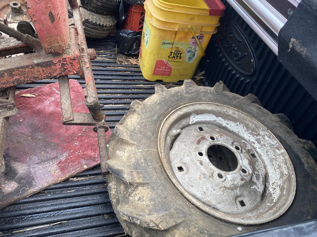

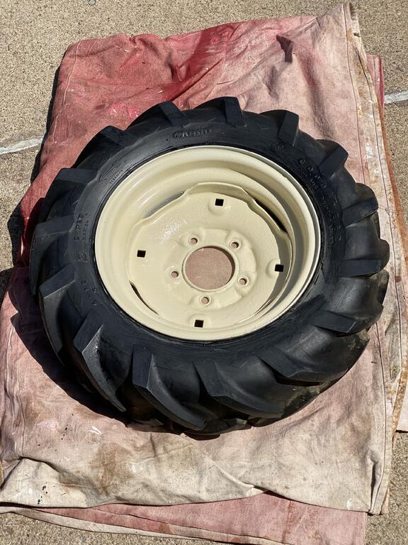

Lane Ranger 12,159 #1 Posted May 21, 2020 I have been using the M.E. Miller black tire paint (can be purchased from M.E. Miller) for over ten years now. When you have a good set of old Wheel Horse tires but they are still worth using you can use this Miller black tire paint to make them almost better looking than new! I have had a bottle of concentrated black (which they no longer sell) for ten years. I have used a couple dollops in a cottage cheese container with a few tablespoons of water on over forty tires. I have also given away several containers for people to use on redos. The proof is in the pudding folks. It works. A new bottle of the paint is $20 but well worth it. I posted picture of a dirty old rear Good Year tire from an RJ I bought and repainted twice for illustration of the outcome of painting with Miller Black Tire Paint. 3 8 1 Share this post Link to post Share on other sites
