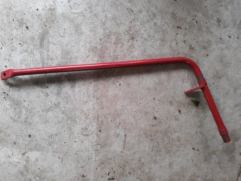

Fred's Red Shed 2 #1 Posted May 21, 2020 (edited) I recently purchased a 36" tiller and the arm that is pictured was included. Can anyone tell me what this arm is for? It is not in the tiller manuals. I am missing the underseat lift arm that is shown in the manuals, so I wonder if this is some replacement for it, but I don't see how. Edited May 21, 2020 by Fred's Red Shed 1 Share this post Link to post Share on other sites
Stepney 2,356 #2 Posted May 21, 2020 Looks like a snowblower crank support to me.. but I'm not sure, never had a newer blower. 1 Share this post Link to post Share on other sites
lynnmor 9,051 #3 Posted May 21, 2020 11 minutes ago, Stepney said: Looks like a snowblower crank support to me.. but I'm not sure, never had a newer blower. Yep, that's it. Used on the single stage units. 1 Share this post Link to post Share on other sites
WHX?? 58,307 #4 Posted May 21, 2020 Fred Yup somewhere out there there is a snow blower running around without it's crank support arm. Has nothing to do with a tiller. Please don't toss it out but try and sell it in classifieds, sure another member could use it. Maybe the seller needs it back ??? Sounds like you need the rear rock shaft kit? They were an option for any 3,4, 500 and other older series tractors. What tractor are you putting it on? Call this guy he would have what you need to fit it up. https://wheelhorsepartsandmore.com/hitches-liftkits.html#!/Hitches-&-Rock-Shaft-Kits/c/23548047/offset=10&sort=normal 1 Share this post Link to post Share on other sites
Fred's Red Shed 2 #5 Posted May 21, 2020 59 minutes ago, WHX24 said: Fred Yup somewhere out there there is a snow blower running around without it's crank support arm. Has nothing to do with a tiller. Please don't toss it out but try and sell it in classifieds, sure another member could use it. Maybe the seller needs it back ??? Sounds like you need the rear rock shaft kit? They were an option for any 3,4, 500 and other older series tractors. What tractor are you putting it on? Call this guy he would have what you need to fit it up. https://wheelhorsepartsandmore.com/hitches-liftkits.html#!/Hitches-&-Rock-Shaft-Kits/c/23548047/offset=10&sort=normal Thanks for the info. I have a 416H. The seller of the rototiller did have a snowblower and he did not know what he was dealing with. 1 Share this post Link to post Share on other sites
