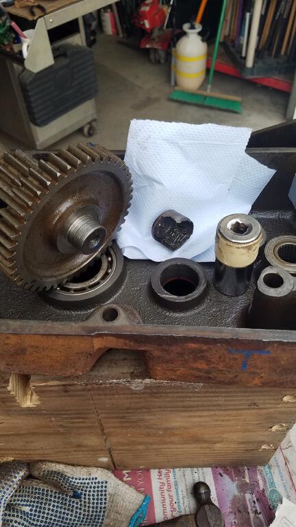

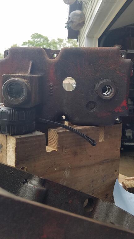

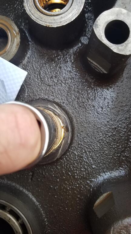

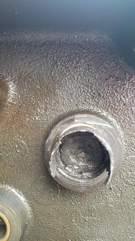

Rsr6932 3 #1 Posted May 21, 2020 Frist time in a WH Transmission My 5053 or a 5025 3 speed trans has wore a cap bearing in half and damage the right side case (3900) and the 44 teeth gear shaft/brake shaft. So Rebuild or replace whole trans. I need the parts or transmission Share this post Link to post Share on other sites

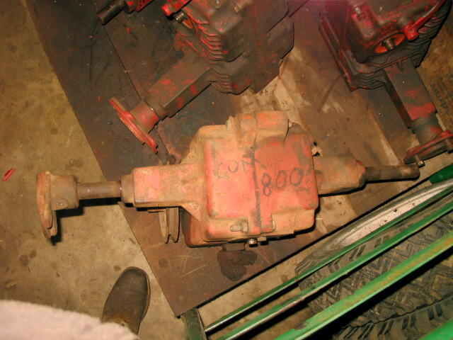

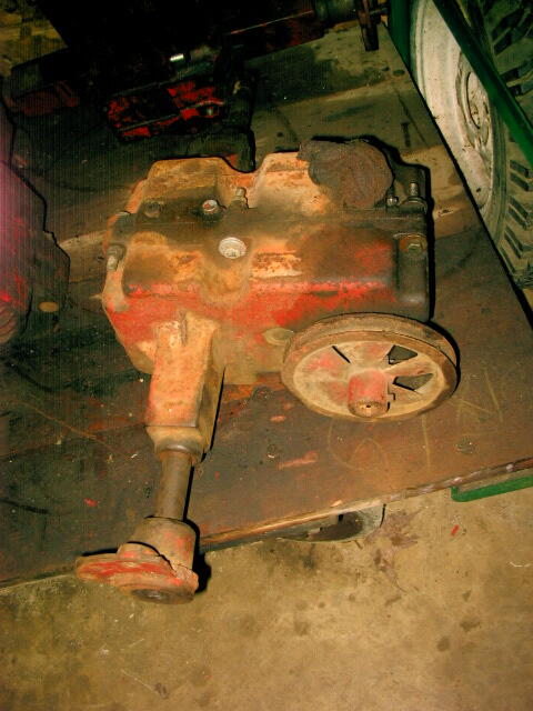

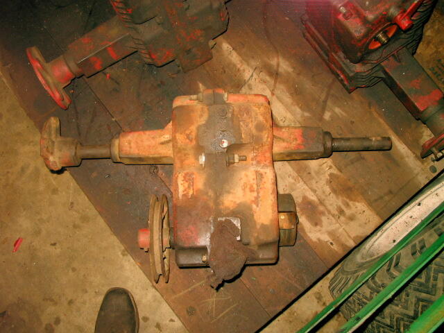

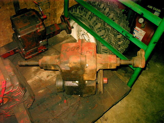

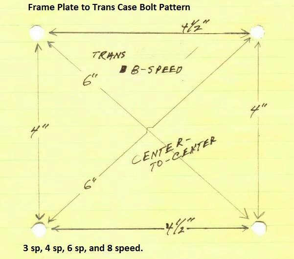

daveoman1966 3,884 #2 Posted May 21, 2020 I have a 5085 gearbox.... from an Commado 800. 1972 Model # 1-0110 and fits these others: NOTE... the 4-bolt pattern is the same on these... I've never opened it up but all the gears work and it has been INSIDE for 20+ years. Too heavy to ship but can be picked up at my shop in n/w PA zip 16433. About 40 Miles south of Lake Erie. Bring a Grant, a Jackson, and one Lincoln with you. 1-0110 1972 Commando 800 4-Speed 1-0120 1973 8 hp 4 Speed 4-Speed 1-0130 1973 Commando 800 4-Speed 1-0352 1974 Raider 12 4-Speed Share this post Link to post Share on other sites
stevasaurus 23,861 #3 Posted May 21, 2020 @daveoman1966 Robin has the #5053 3 speed. The case halves are the same, but he also wants to change out the 11/44 tooth gear. Robin's 11/44 tooth gear has the brake drum on it. Your brake drum is on the cluster gear shaft. He could bolt in the 4 speed, but then he would have to modify the brake linkage. Share this post Link to post Share on other sites
daveoman1966 3,884 #4 Posted May 21, 2020 Thank you stevasaurus... good info for all. I was only sure that the bolt-up pattern was the same on these...not sure about the linkages. Hopefully the 'newbie' finds this informative as well. My email is: daveoman@windstream.net... should anyone want to contact me outside of RS 1 Share this post Link to post Share on other sites
stevasaurus 23,861 #5 Posted May 21, 2020 Robin and I were on the phone yesterday for quite a while...he sent me some pictures so I was able to verify what he has there. The horse is a 657. Share this post Link to post Share on other sites
