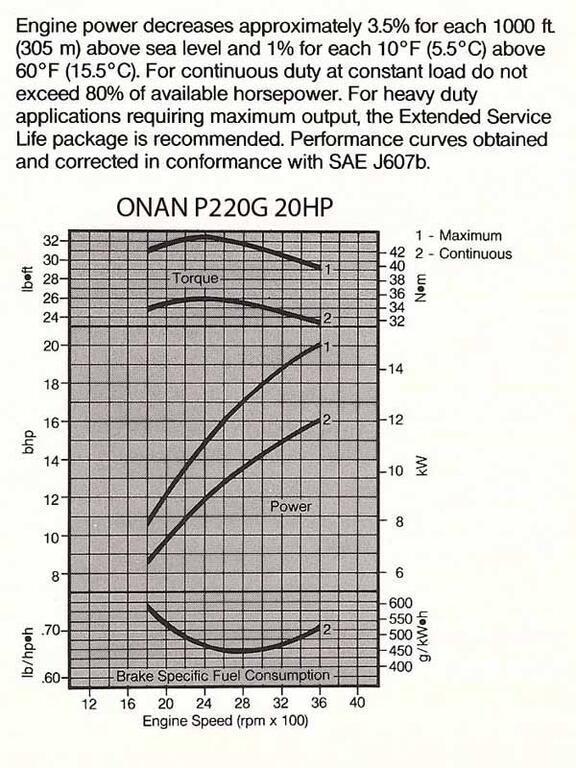

Flat Thunder Channel 178 #17 Posted February 4, 2021 Does anyone have horsepower torque curves for a 20 HP Onan? Curious how the power output compares to a factory Onan. Share this post Link to post Share on other sites
littleredrider 409 #18 Posted February 4, 2021 There will be no comparison!!! That motor is gonna make horsepower n torque everywhere over the Onan.... Share this post Link to post Share on other sites

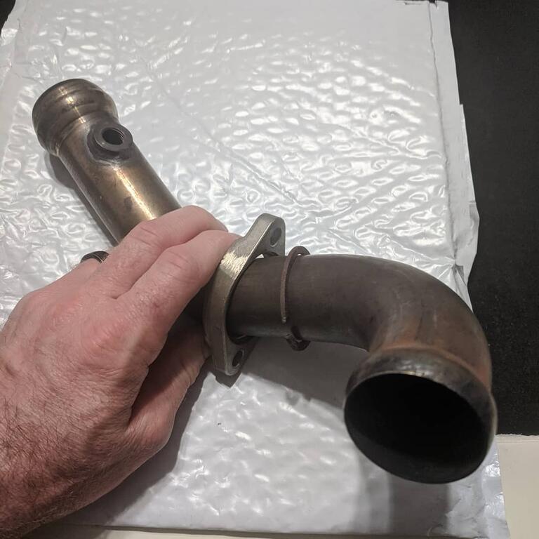

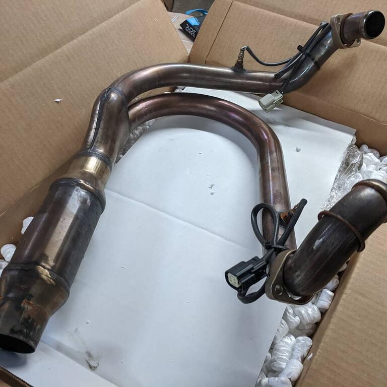

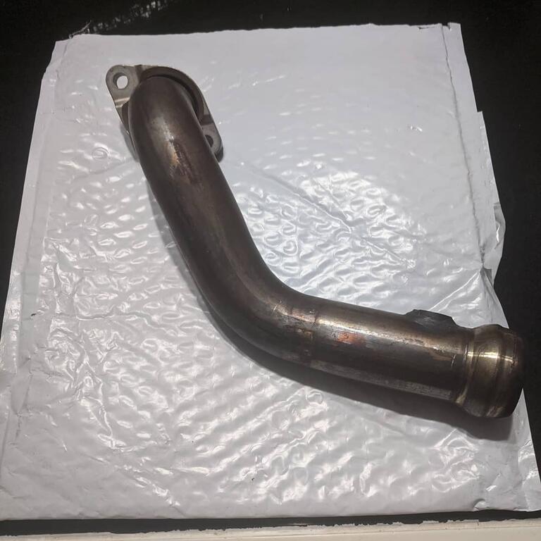

Flat Thunder Channel 178 #20 Posted February 4, 2021 I will add them in as it progresses 😁. Just recently found a power unit. Some of the bits and pieces are arriving. Have yet to locate the best donor tractor. Might be a GT workhorse series tractor dad has in the shop. Not sure yet on the full design and direction. Building the tractor around the engine per say...... A section of my header pipe arrived yesterday. I know it's not overly exciting, but it's pictures 😉 3 Share this post Link to post Share on other sites

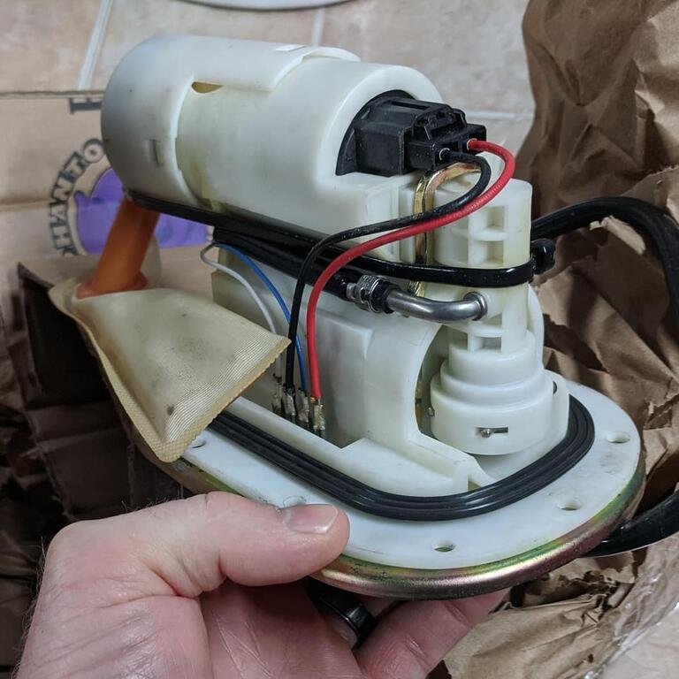

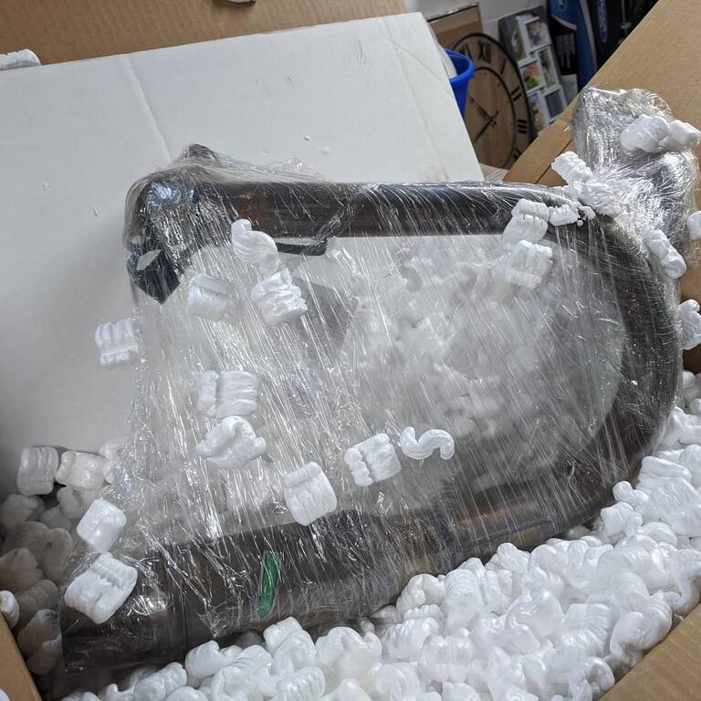

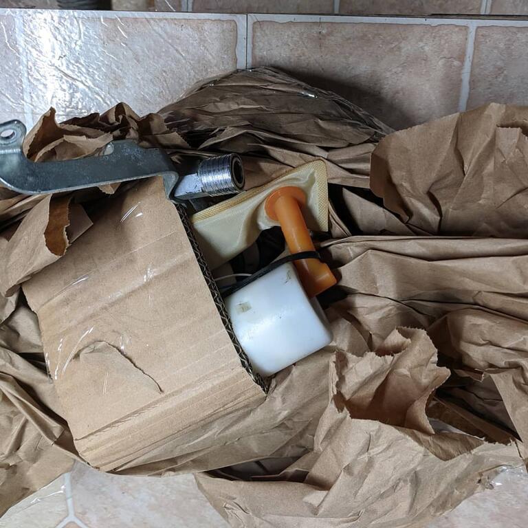

Flat Thunder Channel 178 #23 Posted February 5, 2021 More pieces and parts of the puzzle..... Not for sure how I am going to use the remote control submarine, but it looks fun 1 1 Share this post Link to post Share on other sites
Lee1977 7,807 #24 Posted February 5, 2021 On 2/3/2021 at 11:30 PM, Flat Thunder Channel said: Does anyone have horsepower torque curves for a 20 HP Onan? Curious how the power output compares to a factory Onan. 20 HP Onan put out 31.4 ft/pounds of torque. Don't know what the power curve looks like. 1 Share this post Link to post Share on other sites
Flat Thunder Channel 178 #25 Posted February 5, 2021 (edited) 3 hours ago, Lee1977 said: 20 HP Onan put out 31.4 ft/pounds of torque. Don't know what the power curve looks like. I found something in my searches. Not sure of it's accuracy???? It has to be right since I saw it on the internet. Right!? Edited February 5, 2021 by Flat Thunder Channel 1 Share this post Link to post Share on other sites
