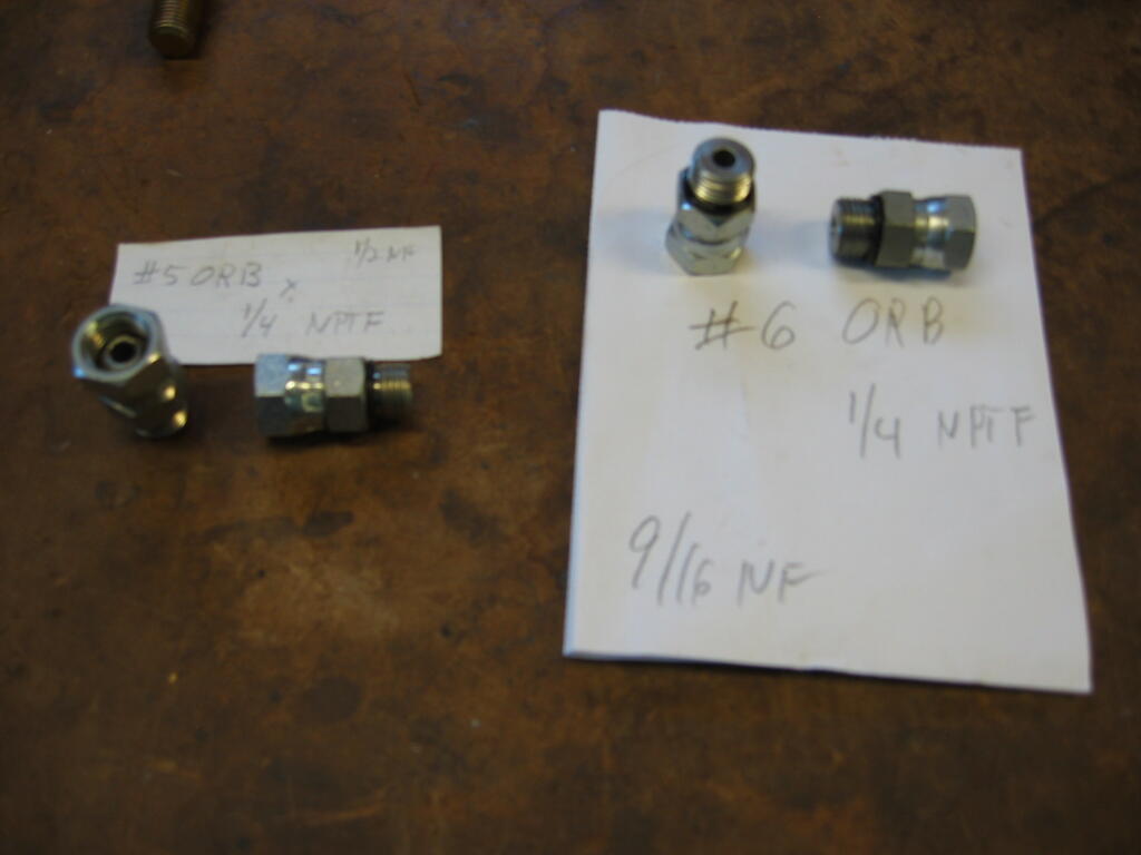

pfrederi 21,312 #7 Posted May 21, 2020 (edited) WH used two sizes or ORB fittings over time. ORB #5 and #6. They are straight threads. if the cylinder hole is 1/2" NF it is ORB5 if it is Threaded 9/16 NF it is ORB#6 You are going to want swivel fittings like these Any hydro place will have the ORB 6 to 1/4"NPTF ORB 5 his out of favor and hard to find. Edited May 21, 2020 by pfrederi 1 1 Share this post Link to post Share on other sites

pfrederi 21,312 #11 Posted May 21, 2020 You will need to see which size your cylinder uses. A hydro place will likely have #6 not so sure about #5 Share this post Link to post Share on other sites

littleredrider 409 #13 Posted May 21, 2020 I could take the cylinder down and match it up, rather than second guessing. It looks small, like 1/2", but if most common is #6, which is 9/16". good thing have the next 2 work days off lol... Share this post Link to post Share on other sites
pfrederi 21,312 #14 Posted May 21, 2020 If it turns out to be a #5 I can help you. I bought some extra a few years ago when they started to disappear. Share this post Link to post Share on other sites
