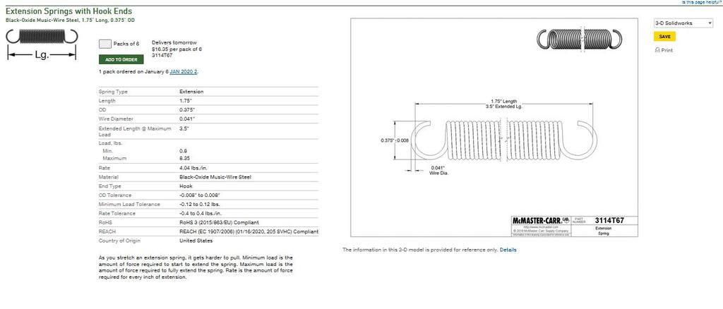

pfrederi 21,274 #4 Posted May 20, 2020 1230 was used on many Sunstrand WHs. and is NLA. I use done of these on my GT14 Is a PIA to install. 1 Share this post Link to post Share on other sites
