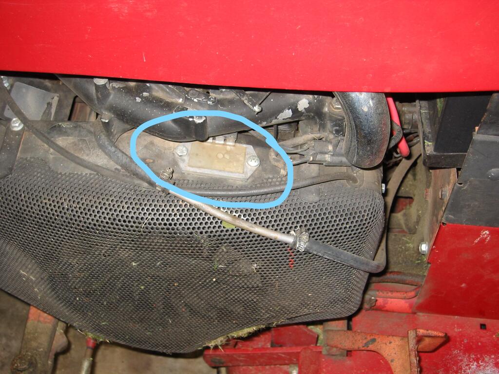

BBELL94 25 #13 Posted May 29, 2020 On 5/19/2020 at 9:21 PM, Achto said: This indicates that the charging system is not working. Unplug the voltage regulator / rectifier. Start the engine & check for AC voltage between the two outside wires, it should be 30+ volts AC at 3/4 throttle or above. Check the center wire to ground, this should have battery DC voltage. If this checks out, make sure that the body of the reg/rec has a good ground and that all of the terminals are clean and getting a good connection. If all of this checks out, then replace the reg/rec. Where is the regulator or rectifier on this tractor? Share this post Link to post Share on other sites
pfrederi 21,300 #14 Posted May 29, 2020 Regulator Top of engine in blue. What voltage do you have with engine running??? 2 Share this post Link to post Share on other sites
BBELL94 25 #15 Posted May 29, 2020 11 minutes ago, pfrederi said: Regulator Top of engine in blue. What voltage do you have with engine running??? Found it. Thank you sir, and when I try to check the voltage running it's nowhere near 12 volts it's less than 1 volt and eventually the tractor will shut off after about 30 seconds. I dont know if my multimeter is screwed up or if the voltage is actually that low Share this post Link to post Share on other sites

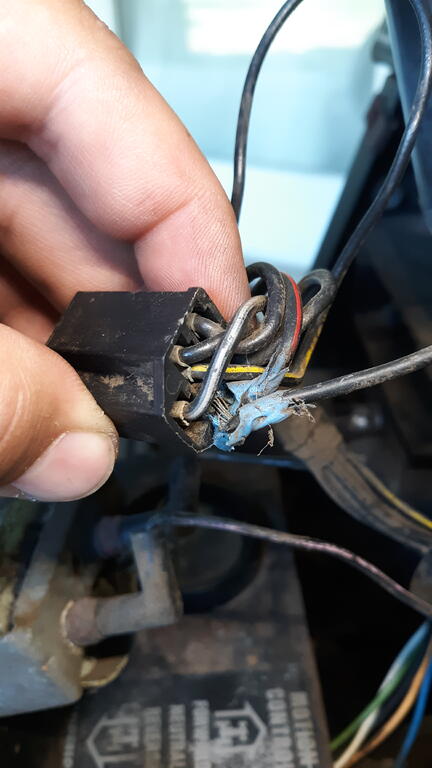

BBELL94 25 #17 Posted May 29, 2020 (edited) 1 hour ago, kasey54 said: BBELL94 Here is what I would do; Remove and charge that battery 100 percent with a charger that indicates when full. Put it back in tractor and make sure wires are clean and tight. Test voltage at battery now. Start tractor and test voltage immediately.;; Voltage should be higher than when not running. Not much but higher. If it isnt then come back here and get a plan to start checking other things. You have to start somewhere. Think I just found the issue. Broken wire on the ignition. But now how in the heck do I fix a a broken wire that close to the plug? Edited May 29, 2020 by BBELL94 1 Share this post Link to post Share on other sites

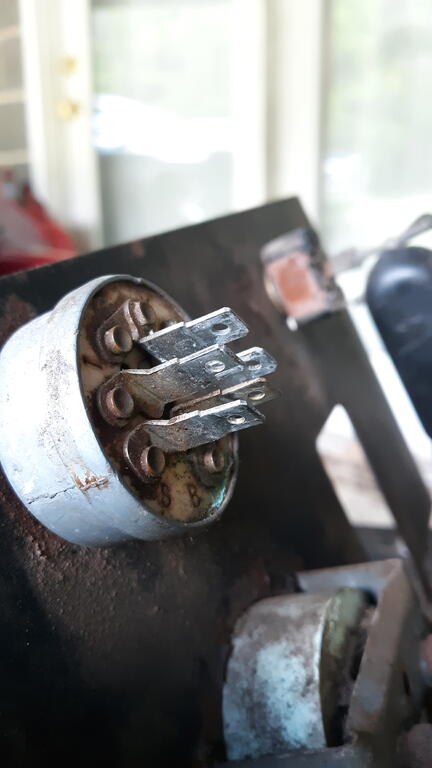

kasey54 305 #18 Posted May 29, 2020 Looks like a considerable amount of corrosion on the rest of those terminals also. How are the terminals on the switch itself? Share this post Link to post Share on other sites
BBELL94 25 #19 Posted May 29, 2020 2 minutes ago, kasey54 said: Looks like a considerable amount of corrosion on the rest of those terminals also. How are the terminals on the switch itself? They are all tight and not too bad as far as corrosion goes. Nothing a little scotch brite wont fix. How do you replace those broken off corroded terminals? Do they come out of the plastic plug? Share this post Link to post Share on other sites
lynnmor 9,073 #20 Posted May 29, 2020 I think NAPA might have a replacement pigtail just cut and splice it in. 1 Share this post Link to post Share on other sites
kasey54 305 #21 Posted May 29, 2020 I'm noticing black on the backer board of that switch that indicates heat, and poor connection of the terminals and the rivets. It should be replaced. Obviously that whole plug should be replace as well. Share this post Link to post Share on other sites
kasey54 305 #22 Posted May 29, 2020 I agree with lynnmor 100 % . Share this post Link to post Share on other sites
kasey54 305 #23 Posted May 29, 2020 You can easily remove the switch and take it with you to NAPA and match your plug leaving you wires in tack until your ready to splice the new one in. Share this post Link to post Share on other sites
kasey54 305 #24 Posted May 29, 2020 I have in a pinch for the sake of testing/time cut each wire from the plug one to a time and crimped a single slide on spade terminal to each wire until I could get a new plug. Share this post Link to post Share on other sites
953 nut 70,318 #25 Posted May 29, 2020 2 hours ago, BBELL94 said: Broken wire on the ignition. But now how in the heck do I fix a a broken wire that close to the plug? You can buy some Delphi Packard GM 56 series connectors at any good auto parts store. The bad connector can be removed from the plug body with a small screwdriver under the lock tab. You will need the female connector. 1 Share this post Link to post Share on other sites
