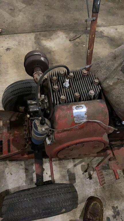

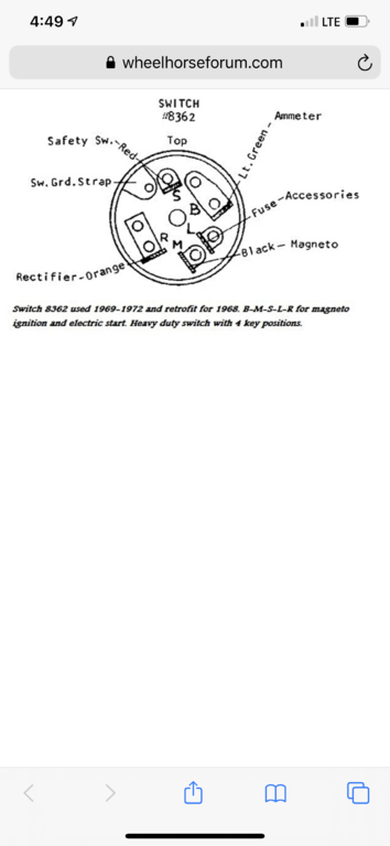

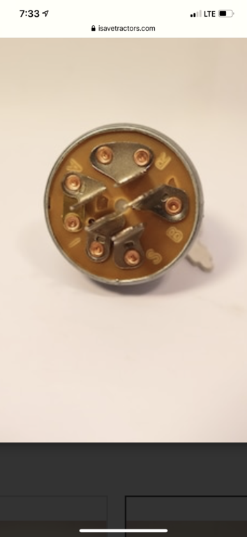

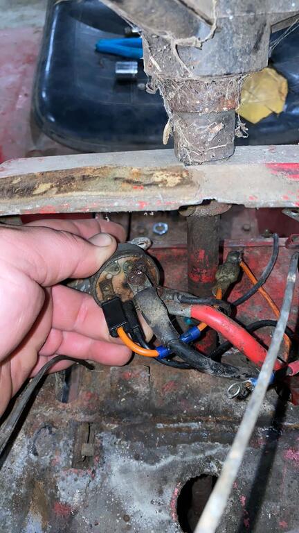

Whguy46041 10 #1 Posted May 19, 2020 I’m currently restoring my 69 charger. I’m replacing the ignition switch and I have a couple of questions. I have the 8362 switch but it was wired with the positive battery cable on the Ammeter terminal, ground strap was wired to safety switch, Retcifier and magneto wire was wired correctly and the ignition wire was on the accessories. I ordered a switch from isavetractors.com because I was told I have a battery ignition. I’ve looked at the wiring schematic on here for the ignition switch but my question is where does the wire from the coil to the ignition switch actually go? Also I will lost a picture of the switch I ordered. I can’t really tell if it will work or not to be completely honest. Any help would be appreciated. Share this post Link to post Share on other sites
rjg854 12,634 #2 Posted May 19, 2020 If you have a magneto, then you have the wrong switch Share this post Link to post Share on other sites

gwest_ca-(File Mod) 11,849 #4 Posted May 20, 2020 Looks like the new switch is this one and it requires a starter solenoid. Do you have one? 1 Share this post Link to post Share on other sites
953 nut 63,067 #5 Posted May 20, 2020 Using the 103 990 switch you will need a soleniod and can use this drawing as a reference. 1 Share this post Link to post Share on other sites
Whguy46041 10 #6 Posted May 20, 2020 27 minutes ago, gwest_ca said: Looks like the new switch is this one and it requires a starter solenoid. Do you have one? I do not have a solenoid. I just looked one up but they were all universal. 14 minutes ago, 953 nut said: Using the 103 990 switch you will need a soleniod and can use this drawing as a reference. Where can I pick up a solenoid ? Is there a certain one I need to get? Share this post Link to post Share on other sites
953 nut 63,067 #7 Posted May 20, 2020 3 minutes ago, Whguy46041 said: do not have a solenoid. I just looked one up but they were all universal. That is all you need. Share this post Link to post Share on other sites
D_Ram 17 #8 Posted July 2, 2020 On 5/19/2020 at 6:45 PM, Whguy46041 said: I was told I didn’t have magneto because of the coil wire going to the spark plug. I’m trying to confirm that as well. Magneto system still has a coil wire (secondary cable) to spark plug, a magneto system will not have the external coil as seen in your pics. Share this post Link to post Share on other sites
