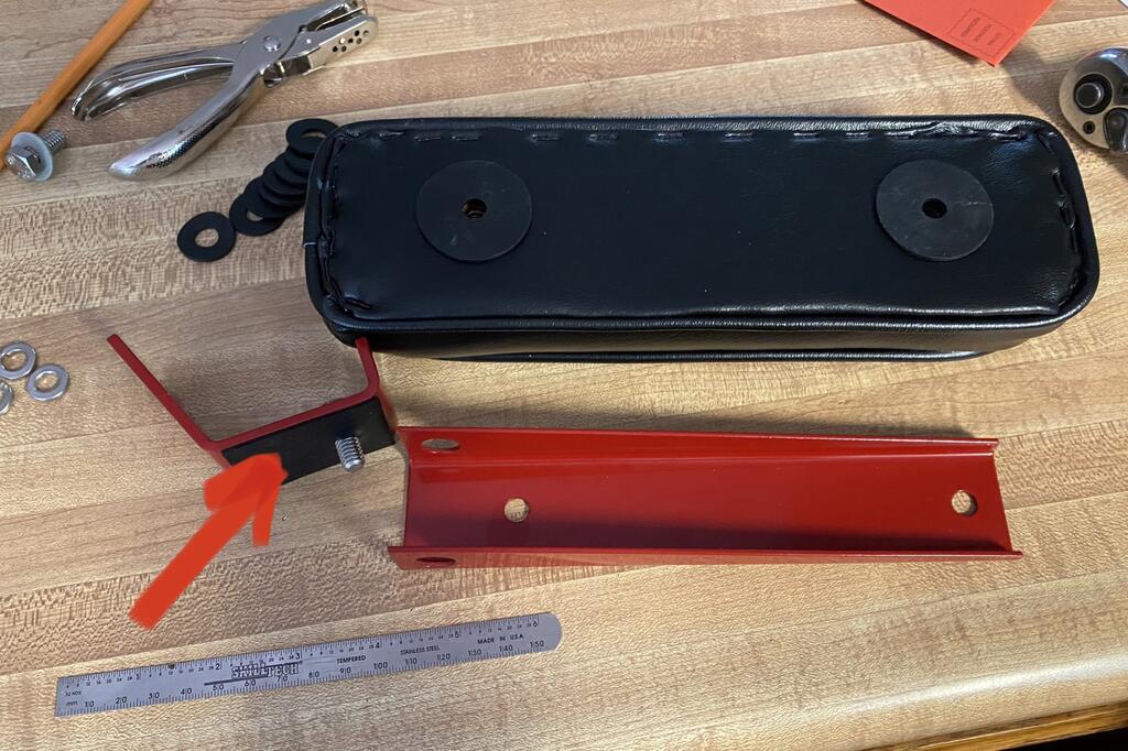

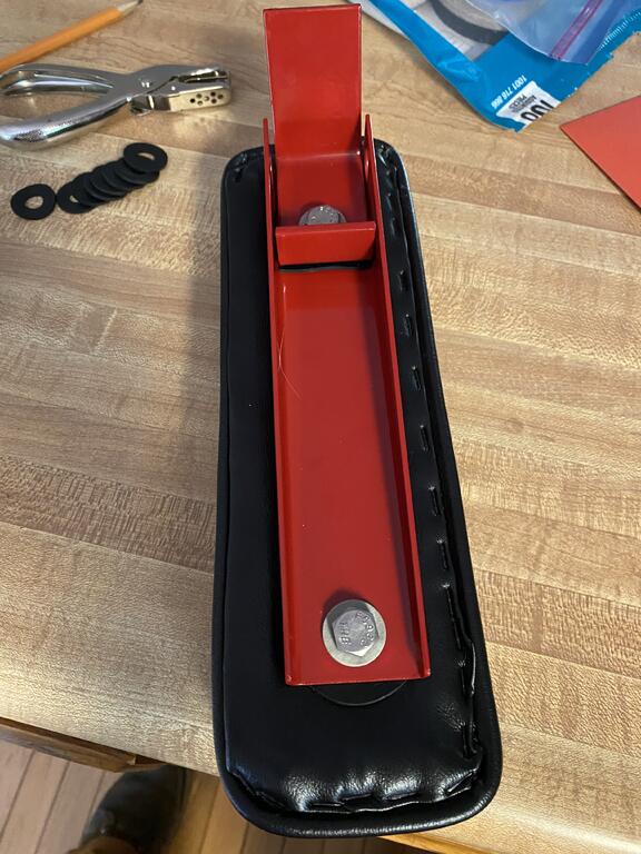

55reasons 171 #177 Posted June 21, 2020 (edited) On to the arm rests. I cut some pads out of 2mm silicone I keep around to keep the powdercoat from rubbing together, etc. Also added some rubber fender washers to go under the arm rest vinyl to cut down an abrasion as well. Because I made the new arm rests out of oak, I was able to apply red loctite and really torque them down. Edited June 21, 2020 by 55reasons 1 3 Share this post Link to post Share on other sites

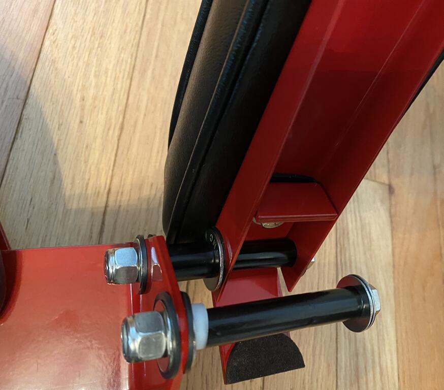

55reasons 171 #179 Posted June 22, 2020 In my opinion, this is how the armrest hardware should have been done originally anyway: 2 Share this post Link to post Share on other sites

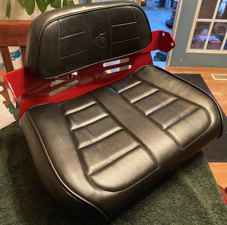

55reasons 171 #180 Posted June 22, 2020 Anyway, the seat is done. Toro dealer called this AM and said the seat rubber baby buggy bumpers have arrived. We’ll see if they’re even close to the right part. 3 Share this post Link to post Share on other sites

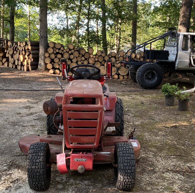

55reasons 171 #184 Posted June 24, 2020 She’s a different animal now that there’s a seat to sit on. Resting after a hard days work... 3 Share this post Link to post Share on other sites
ebinmaine 80,465 #185 Posted June 24, 2020 Is it a tad bit loud with that little pepper pot muffler? Share this post Link to post Share on other sites
55reasons 171 #186 Posted June 24, 2020 1 hour ago, ebinmaine said: Is it a tad bit loud with that little pepper pot muffler? A tad. Not terrible though. I have an idea for an exhaust, but that will come later when I find the magic piece. 1 Share this post Link to post Share on other sites
