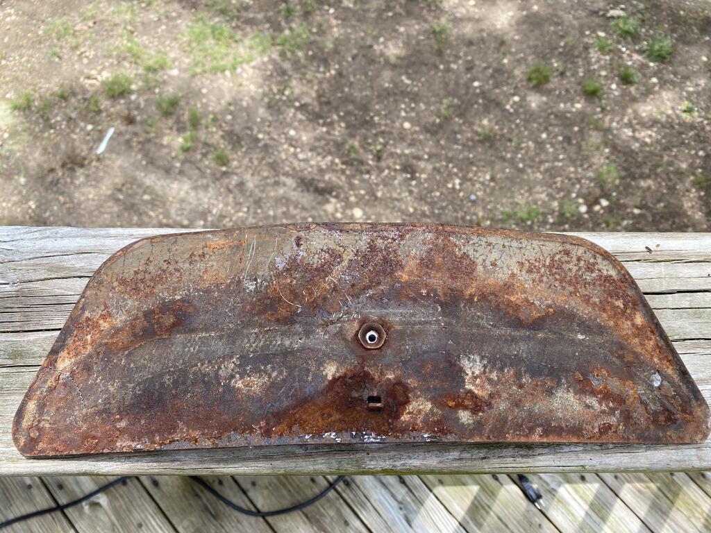

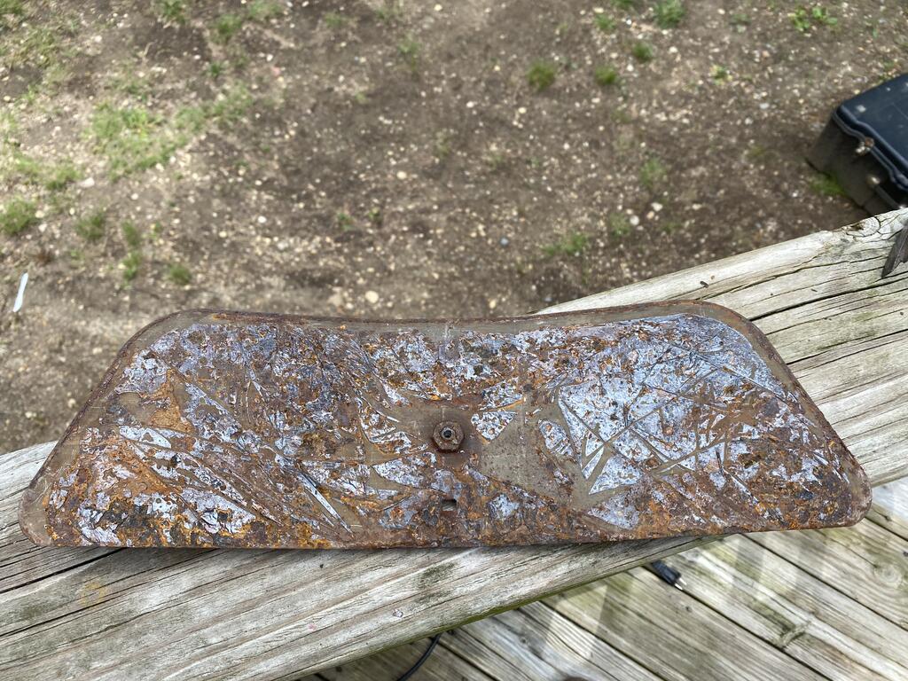

55reasons 171 #60 Posted May 23, 2020 The seat back adjustment knob bolt snapped off some time back. Before I drill and re-tap, can anyone confirm the size and pitch so if I ever find a knob some day it will work? Share this post Link to post Share on other sites

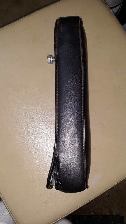

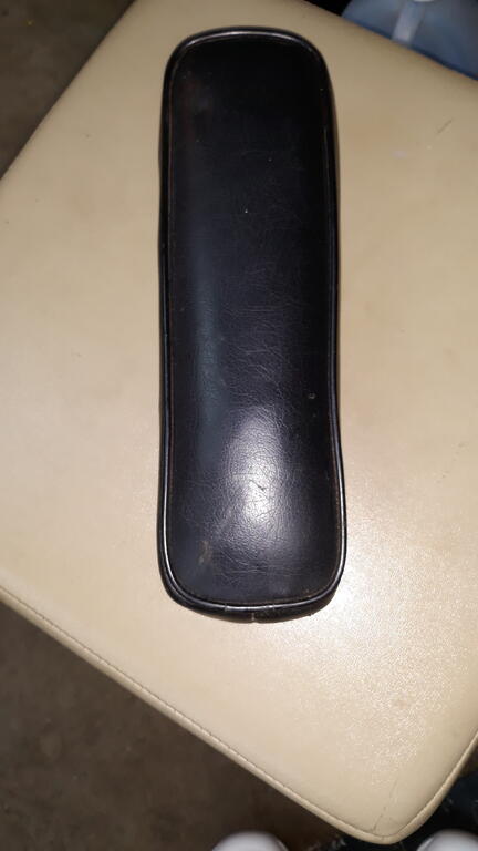

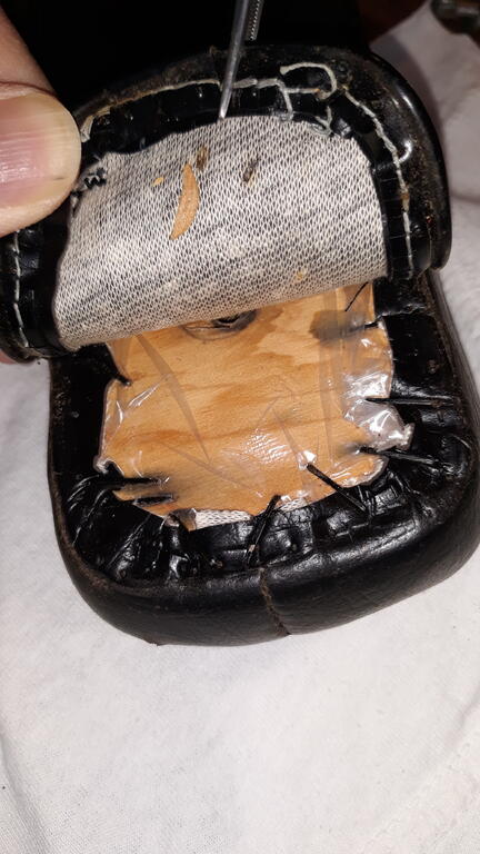

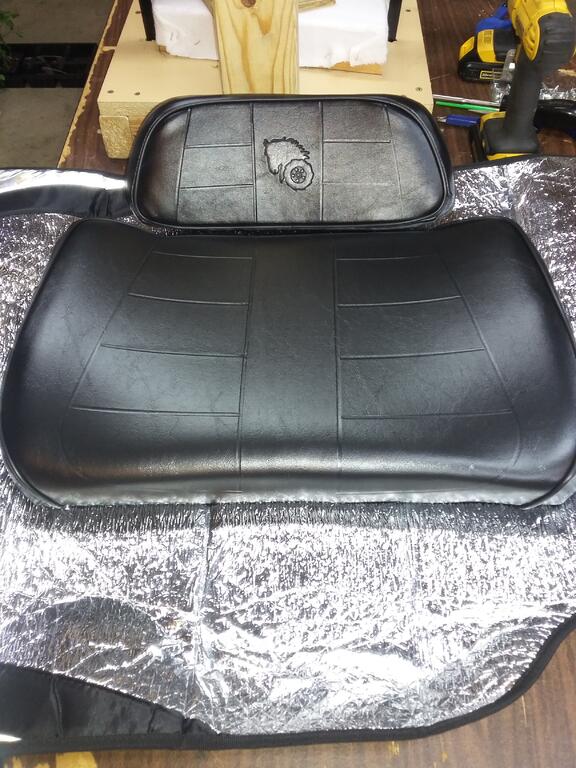

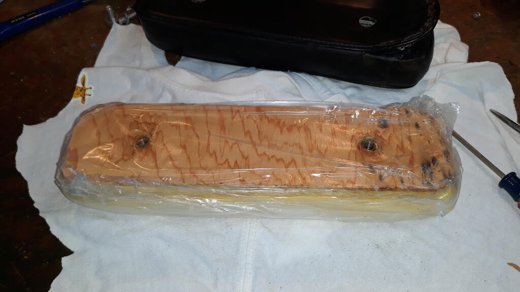

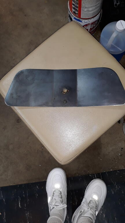

BOB ELLISON 2,983 #63 Posted May 23, 2020 6 hours ago, 55reasons said: The seat back adjustment knob bolt snapped off some time back. Before I drill and re-tap, can anyone confirm the size and pitch so if I ever find a knob some day it will work? This is the back metal plate that the foam and vinyl go on. The seat also has a metal plate with foam and vinyl. This is a new plate that I use to make that seat. That nob that screws in the back is a 5/16 thread. The arm rests are rear and hard to find. I'm thinking of duplicating the armrests . 5 Share this post Link to post Share on other sites

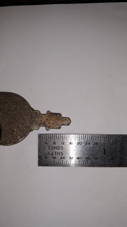

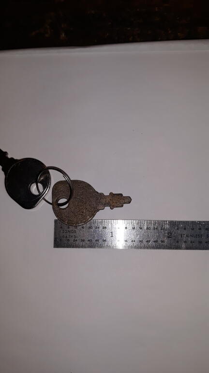

BOB ELLISON 2,983 #64 Posted May 23, 2020 The key is easy to duplicate. I keep extra keys just for such occasions. Grandchildren 3 Share this post Link to post Share on other sites

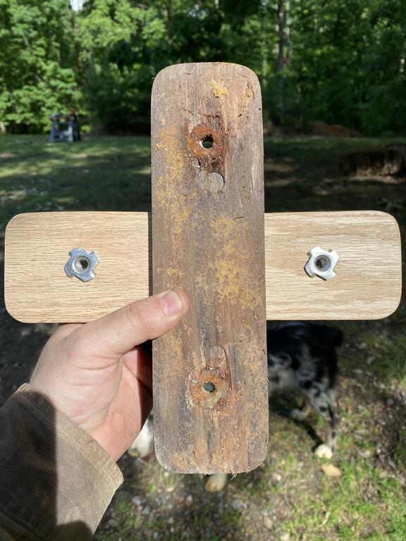

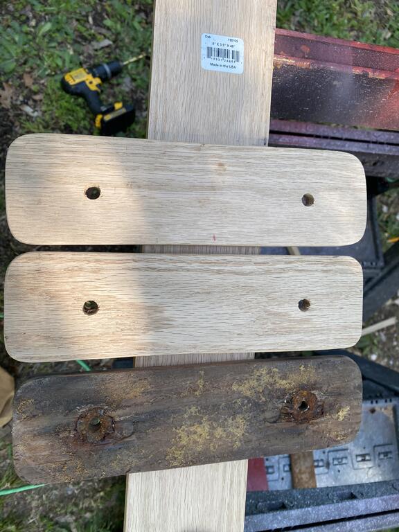

55reasons 171 #65 Posted May 23, 2020 26 minutes ago, BOB ELLISON said: This is the back metal plate that the foam and vinyl go on. The seat also has a metal plate with foam and vinyl. This is a new plate that I use to make that seat. That nob that screws in the back is a 5/16 thread. The arm rests are rear and hard to find. I'm thinking of duplicating the armrests . 5/16 ? Thank you. 18 or 24 thread? I’m just going to bead blast and powdercoat my seat back, but I wanted to re-tap it first. I made new arm rests already. Pulled out the 3/8 plywood and made new ones out of 1/2 oak. Coating it with Spar Urethane to keep the moisture at bay. Installed stainless steel inserts instead of regular steel so they won’t rust from the inside. Just waiting on 1/8 piping to reconstruct the arm rest vinyl itself. 1 Share this post Link to post Share on other sites

BOB ELLISON 2,983 #68 Posted May 24, 2020 5/16x18 standard thread. 1 Share this post Link to post Share on other sites

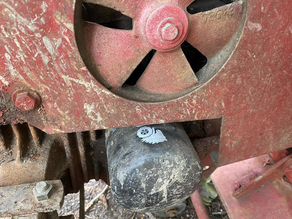

55reasons 171 #71 Posted May 24, 2020 Scenario A: Wheel Horse branded filters are sill available. Scenario B: The filter hasn’t been changed in at least 20 years. Share this post Link to post Share on other sites
ebinmaine 81,048 #72 Posted May 24, 2020 Could be NOS. I had a couple here last year I gave a member. Best to get a Wix brand or Napa (which is Wix) if possible, when you change it. 1 Share this post Link to post Share on other sites
55reasons 171 #73 Posted May 24, 2020 Reading the FSM, it would seem that this 74 Auto just takes regular motor oil, so I guess I don’t need to use a hydraulic non-bypass filter eh? Just a standard oil filter will do I assume. 1 Share this post Link to post Share on other sites

BOB ELLISON 2,983 #75 Posted May 24, 2020 1 hour ago, 55reasons said: Reading the FSM, it would seem that this 74 Auto just takes regular motor oil, so I guess I don’t need to use a hydraulic non-bypass filter eh? Just a standard oil filter will do I assume. Dont use a regular oil filter. I use the napa 1410. A regular oil filter is not made the same. 1 Share this post Link to post Share on other sites
