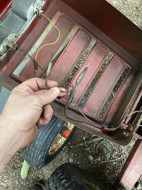

55reasons 171 #27 Posted May 19, 2020 1 hour ago, lynnmor said: That is/was the switch for an electric lift kit. How it found its way on to a hydraulic tractor is a mystery. There is a part number for the decal and here is reference to the kit from a 1975 brochure: here Yeah, what’s REALLY crazy is that it is wired to the hydraulic cylinder. 🧐 1 1 Share this post Link to post Share on other sites

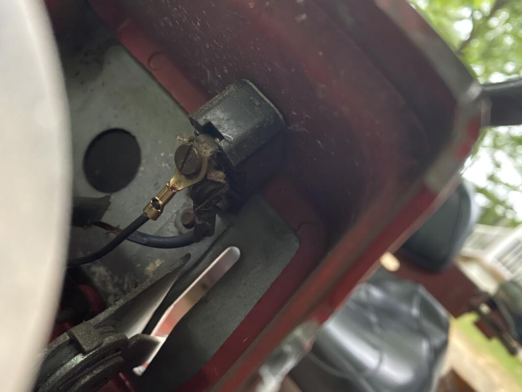

ebinmaine 81,048 #28 Posted May 19, 2020 Just now, 55reasons said: Yeah, what’s REALLY crazy is that it is wired to the hydraulic cylinder. 🧐 I'd like to see close-up pics of that if you can. Share this post Link to post Share on other sites
55reasons 171 #29 Posted May 19, 2020 14 minutes ago, pullstart said: good to hear you have the intention to troubleshoot! those tires look fun, by all means be the trend setter there and let us know how it goes! I recently used a set of headers to build a couple exhaust systems for two tractors. Here are some links to ideas... Rylee’s “Screamin’ Jimmy” “Steve” the C-81 super cool! Share this post Link to post Share on other sites

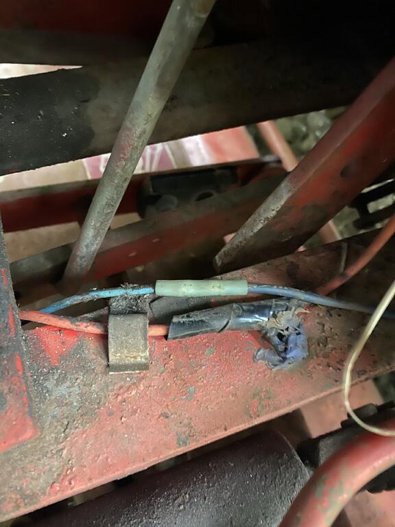

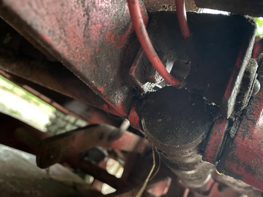

55reasons 171 #30 Posted May 19, 2020 7 minutes ago, ebinmaine said: I'd like to see close-up pics of that if you can. Two wires off the switch. One goes down to either the hydro cylinder or the brake pedal pivot. (Too windy to climb under there at the moment) The other has some splices, but ultimately ends up as a bare end by the headlights. 1 Share this post Link to post Share on other sites
55reasons 171 #31 Posted May 19, 2020 Just now, 55reasons said: Two wires off the switch. One goes down to either the hydro cylinder or the brake pedal pivot. (Too windy to climb under there at the moment) The other has some splices, but ultimately ends up as a bare end by the headlights. 1 Share this post Link to post Share on other sites
ebinmaine 81,048 #32 Posted May 19, 2020 Past modification or repair maybe?? Share this post Link to post Share on other sites

953 nut 70,070 #34 Posted May 19, 2020 18 minutes ago, 55reasons said: Two wires off the switch. You don't have an electric lift or an electric PTO, mu guess is they go to headlights and tail lights. 1 Share this post Link to post Share on other sites
55reasons 171 #35 Posted May 20, 2020 (edited) 49 minutes ago, 953 nut said: You don't have an electric lift or an electric PTO, mu guess is they go to headlights and tail lights. Except the Factory headlight and tail lights work off the existing factory switch, and who would bother getting an electric lift decal to use for an auxiliary circuit? Especially on a tractor that never had a switch there? Do all the hydro tractors have a decal there even without the electric lift? *Edit* The dude was 96. He’s not the kind of guy that goes out and buys Wheel Horse decals on the internet to disguise an accessory circuit. Edited May 20, 2020 by 55reasons 1 Share this post Link to post Share on other sites

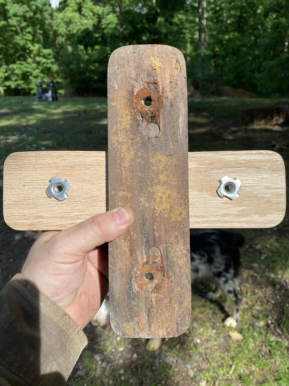

55reasons 171 #36 Posted May 22, 2020 Ok.... Had some time today to do some work on this thing. I blew apart the rear seat so I could fix the vinyl and just throw some rattle can (Regal Red) on it to stop rust from spreading. The arm rests have 3/8 plywood inside them as a base for the foam. Used the old ones as a template and made some new ones out of 1/2” oak. I figure the extra 1/8” wouldn’t hurt since I’m sure the foam has compressed an 1/8” over the years anyway. 5 Share this post Link to post Share on other sites

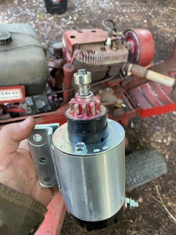

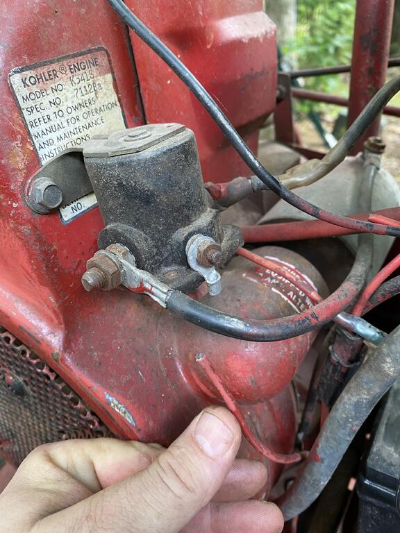

55reasons 171 #38 Posted May 22, 2020 Also, the starter WAS bad. Put in the new starter that came in the mail today from DB Electrical, and still nothing from the key. At least when I jump the solenoid it turns now though. Noticed the (what I hope is the ground) wire from the solenoid was not hooked up. Soldered a new end on it, still nothing. So, now, it’s either the solenoid, or the ignition switch itself. WHERE can I get the MOST CORRECT solenoid and ignition switch? 3 Share this post Link to post Share on other sites
953 nut 70,070 #39 Posted May 22, 2020 The small terminal on your solenoid should go to the clutch safety switch. If you use a small jumper wire from the battery "+" terminal to that terminal the solenoid should close and the starter should operate. The diagram below should be helpful. 1 Share this post Link to post Share on other sites
ebinmaine 81,048 #40 Posted May 22, 2020 Hold onto the old starter. They're rebuildable. That wire to the solenoid is the hot. If you REPAIR THE WIRING YOU MAY FIX THE ISSUE If you need an ignition switch... Check your local parts store and get a GOOD QUALITY name brand ignition switch. The solenoid is easy. Just tell them you need one for a 75 F150 with 3 terminals. Most any old school 3 terminal solenoid will work. Share this post Link to post Share on other sites
55reasons 171 #41 Posted May 22, 2020 17 minutes ago, 953 nut said: The small terminal on your solenoid should go to the clutch safety switch. If you use a small jumper wire from the battery "+" terminal to that terminal the solenoid should close and the starter should operate. The diagram below should be helpful. I appreciate that. may I ask WHERE the clutch safety switch IS located on this, so I can get it wired in properly? Share this post Link to post Share on other sites
55reasons 171 #42 Posted May 22, 2020 16 minutes ago, ebinmaine said: Hold onto the old starter. They're rebuildable. That wire to the solenoid is the hot. If you REPAIR THE WIRING YOU MAY FIX THE ISSUE If you need an ignition switch... Check your local parts store and get a GOOD QUALITY name brand ignition switch. The solenoid is easy. Just tell them you need one for a 75 F150 with 3 terminals. Most any old school 3 terminal solenoid will work. I see a bunch that are close, but I don’t see anything with the proper mounting strap. Share this post Link to post Share on other sites
55reasons 171 #43 Posted May 22, 2020 I guess what I’m asking about the ignition switch is if there is a exact replacement available from Toro, etc... ? Share this post Link to post Share on other sites
55reasons 171 #44 Posted May 22, 2020 To consolidate my questions: 1. Where is the clutch safety switch located on a 74 C-160 Auto. 2. Is there an EXACT replacement part available for the solenoid and ignition switch? Share this post Link to post Share on other sites
ebinmaine 81,048 #45 Posted May 22, 2020 5 minutes ago, 55reasons said: EXACT replacement part Yepp. Toro part number is 103990. Should be available many places online. Just be sure to get an oe, not universal replacement. Jack's has em listed. Likely available on fleabay as well. 1 Share this post Link to post Share on other sites
ebinmaine 81,048 #46 Posted May 22, 2020 24 minutes ago, 55reasons said: I see a bunch that are close, but I don’t see anything with the proper mounting strap. Best if you can bring it to a store and check to be sure the holes line up. Many old 3 terminal solenoids will work. Oh and when you mount it be sure to clean the area to get good ground. 1 Share this post Link to post Share on other sites
gwest_ca-(File Mod) 12,522 #47 Posted May 22, 2020 This is what the neutral switch will look like. Your pto uses the same switch. The speed stick that controls the hydro will active the switch in the neutral position so look at that linkage. The ignition switch is part number 103990 and used for years. Very popular with aftermarket suppliers. Get a mid 70's Ford solenoid from an auto supplier. They look almost identical and heavy duty for this application. Garry 2 Share this post Link to post Share on other sites

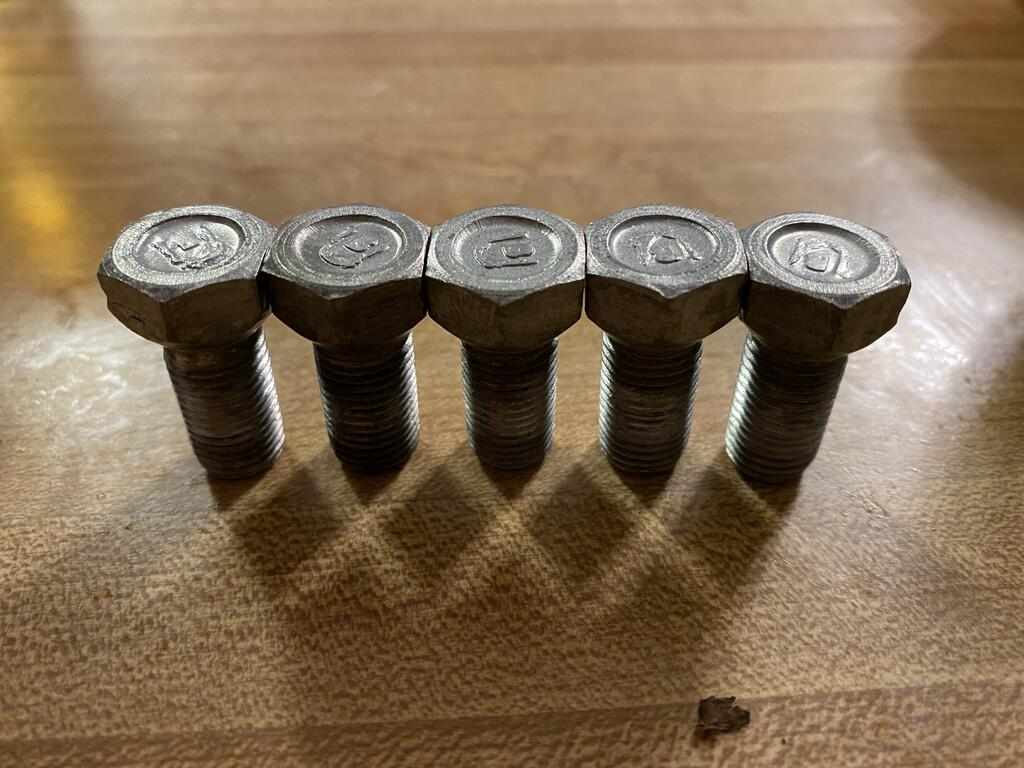

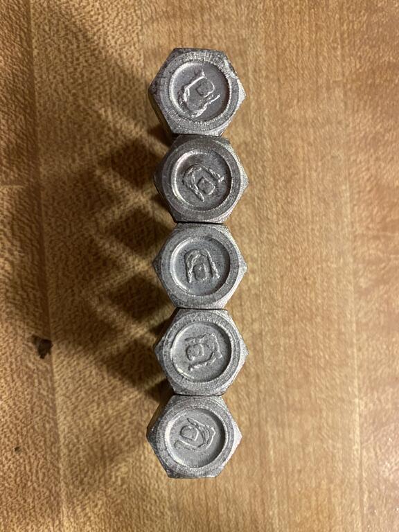

55reasons 171 #50 Posted May 23, 2020 Another question. What do we know about this bolt manufacturer? (These were the rear wheel lug bolts) Nice detail stamped into the bolt heads. I could really use (5) more in this same condition... 1 Share this post Link to post Share on other sites
