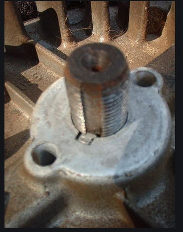

bc.gold 3,406 #6 Posted May 17, 2020 A loose flywheel key, the knock disappears as engine rpm's increase. Engine would sometimes be hard start. Possible cause, if the mower blade struck something hard embedded into the ground or the pto had taken a sudden shock, the key is made from soft material which is meant to shear but often only as shown in image below. Share this post Link to post Share on other sites

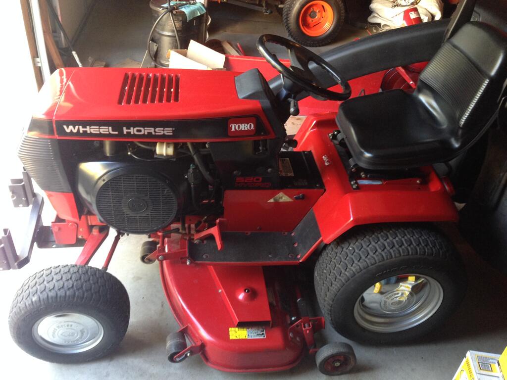

chex313 123 #8 Posted May 17, 2020 Glad you smoothed it out, I am still trying to get over the fact that your 520H only has 290 hours. Share this post Link to post Share on other sites

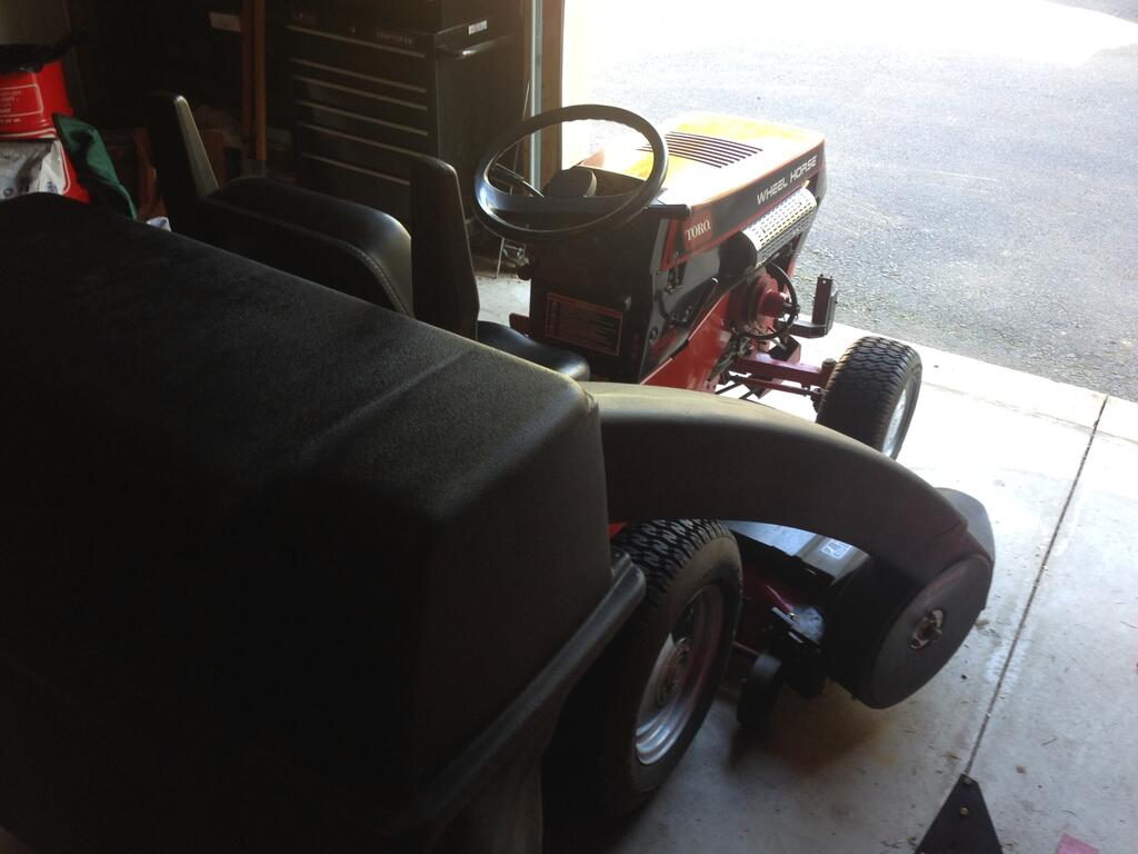

Ike 94 #9 Posted May 17, 2020 (edited) She is pretty clean too! Edited May 17, 2020 by Ike Photos are blurry when I upload them. Share this post Link to post Share on other sites
