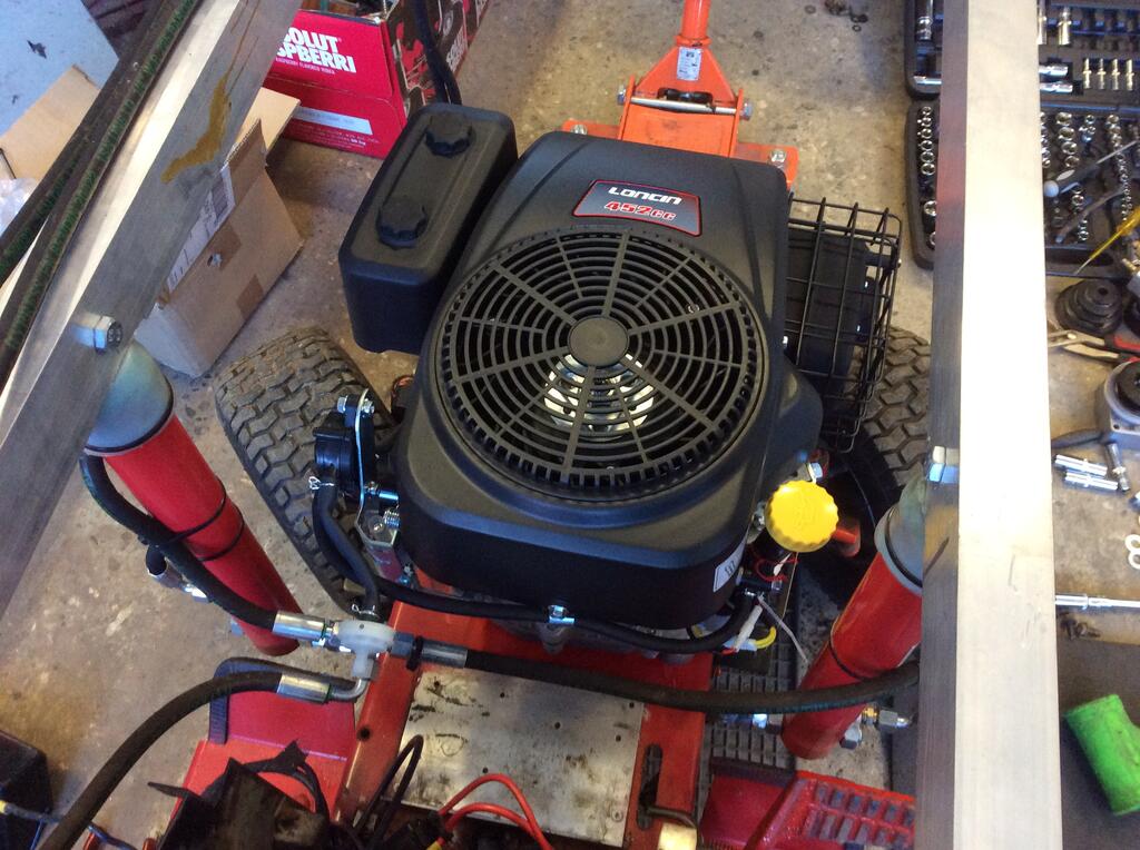

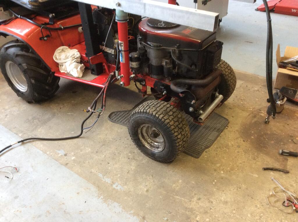

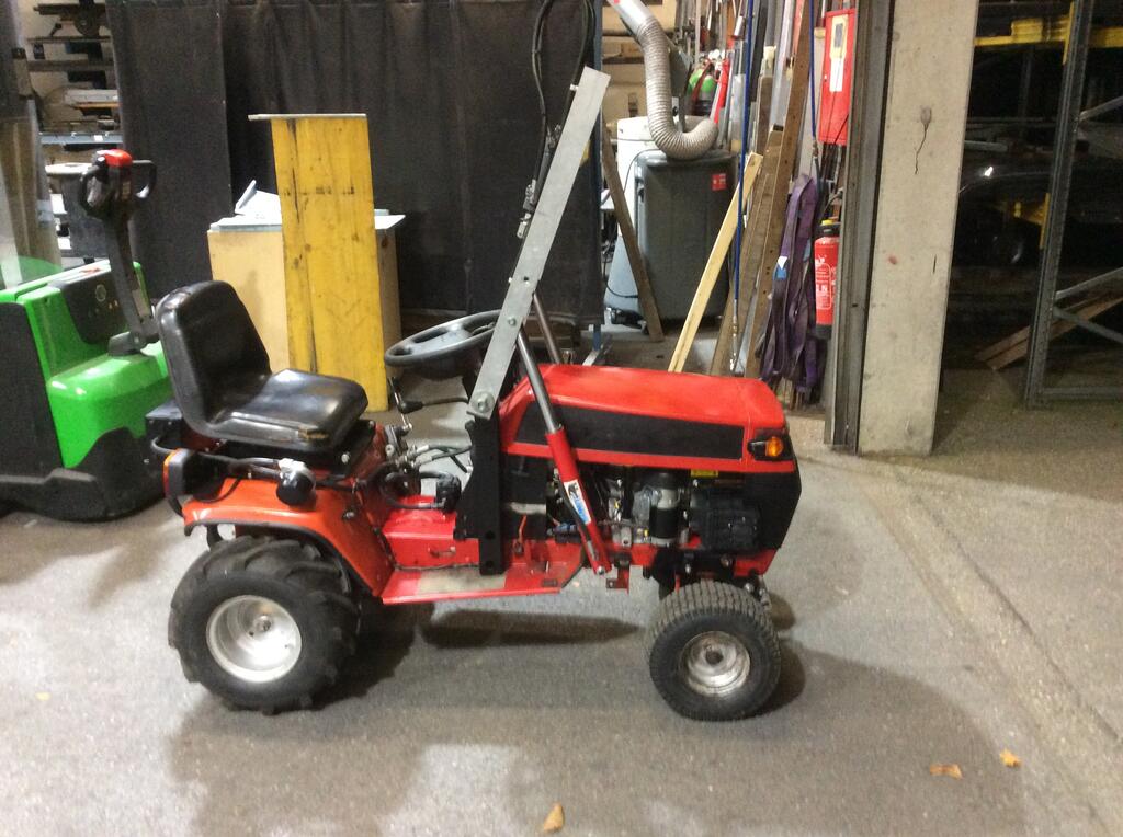

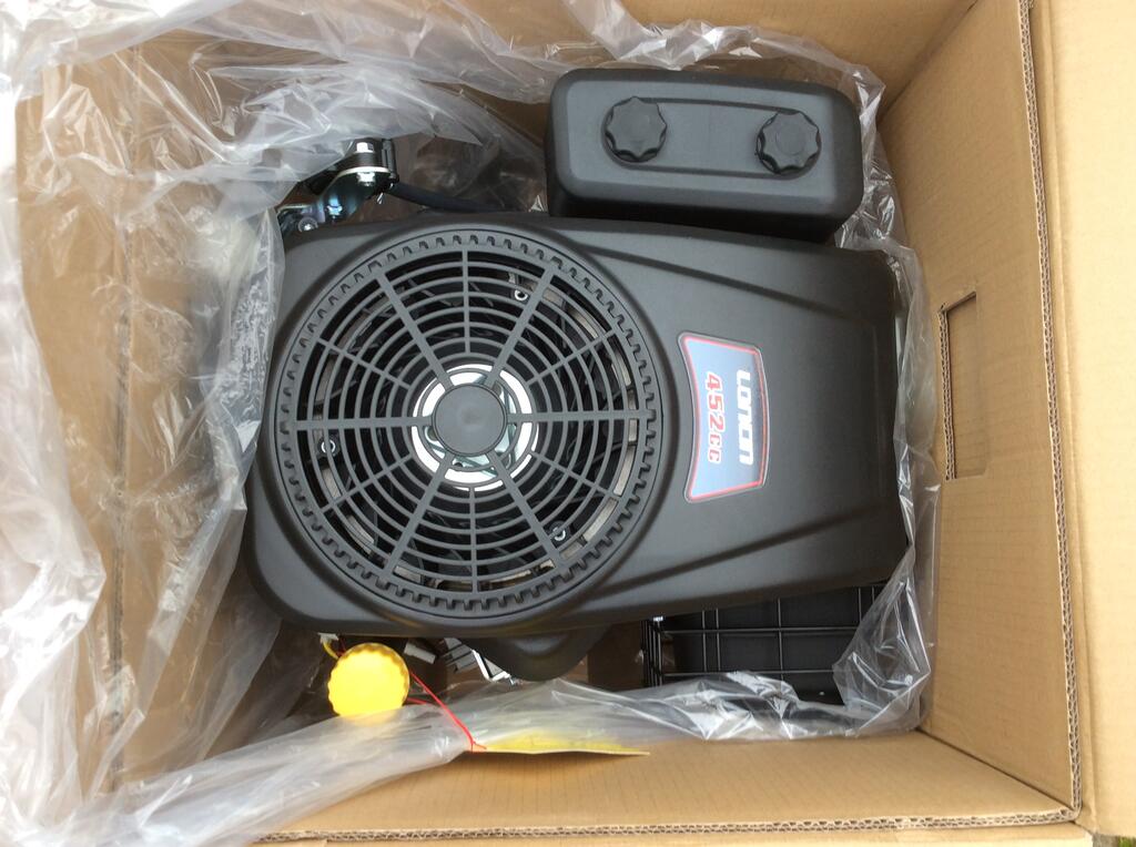

Tractorhead 9,217 #5 Posted May 15, 2020 (edited) Welcome to i Repowered my 212-5 with an 16HP Loncin Engine. after my 12HP Onan dies with a rip in the Cylinder. As @WHX24 allready mentioned, that Tractors have their Limits but not as Bad as the most Plasticcrap you can otherwise buy here on my Site. As a Mower it works so far Fine, this Engine have a good Torque even if Electric Clutch is engaged, i added a Hydraulic also. it still depends what you like to do with it. As a heavy Puller, the Gearbox will last quick, for a simple dump Cart it can be useful. Just as a Mower it is ok, but for some other purposes it‘s mostly too lightweighted. that was the old Onan before... and that was after Swap. i choosen this Engine because of oil pressure lubrication. That‘s important for mowing on a stronger slope Even the Crankshaft is provided with Ballbearings, that give me the ability to implement the Hydraulic System. The Electric was so far compatible with mine, just have to adapt the Plugs and i was good to go. After the complete rework it was a huge helper for me, but not to compare with an Horizontal Engine. The Gearboxes there are much stronger and are lasting over decades of use. Mine was a worker, but i found it‘s limits in the last when hard working especially with the FEL. The FEL was able to lift 750Kilos, i mostly use with loads of about 80-100Kilos but thats also a brutforce rape on the Frontaxle at all and results in a quick wear on the bearings. The Sheet Metal Frame seems to be relatively stiff at all and have a good shape to resists the Load i used, but as allready mentioned it does this with stronger Wear. As my personal experience, if you like to keep it as Mower with sometimes a Dumpcart or a Lawn sweeper on the Rear, it’s not a Bad constellation, the Deck is quite solid (if it still is) As a real Garden Tractor for pulling heavier things or for Plowing it is definitively too lightweighted and wears too fast. Edited May 15, 2020 by Tractorhead Share this post Link to post Share on other sites
