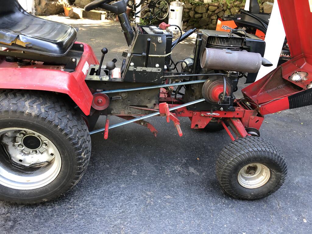

DMB41 5 #1 Posted May 13, 2020 (edited) Hi Friends, First off, A huge thank you to all our Vets! A second thank you to all those who help all of us newbies. I have just changed the drive belt on my 312-8. Online and on the forum I was instructed to go with a 5/8x82 belt the size I pulled off looks like a 1/2x82. After making the change and installing the 5/8x82 drive belt, my tractor will not shift into gear when on. I can shift perfectly fine if the mower is off but as soon as I start it up and try and shift, I get some funky noises and I am unable to get into gear. The belt seems to be spinning fine. It was working perfectly fine before I changed the belt. What could I have done wrong? Thank you in advance! Edited May 13, 2020 by DMB41 Title change Share this post Link to post Share on other sites

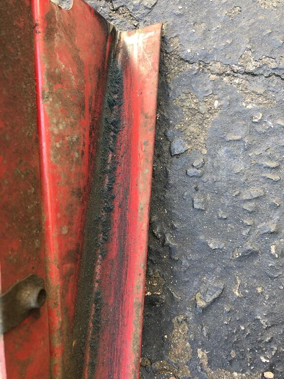

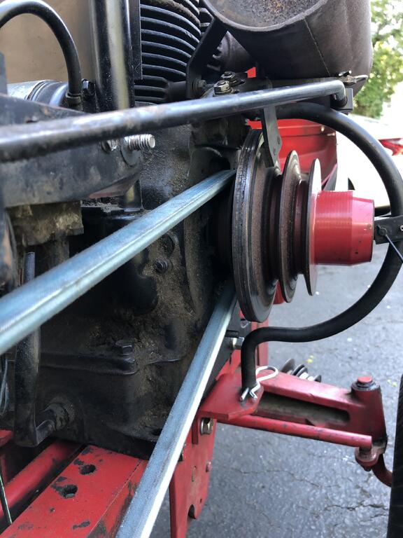

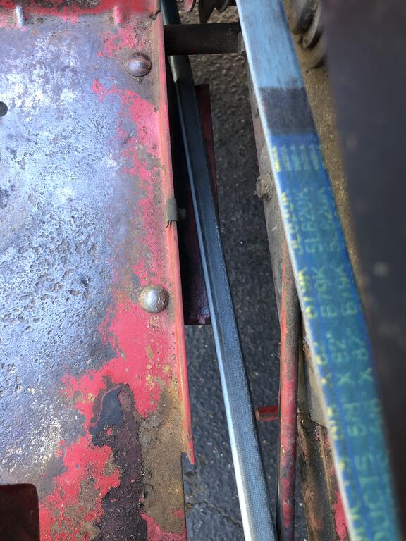

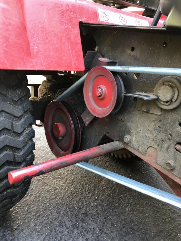

Sparky-(Admin) 25,059 #5 Posted May 13, 2020 So the correct drive belt from Toro/Wheel Horse is a 7473 and it’s a 5/8x82” belt. Your blue belt looked fairly tight in the pics. Being aftermarket did you measure it? It might be a bit shorter than advertised. Also the angle of the side of the belt needs to be correct. If your blue belt has the wrong angle it might not be dropping all the way into the pulleys and that would lead to it feeling to tight or short. I tend to shy away from non Toro belts because of this. 1 Share this post Link to post Share on other sites
Sparky-(Admin) 25,059 #6 Posted May 13, 2020 2 hours ago, DMB41 said: In both of these pics the side of the belt looks to be only partially touching, the entire side of the belt should show “wear” Share this post Link to post Share on other sites
