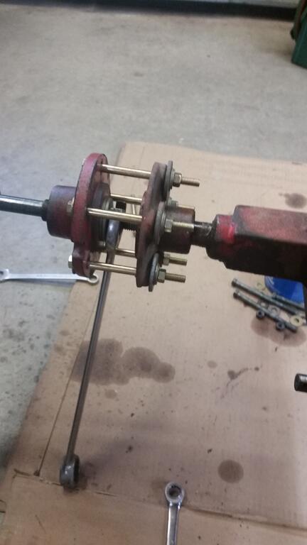

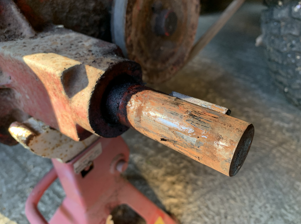

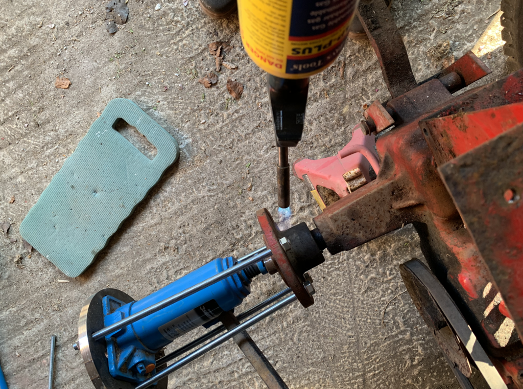

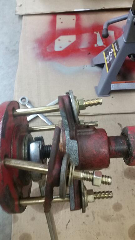

meadowfield 3,191 #1 Posted May 12, 2020 I get tagged quite often, as I once posted a picture of my hub puller. I thought I would post a few pics and it in action on a 40 year old hub that had slipped in and had no set screw. This thing was tight, I had already used a lot of penetrating fluid and traditional puller. Time to bring out the big guns - 6 ton bottle jack and hub adapter from another tractor. Plus a lot of heat - 5-10 minutes before the relief valve was no longer kicking in. having torn down half a dozen transmissions and rebuilt them, I dug out old faithful to do the job. 6 ton bottle jack plus 5 mins of heat, the jack relief valve was kicking in. Another few mins of heat and result! Despite a lot of penetrating fluid - which no doubt burned off - you can see just how much friction there was. Video for those wanting to see it in action. 8 3 Share this post Link to post Share on other sites

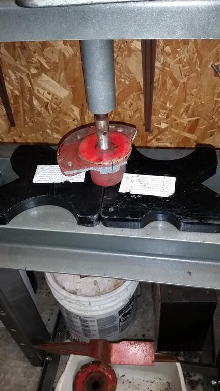

WHX?? 58,307 #4 Posted May 12, 2020 (edited) My problem would be most of the hubs I pull are the sixties style "star" hubs. This set up would shatter them easily. I need to procure, or make, an appropriate bearing separator to pull off the smaller diameter of the hub. My other problem is I tend to spend not enough time on setup and prep. Patience is indeed a virtue here which I usally have little of either! All transmissions do now I attempt to get the "easy" side off if there is such a thing and split the differential in the case and take the remaining hub to the H press. sometimes the crack of them letting loose is a good thing to hear then. One would think this is a good setup..... NOT! Edited May 12, 2020 by WHX24 1 Share this post Link to post Share on other sites
pacer 3,180 #5 Posted May 12, 2020 Yeah, Meadowfield was actually pretty lucky that it came off with only 3 pull points. Even with whx using all 5 pull points you get the result he shows all to often. If I dont get some pretty quick indications its wanting to come off, I do as he says and go ahead and 'bite the bullet' and pull the axle and get it in a - preferably - 20 ton press. Ive had a couple (D axles) that me and a buddy were really getting leery with the pressure we had on the press, being very difficult to even get another stroke on the jack when ----- "POW!!!" and even at that point it took great pressure to keep it moving until about the last 1/2". Folks you have heard us talk about the most difficult things on our horses being the hubs and steering wheels, either one will make you lose your sanity!! 3 Share this post Link to post Share on other sites
ebinmaine 80,974 #6 Posted May 12, 2020 2 hours ago, pacer said: either one will make you lose your sanity makes no real difference to me my sanity was long gone.... Many many many long times ago. @WHX24 Jim when you get around to making that puller setup that pulls off the strong part of the hub I can bet you would sell a few of those to members. 1 Share this post Link to post Share on other sites
meadowfield 3,191 #7 Posted May 12, 2020 There were four pull points when I last counted I couldn’t get the fifth in as the jack base was in the way.... 1 1 Share this post Link to post Share on other sites
WHX?? 58,307 #8 Posted May 12, 2020 4 hours ago, ebinmaine said: around to making that puller setup Yes I have been after Dan to get on me to make one for awhile now. I think I have a pretty good design conjured up. What the smallest bottle jack a guy could get get away with using? 4 ton?? 953 and GT 14 hubs can be pretty stubborn. Then there's the D's 2 Share this post Link to post Share on other sites
stevasaurus 23,857 #9 Posted May 12, 2020 I'm going to move this to the instructional threads. Nice set up Mark. 1 1 Share this post Link to post Share on other sites
pacer 3,180 #10 Posted May 12, 2020 None of the 2-3 bottle jacks I have will not pump with it on the side like that (mind you, they are a tad old) maybe the newer ones do?? Share this post Link to post Share on other sites
meadowfield 3,191 #11 Posted May 13, 2020 12 hours ago, pacer said: None of the 2-3 bottle jacks I have will not pump with it on the side like that (mind you, they are a tad old) maybe the newer ones do?? they have a feeder tube inside that runs to the bottom... I just made sure this was laid on the right side. It won't jack fully out mind - but enough to push it off. 1 Share this post Link to post Share on other sites

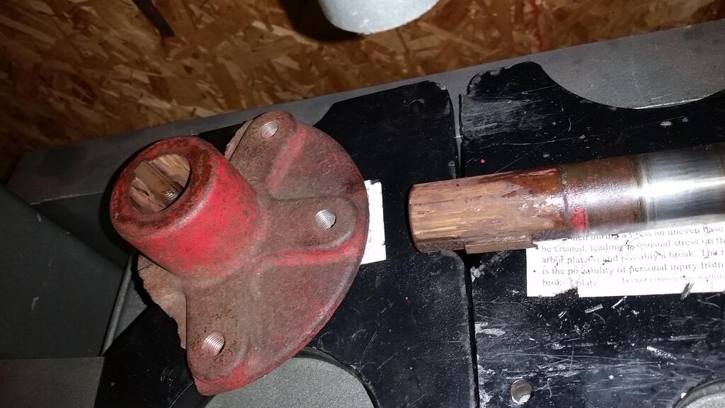

Steven_McGivney 1 #13 Posted May 22, 2021 On 5/12/2020 at 7:19 AM, meadowfield said: I get tagged quite often, as I once posted a picture of my hub puller. I thought I would post a few pics and it in action on a 40 year old hub that had slipped in and had no set screw. This thing was tight, I had already used a lot of penetrating fluid and traditional puller. Time to bring out the big guns - 6 ton bottle jack and hub adapter from another tractor. Plus a lot of heat - 5-10 minutes before the relief valve was no longer kicking in. having torn down half a dozen transmissions and rebuilt them, I dug out old faithful to do the job. 6 ton bottle jack plus 5 mins of heat, the jack relief valve was kicking in. Another few mins of heat and result! Despite a lot of penetrating fluid - which no doubt burned off - you can see just how much friction there was. Video for those wanting to see it in action. I did similar to my 418-8, 1 1/8 axle, one keyway refuses to come out, its real hard steel,, I have to change oil seal behind it so, I'll put it together as backwards , shaft is out,, 1 Share this post Link to post Share on other sites
ebinmaine 80,974 #14 Posted May 22, 2021 26 minutes ago, Steven_McGivney said: I did similar to my 418-8, 1 1/8 axle, one keyway refuses to come out, its real hard steel,, I have to change oil seal behind it so, I'll put it together as backwards , shaft is out,, Steve you can cut the woodruff key with a die grinder. Slice down the middle and it'll collapse into itself. 1 Share this post Link to post Share on other sites
