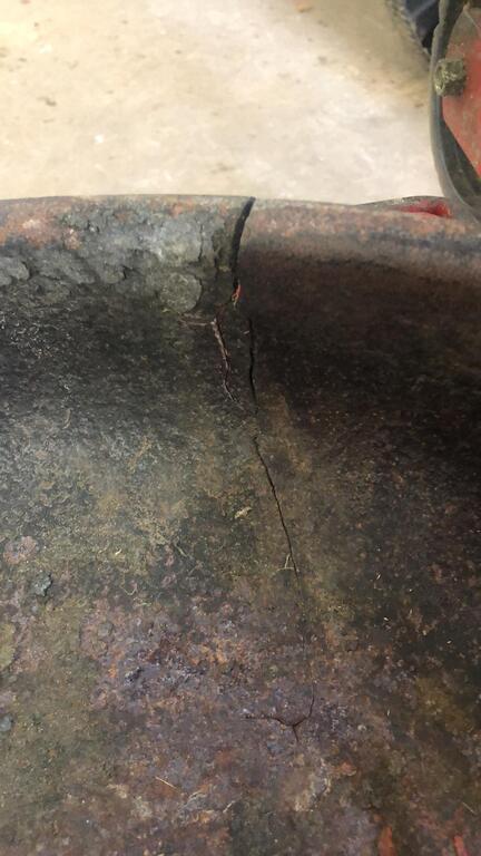

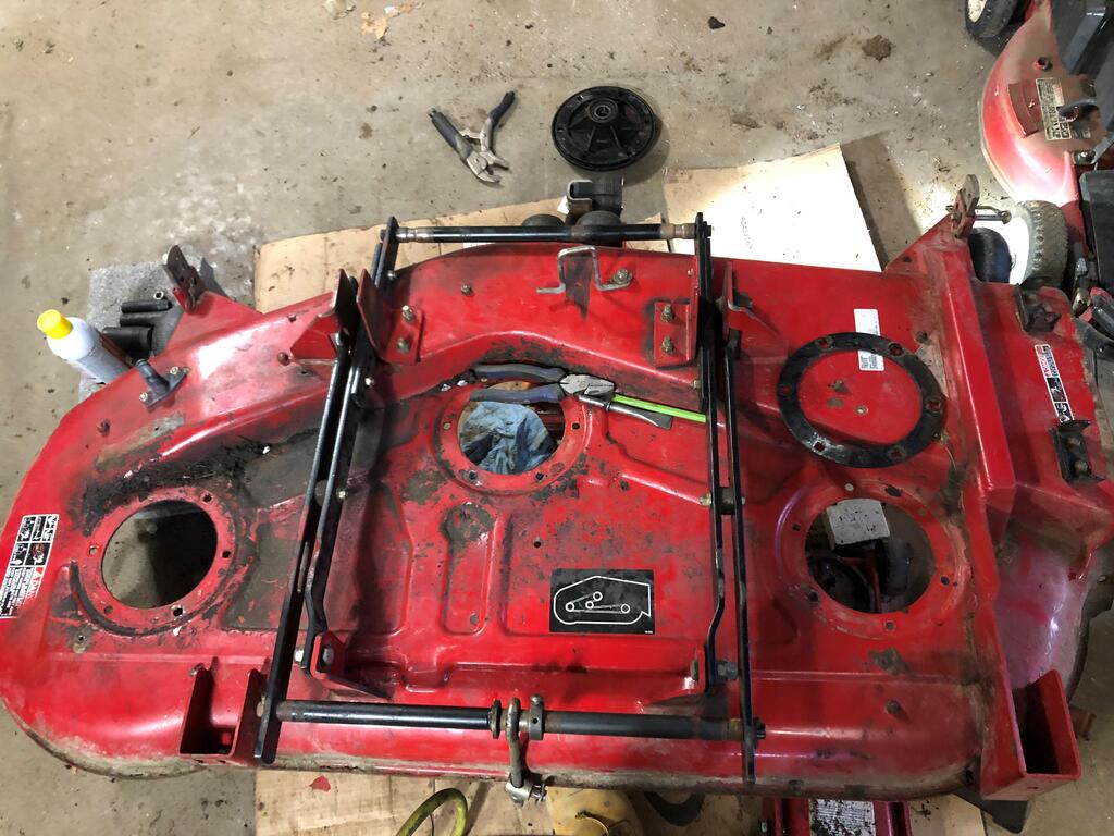

bizzo15 52 #1 Posted May 12, 2020 Hey gang, It's been awhile since I've posted here but my 5xi has been running flawlessly so I haven't need to pick your brains....until now! So at the end of the mowing season last year I took my deck off to put it away and I noticed a crack on the rear of the mower on the discharge side right where the rear wheels mount to the mower. My intention was to deal with it over the winter but of course that never happened. I got around to pulling the deck out the shed yesterday and looking at the crack and it is a bit bigger than I remember and something I definitely want to address before it gets worse. At first I was just going to take the blades off clean the underside of the deck really good, get the crack welded and repaint the underside. As I got to taking the blades off I noticed the center spindle was noisy and decided I was going to rebuilt the spindles with fresh bearings while I was working on the deck. After struggling to get those off due to the carriage bolts wanting to lift up out of their square and spin and it taking way longer than it ever should of to remove the spindles I've decided to strip the deck completely and restore it. The more I looked at the top of the deck there was plenty of spots with paint chipping and rusting that it just makes sense to me to restore this thing to tip top shape and get another 10-20 years of use out if it. That's where all you experts come in, I've only ever replaced the spindles on one other mower deck and it was green. I'm looking for recommendations...I'm leaning towards finding someone to sandblast the entire deck for me and then getting it welded and ready to paint. Is it worth it to pay someone to sandblast the deck or should I suck it up and wire brush and strip the deck to bare metal myself? I'm leaning towards having it blasted because I don't have the hours to dedicate right now to stripping the deck myself and I feel like blasting will do a better job of prepping the metal for fresh paint. My next question is regarding the spindles. I assumed there was going to be a snap ring holding the bearings into the spindle but upon examination I don't see a snap ring in any of the spindles. Also, on one of the spindles the blade side bearing actually fell out when I removed the pulley and the shaft. Are these bearings just press fitted into the spindle housing? If so, am I going to need a press to reinstall new bearings? I don't own a hydraulic press, but I do have a heavy duty ball joint press, not sure if I could use that to press them back in. My last question for now is regarding paint...what kind of paint should I use for the underside? I'm leaning towards something similar to por15 to stop the rusting but open to any and all recommendations. Lastly, I own an air compressor but don't own a spray gun nor have I ever sprayed anything with one. Will I be able to get a decent paint job using rattle cans? I'm not looking for show quality but I want it to look good and reflect the amount of time and money spent to restore it. Mostly I want a durable paint that will last for years to come. Will I be able to achieve that using rattle can paint? Ok, enough of the questions for now..here's a pic of the crack that started this all and a pic of my progress so far. Thanks for any and all help in advance, there's always a ton of helpful people on here and it's appreciated. Share this post Link to post Share on other sites

bizzo15 52 #9 Posted June 20, 2020 Well it's been a little bit since I've updated this thread so here it goes. Buddy of mine welded up the cracks in the deck and I sent it off to be sandblasted. I've never painted anything that has been sandblasted before so I wasn't sure what to use to clean and prep before paint but I ended up using Klean Strip Concrete and Metal Prep on the deck I let that sit on the deck for 24 hrs so it could try completely per the instructions and it left quite the residue. I wire brushed all that off and then used some Rustoleum self etching primer to prime the deck Now I'm torn on how/what to paint the top coat. I'm tempted to buy a HLVP gun from harbor freight and give spraying the deck a try but I can't figure out what paint to spray. I'd like it to match as closely as possible to the original color and more importantly be durable. I understand the bottom of the deck won't hold up but I really want to top of the deck to stay nice for as long as possible. Any suggestions? Share this post Link to post Share on other sites
