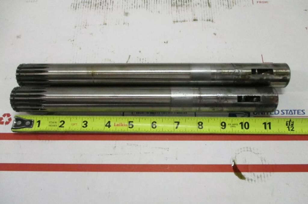

71_Bronco 1,072 #29 Posted May 26, 2020 Not a huge update, but just ordered these off ePay for $49 shipped. Confirmed all the measurements prior to ordering. 1 Share this post Link to post Share on other sites
stevasaurus 23,786 #30 Posted May 27, 2020 Those look pretty nice. Save those other axles, someone will need them. Share this post Link to post Share on other sites
71_Bronco 1,072 #31 Posted May 27, 2020 5 hours ago, stevasaurus said: Those look pretty nice. Save those other axles, someone will need them. Definitely will. Other than the ugly gobs of weld on the end, they are in excellent shape, keys are perfect and the teeth look new. Is there anything I should do to the axles when they come in? Maybe a very light polish? I obviously don't want to go too aggressive and make them under-sized and have sealing issues, but at the same time, don't want any rough edges / burrs when I pass them through the seals. Share this post Link to post Share on other sites
stevasaurus 23,786 #32 Posted May 27, 2020 I would just steel wool them, use a file to get rid of any burrs on the end or around the key way. Use masking tape over the end and keyway when placing the new seal. 2 1 Share this post Link to post Share on other sites
71_Bronco 1,072 #33 Posted May 31, 2020 (edited) Got the axles in, everything looks great. My old hubs slip over nicely without play, and everything looks good. Cleaned them up with some steel wool and a file. Looked into new pinion gears. Found some new ones on ePay, but they are $30+ each (and I need 10....). A-Z has them for $10 each, but are used ones. I may just reuse my old ones and arrange them so the little wear spots dont match up to eachother (basically reversed from the picture I posted before). With the differential sorted out, I can start looking into the case, bearings and the other gears. Figured I'd take it one piece at a time. Also, I ordered another set of studs for these hubs so I dont have to pull the set off my 3-speed. Edited May 31, 2020 by 71_Bronco 1 Share this post Link to post Share on other sites

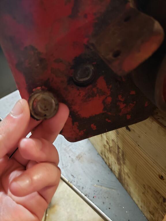

71_Bronco 1,072 #35 Posted June 27, 2020 Got to work on this today a bit. Got it all bolted together with a new gasket. Didnt change the seals yet, but have a spare set in case any leak. Got the hubs back on, cleaned up the brake drum and put it in, and put on the new pulley. Just need to swap over the hitch and brake band and it will be ready to go. I do have one small issue. I popped out some kind of plug on the brake side. It looks like it lines up with the input shaft. I may have popped it out when I was tapping the new input pulley on. Should I just tap it back in? Use a little loc-tite? Share this post Link to post Share on other sites
gwest_ca-(File Mod) 12,421 #36 Posted June 27, 2020 That looks like the back end of a blind needle bearing. Does look like it broke off? Garry Share this post Link to post Share on other sites
71_Bronco 1,072 #37 Posted June 28, 2020 The plug looks like its plastic. Inside the casting is the metal bearing. I tapped on the closed end of the bearing (in the block) and it slid in just a tiny bit. Once I tapped it in, the input shaft had less in-and-out play. I think when I tapped on the input pulley, it pushed the bearing out slightly and that pushed out the plastic cap. Once I pushed the bearing in slightly, I pushed in the plastic cap and now it's good as new. Share this post Link to post Share on other sites
