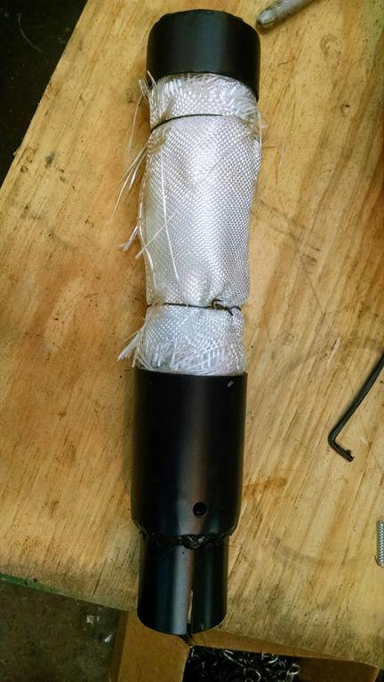

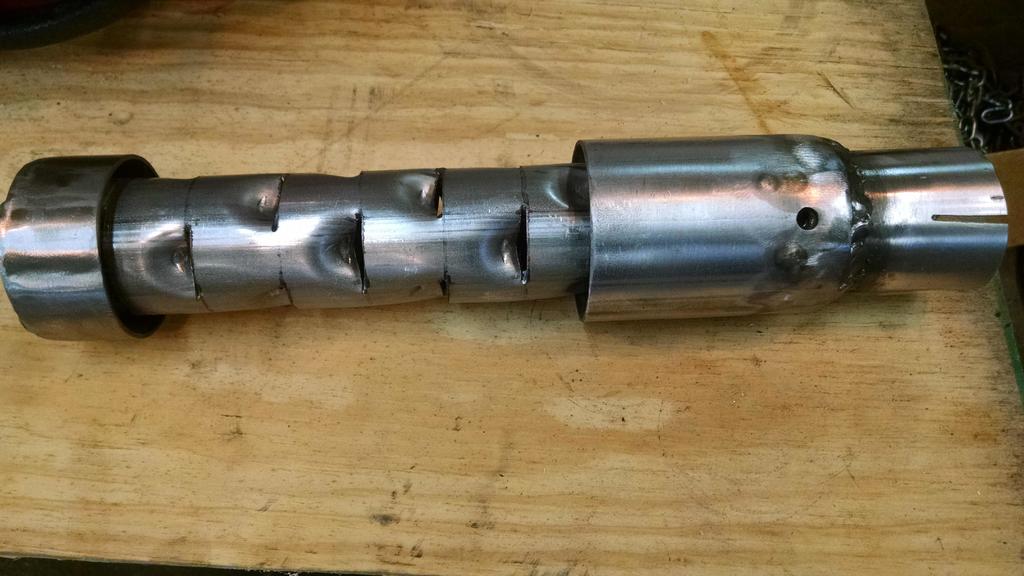

ebinmaine 80,134 #26 Posted May 12, 2020 Another question I forgot to add to the above post. Given the fact that I'm trying to make these quiet, if possible AND stop sparks from flying. Should I cap the small pipe with the upper freeze plug and drill a series of small holes around the outside edge of that? Thereby forcing the exhaust to go out the small holes and into the upper chamber to exit. If so, is there a packing that the exhaust can go right through without being detrimental to flow? Or should I build it without any packing and allow the movement of the exhaust through all the holes to be its own muffling effect? Share this post Link to post Share on other sites
WVHillbilly520H 10,379 #27 Posted May 12, 2020 The fiberglass packing is some of your spark arrestor but adding a screen mesh (window screen) would be effective as well without reducing flow IMO. 1 Share this post Link to post Share on other sites
ebinmaine 80,134 #28 Posted May 12, 2020 16 minutes ago, WVHillbilly520H said: The fiberglass packing is some of your spark arrestor but adding a screen mesh (window screen) would be effective as well without reducing flow IMO. Should I run it as a straight through or cap the small pipe? Share this post Link to post Share on other sites
WVHillbilly520H 10,379 #29 Posted May 12, 2020 Straight. 1 Share this post Link to post Share on other sites

tom2p 2,396 #31 Posted May 12, 2020 On 5/11/2020 at 7:51 AM, Achto said: I used fiberglass mat when I made the pipe for Radpferd. The same fiberglass mat that is used for making repairs on fiberglass. outstanding job - did you build this from scratch ? reminds me a tad of the old 'off-road' chambered exhaust on the early Z-28 302's (but your pipe is perforated and packed with sound deadening material) 1 Share this post Link to post Share on other sites

Achto 32,271 #34 Posted May 12, 2020 2 hours ago, tom2p said: outstanding job - did you build this from scratch ? Thank you, I did make it from scratch. Here is a link to the making of it. 1 1 Share this post Link to post Share on other sites
