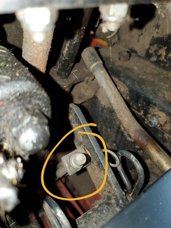

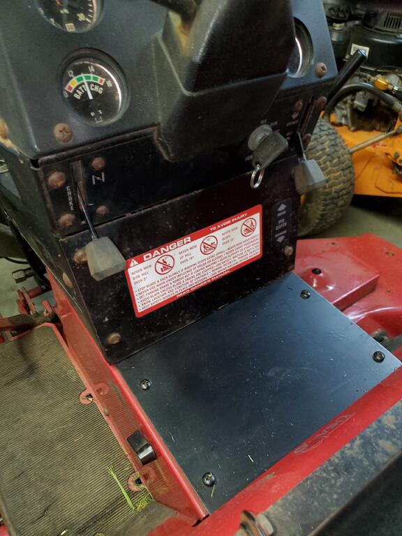

69mach 10 #5 Posted May 12, 2020 (edited) 21 hours ago, lynnmor said: Did you folks do the adjustments mentioned in both posts? Did you answer the questions? Just fixed it by tightening the trunnion nut. Didn't take 10 minutes. Thanks for the help. On 5/10/2020 at 6:08 AM, WheelHorse520-H said: I have a 48” deck for my 520-h. Cuts great but when I raise the deck all the way up the discharge side raises a good 2” more then the left side. The bracket on top the deck is on right and nothing is bent. Is this normal on a hydro lift? If not how do I fix it. Thanks Remove the vertical cover plate under steering wheel, lift deck then tighten the nut at trunnion until deck hits the rubber stops. Very easy. 1/2" deep socket & extension Edited May 12, 2020 by 69mach added something Share this post Link to post Share on other sites
WheelHorse520-H 4 #6 Posted May 16, 2020 I appreciate it. I’ll do it this weekend. I adjusted the deck stops on the deck frame and that didn’t do much. I adjusted the rod in the middle back of the deck and that didn’t change anything. So by adjusting this in the pick will raise and level the deck? Share this post Link to post Share on other sites
WheelHorse520-H 4 #7 Posted May 16, 2020 Mine is all the way tight already. I got it. Had to adjust the lift arm chain and put it in the first hole. Thanks for yalls help Share this post Link to post Share on other sites
