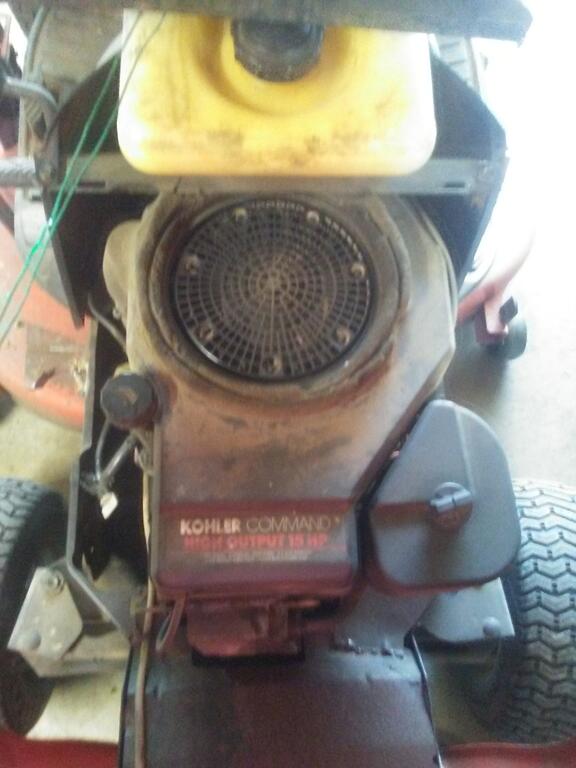

Dominator 77 #1 Posted May 9, 2020 Hello all,. Have a shot at a 2000 314-8. Has the command pro which I'm not too familiar with. How does it stack up against the magnum or is it one to avoid? Appreciate all comments. Thank you, dominator Share this post Link to post Share on other sites

bds1984 1,519 #13 Posted May 10, 2020 My 315-8 has a Kohler Command 15 on it that performs just fine. It spins my 48" deck just fine in the thick grass, is quite, fuel efficient, and having the pressure lube is a plus. Not quite a K341 but not much is. 1 Share this post Link to post Share on other sites
