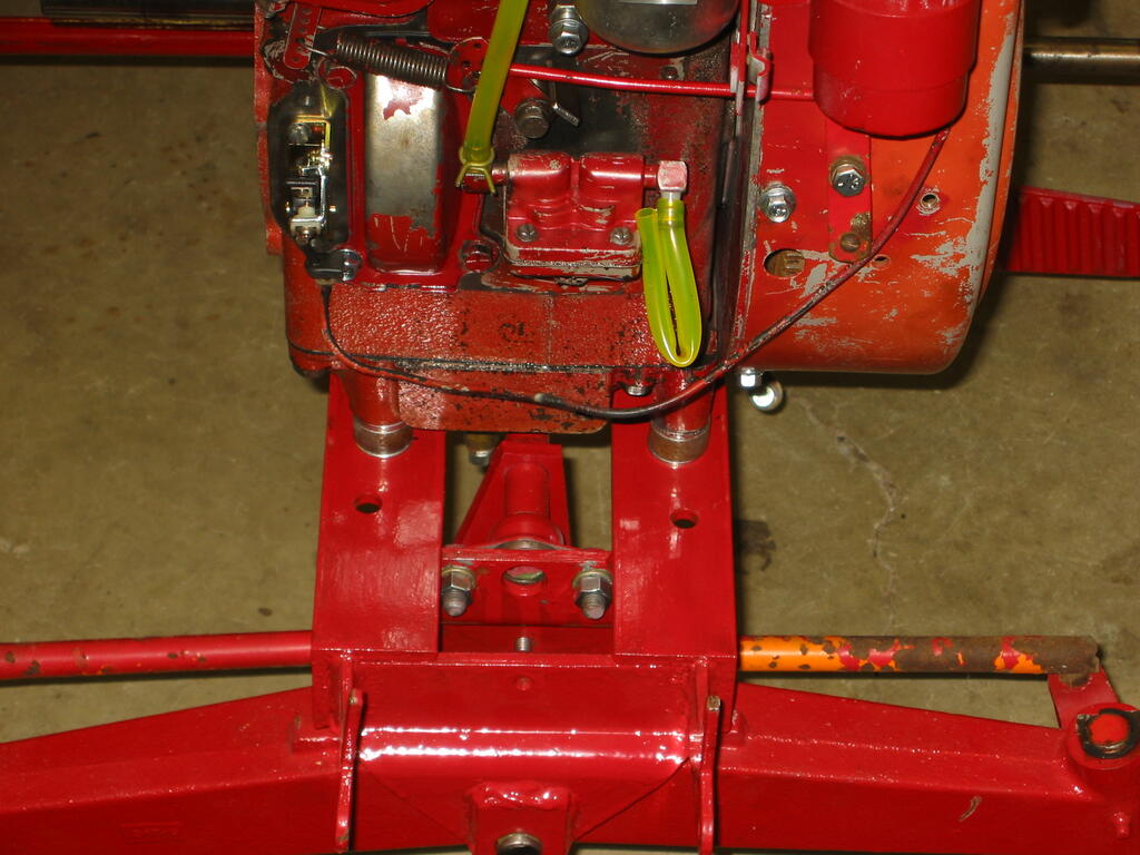

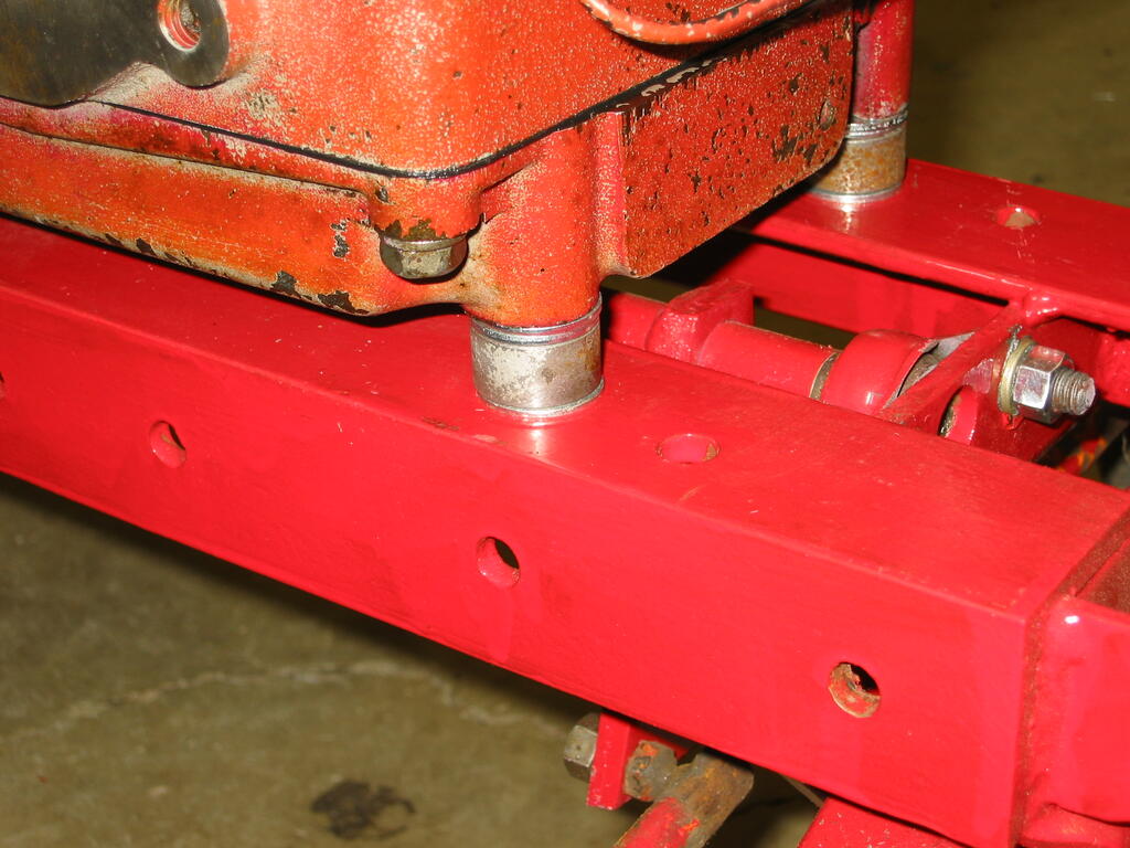

pfrederi 18,969 #10 Posted May 9, 2020 Another alternative...Cheaper... Spacers were from a 8 hp isolation mount, couple of washers. Depending on your frame you may have to drill 2 holes or maybe not. 3 Share this post Link to post Share on other sites
