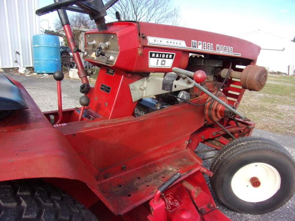

Ed Kennell 47,609 #12 Posted May 8, 2020 The only time I set a PTO clutch gap is on the old Raider style lever that has a gap calibration notch on the bracket. With the later style on the C series, I also just shorten the rod by turning the trunnion back until I get enough pressure on the clutch plate to prevent slippage. Raider style lever in gap calibration notch 1 Share this post Link to post Share on other sites
