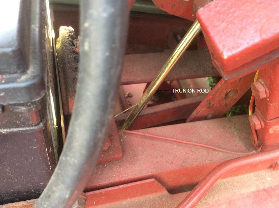

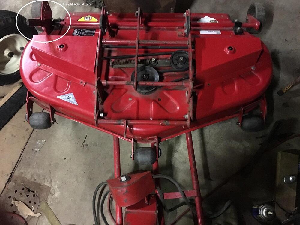

daveoman1966 3,884 #3 Posted May 7, 2020 R U sure the deck is mounted coirrectly.... Particular attention to the FORK in the mid-tach-o-matic: There is also a 'Trunion Rod' at the lift bar that MAY need adjustment... MAYBE... move the HEIGHT adjust lever to its lowest position... 1 Share this post Link to post Share on other sites

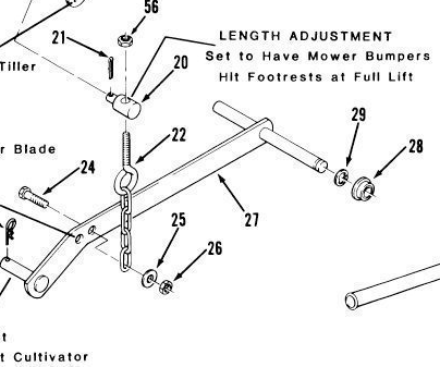

biged77 113 #6 Posted May 7, 2020 For what it's worth I have the same problem, the forked bracket flops back down before I can grab the lift lever and pull it back. Sometimes takes a few tries but always able to get it. If somebody knows a trick I wish they would let us know. As for it locking in the up position, I had the same problem with my 418-8 with 48" SD mower. Had to adjust the lift trunion like daveomann1966 suggested. Adjusting was not easy, required trial and error and each time the deck had to be removed for access and the chain disconnected from the mower lift arm. I just now saw a note on the parts list that says "LENGTH ADJUSTMENT. Set to have Mower Bumpers hit Footrests at Full Lift." Wish I had seen before. 1 Share this post Link to post Share on other sites
