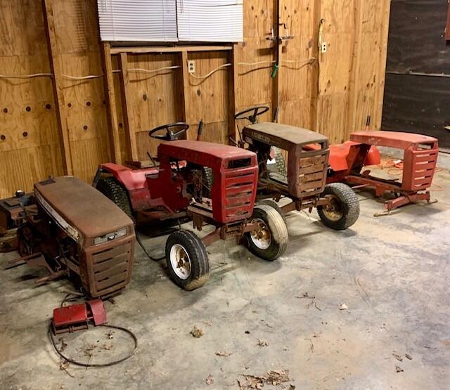

Greentored 3,220 #84 Posted May 19, 2020 (edited) Well, this 'ultimate tractor' stuff just got kicked into high gear! With selling the 520H, it freed up some play funds- picked up these four parts tractors right around the corner from me and swapped the C120 hydro into my new main tractor- the 1277. Now I have a hydro that doesnt get weak when it warms up I want a 6/8 speed, but for lawn duty and a lot of things to mow around, it had to be a hydro. Current thought on an ultimate is to take that 'mystery tractor' in the center left of photo 1 since its a long frame/big 8 speed and mostly complete and use it as my building block. Picking up a 14hp Kohler possibly this weekend, I believe that will suffice until I find a cheap genset to rob a big Onan twin from. Next will be to ditch the floor boards and toss a pair of stirrups on it, and of course a metal tractor seat and AG tires. This would be my plow dog and overall heavy duty, non hydro user. I think the 654 trail bomber is going to get returned to garden duty, and the C81 (also 6/8 speed) in the left photo may get the hopped up 11hp and become the new trail bomber. Will look for a nice little 8hp Kohler to stuff in the 654, hop it up a bit, and make a nice disc dragger and wagon yanker. Of course, thats just the current plan. Something else may come along and throw the whole thing out of whack Edited May 19, 2020 by Greentored 1 Share this post Link to post Share on other sites
