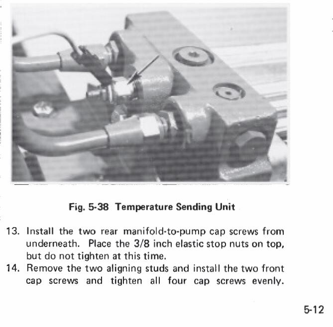

jerry potaracke 3 #3 Posted May 4, 2020 i am looking for the transmission temperature sending unit. can you describe it and its location thank you . Share this post Link to post Share on other sites
gwest_ca-(File Mod) 12,483 #4 Posted May 4, 2020 Found this in Section 5 of this service manual. Click on the picture to see what is in each Section. Garry Share this post Link to post Share on other sites
jerry potaracke 3 #5 Posted May 5, 2020 yes sir it is the temperature sending unit the stud spins in the back of the unit is this something i can purchase at oreillys auto thanks for all your help Share this post Link to post Share on other sites

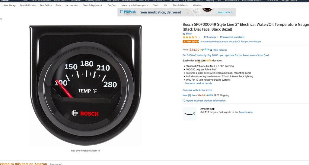

pfrederi 21,145 #6 Posted May 5, 2020 Sending units have to be matched to the gauge they are running. Your best bet buy a new gauge and will come with correct sending unit. Get an electrical one most mechanical gauge sending units will not fit in the hydro pump. Something like this Share this post Link to post Share on other sites
