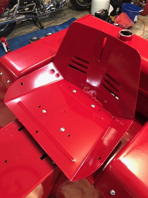

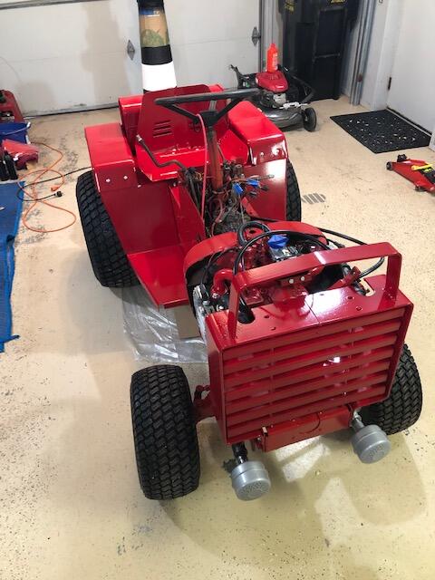

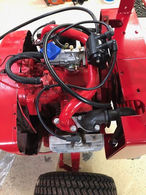

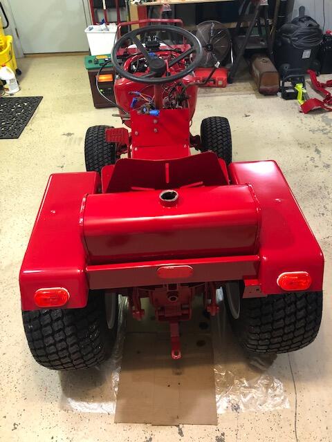

3WHDave 60 #1 Posted May 4, 2020 (edited) I thought it would be of interest to post some pics of my restoration to-date. I anticipate "firing it up" this coming weekend. Bottom-line: taking many pics during the tear-down has been invaluable! I painted it with a two-part I-H red because I had a gallon on-hand, it shoots easy from an HPLV gun and Tractor Supply has rattle-cans on hand for touch-up. PS: I simply could not be doing this project without the support of this forum! Edited May 4, 2020 by 3WHDave 6 10 1 Share this post Link to post Share on other sites

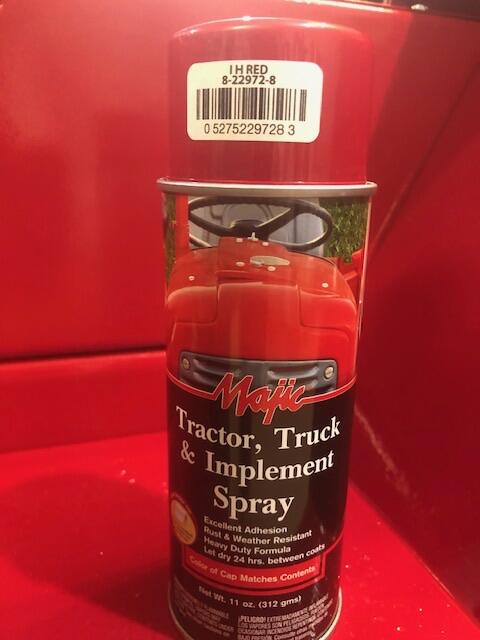

oliver2-44 11,791 #2 Posted May 4, 2020 Looks Great. Please share a little more about the 2 part IH red you used. Maybe some pictures of the can labels, etc. Share this post Link to post Share on other sites
3WHDave 60 #3 Posted May 4, 2020 I just edited the first paragraph, if you didn’t see the typo, you are lucky! I am digging through trash for paint can, but here are the rattle cans from Tractor Supply: 3 Share this post Link to post Share on other sites
