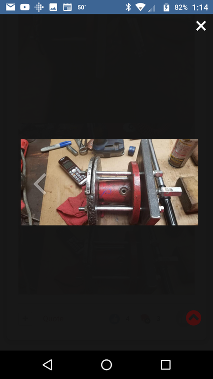

troutbum70 858 #4 Posted May 4, 2020 This is the very best way to remove stuck hubs. Share this post Link to post Share on other sites

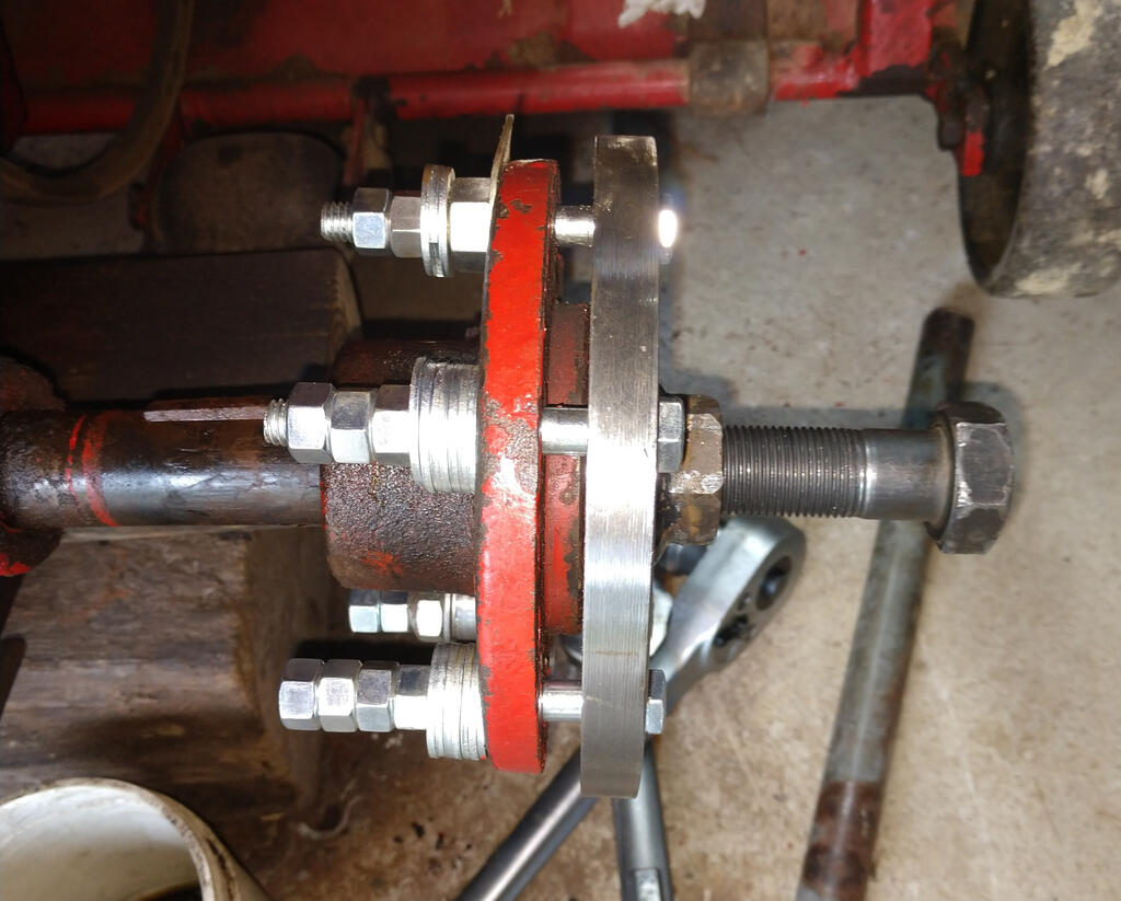

Sam Pasch 450 #5 Posted May 4, 2020 My 867 had a stuck hub that I made a home made puller for. It was so stuck that it bent my puller in half.😁 Share this post Link to post Share on other sites
