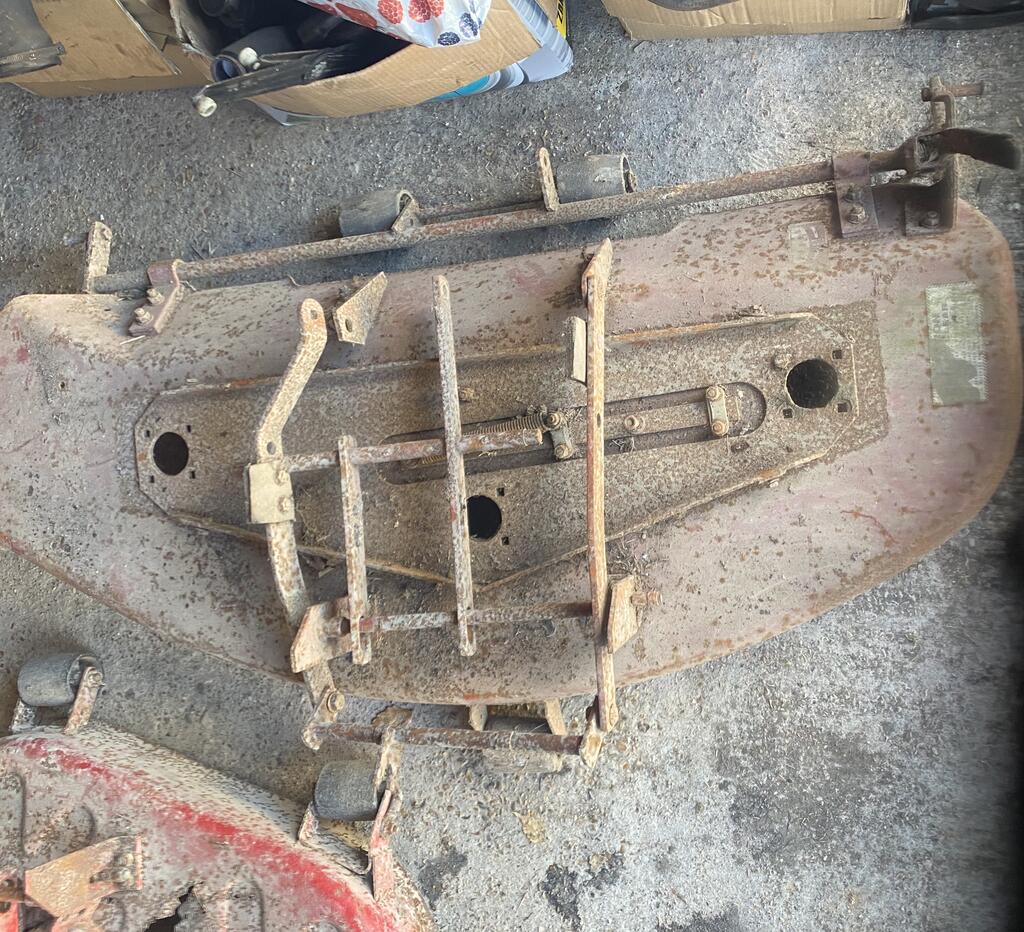

C165 in the UK 0 #3 Posted May 3, 2020 Not sure, it’s at my yard at the moment, but I think it’s a 48”. Picture attached. I’m just starting to restore it at the moment. Share this post Link to post Share on other sites

daveoman1966 3,880 #5 Posted May 12, 2020 I sent this earlier.... The PTO belt from tractor to the 48" deck is #102742 or 94-2501...Size is: 103" L x 0.5" W (same belt.) The DECK belt to drive the 3 spindles on the 48" deck is number 1594... Size is: 107.38" L x 0.5" W Share this post Link to post Share on other sites

daveoman1966 3,880 #7 Posted May 12, 2020 I would urge you to use OEM belts... Aftermarket belts are not of the EXACT same geometry...too thin, thick, high, wide and and they are...generally speaking... of lesser quality. On the oither hand, being in the UK may make it cost prohibitive to have OEM belts sent across the pond. Belt 1594 can be had for $26 and belt 102742 (94-2501) is in the USA for $28. Pprobably 8 or 10 shipped to ME but they don't ship direct to UK. thru this website https://www.psep1.biz/arinet.asp?aribrand=TO# Share this post Link to post Share on other sites
