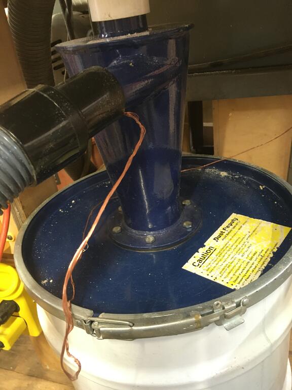

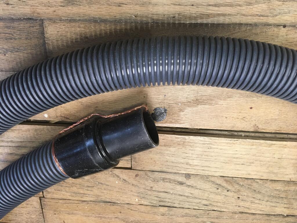

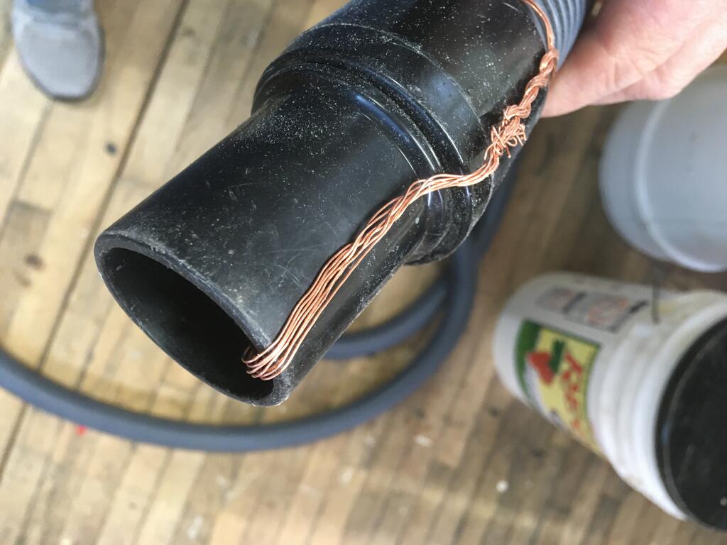

formariz 12,379 #1 Posted May 3, 2020 (edited) Since my shop is part of house, cleanness is a must specially when the “dust police” also lives here. A frustrating part of it is when cleaning up and dust sticks to outside of vacuum hose from the static generated by the moving air. Regardless of what hose and what manufacturer claims It’s always an issue. Dust from Corian or any plexiglass is particularly troublesome. To avoid it 100% the only way is to run a copper ground wire inside of hose and ground it to the electrical ground somewhere. Totally fixes problem. I also do the same on any part of dust collection for safety reasons. Edited May 3, 2020 by formariz 7 2 Share this post Link to post Share on other sites
