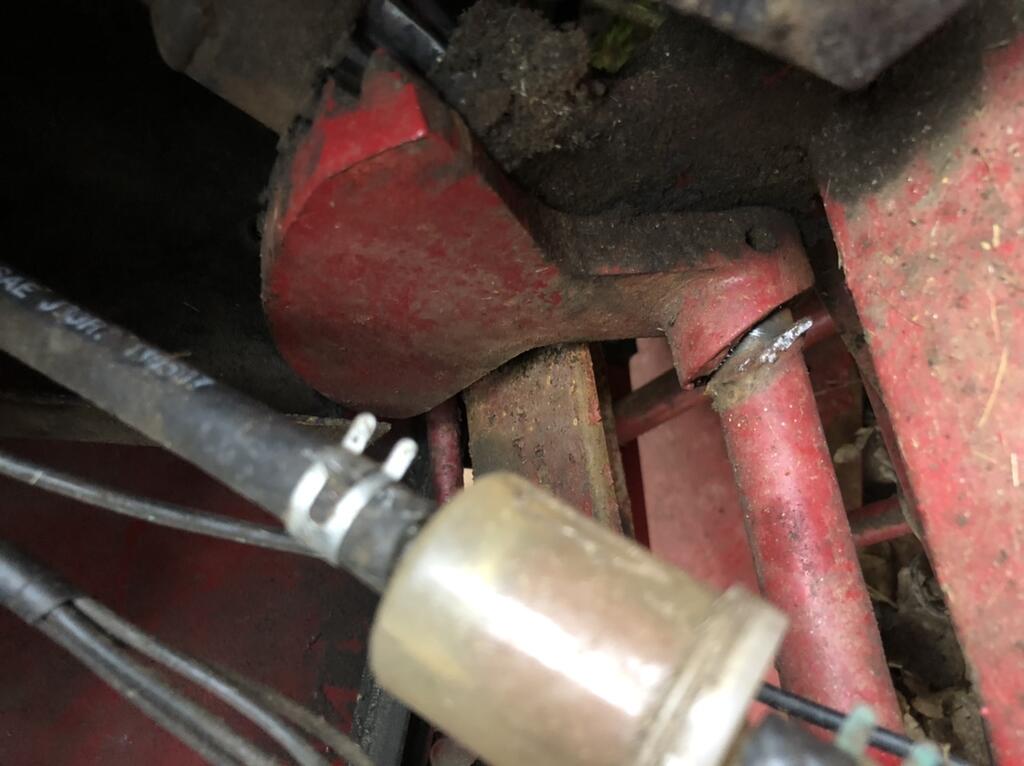

DMB41 5 #1 Posted May 2, 2020 Hi All, we had some great weather in CT after a long while and I wanted to get out on my 312-8! Unfortunately, I hit a rock and now I can’t turn. I think I may have blown my steering rod/fan gear? Any help on replacement parts and directions would be very much appreciated. Thanks in advance! Share this post Link to post Share on other sites

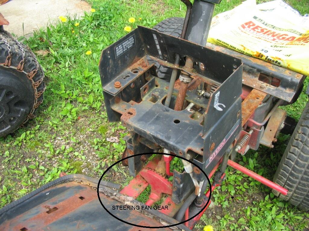

daveoman1966 3,884 #2 Posted May 2, 2020 (edited) Put $50 bux in my Paypal account as "Send Money to a Friend" and I'll send you a replacement... my Paypal account name is: daveoman@windstream.net Will get pics in a few m,inbutes...... Edited May 2, 2020 by daveoman1966 1 1 Share this post Link to post Share on other sites
ebinmaine 80,612 #3 Posted May 2, 2020 Looks like yours has been cracked at the weld for awhile. Dave has a good suggestion above. Easy bolt-in replacement. 1 Share this post Link to post Share on other sites
DMB41 5 #4 Posted May 2, 2020 31 minutes ago, daveoman1966 said: Put $50 bux in my Paypal account as "Send Money to a Friend" and I'll send you a replacement... my Paypal account name is: daveoman@windstream.net Will get pics in a few m,inbutes...... Thank you sir! Just sent! 1 Share this post Link to post Share on other sites
daveoman1966 3,884 #5 Posted May 3, 2020 5 hours ago, DMB41 said: Thank you sir! Just sent! I'll sent the lower steering shaft with gear on Monday...thanx. Share this post Link to post Share on other sites
