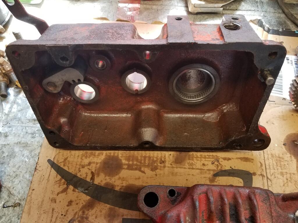

DarrellF 33 #1 Posted May 2, 2020 (edited) Here we go. Now what parts am I going to be able to get? Any help? Am I missing anything? I'm going to start looking tomorrow Thanks Darrell D200 Rear End Parts 4-13 3 needle bearing #1532 Need 4-14 2 needle bearing #8048 Can live with out 4-15 2 axle needle bearing #1526 #9416 Need 4-16 2 axle seal #6449 Need 4-17 1 brake seal #5959 Can live without 4-18 1 needle bearing #8049 #M-16101 Need 4-55 1 Gasket #102759 Need 4 Hex bolts, Zinc plated grade 8 steel yellow, 5/16"-18 x 3-1/2" 4 Hex lock nuts nylon insert, Zinc plated grade 8 steel yellow, 5/16"-18 Edited May 2, 2020 by DarrellF Share this post Link to post Share on other sites

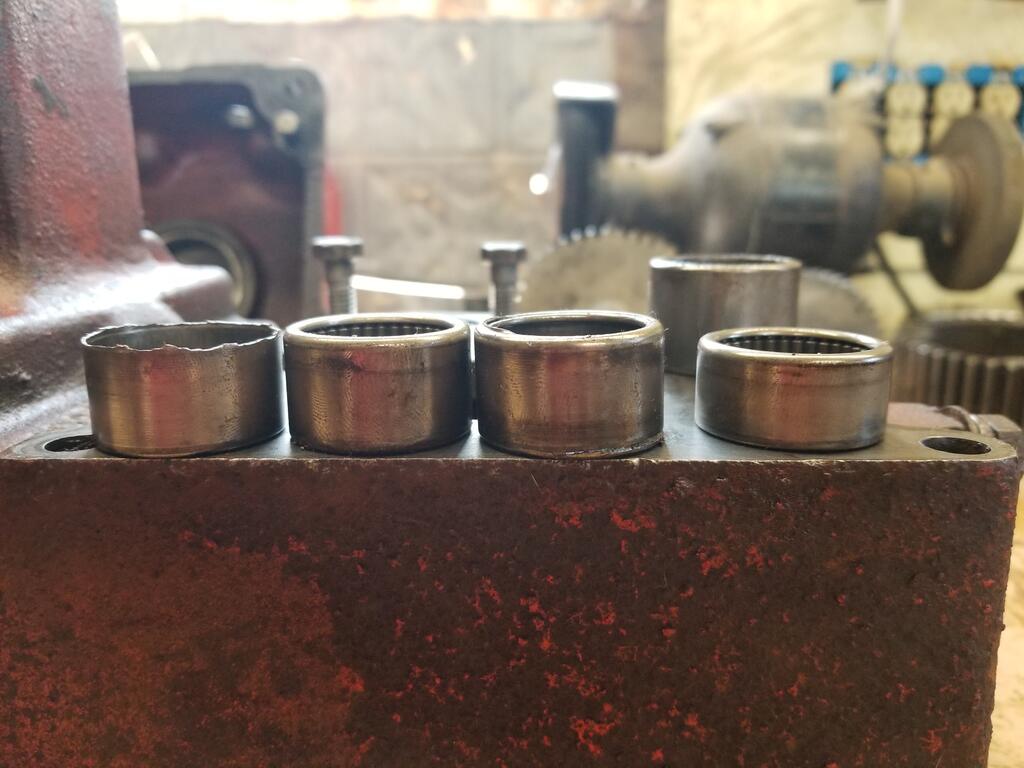

DarrellF 33 #6 Posted May 2, 2020 I'll post some pics later. Ya that bearing is missing the lip to hold the needles in. Thank you Fred your a life saver your friend Darrell 1 Share this post Link to post Share on other sites

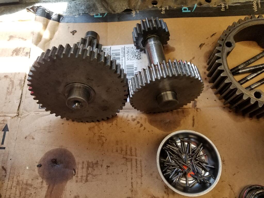

DarrellF 33 #7 Posted May 2, 2020 Here's what I have 1 Share this post Link to post Share on other sites
DarrellF 33 #8 Posted May 4, 2020 (edited) Ok Lowell said he could set me up on all the parts but the 8049 looks like M-16081 time but I can't find any place that has it hmmmm Edited May 5, 2020 by DarrellF Share this post Link to post Share on other sites
"D"- Man 827 #9 Posted May 5, 2020 (edited) On 5/2/2020 at 12:26 PM, DarrellF said: Here's what I have You are one of the few who I know of that has a good parking brake pawl. Edited May 5, 2020 by "D"- Man Share this post Link to post Share on other sites
DarrellF 33 #10 Posted May 5, 2020 This is the closest I can find Koyo M-16121 Needle Roller Bearing, Drawn Cup, Closed End, Open, Inch, 1" ID, 1-1/4" OD, 3/4" Width, 4300rpm got to measure some things 🤔 Share this post Link to post Share on other sites
DarrellF 33 #11 Posted May 5, 2020 59 minutes ago, "D"- Man said: You are one of the few who I know of that has a good parking brake pawl. Ty it's not perfect and I might remove it Share this post Link to post Share on other sites
pfrederi 21,274 #12 Posted May 5, 2020 18 hours ago, DarrellF said: Ty it's not perfect and I might remove it Why looks great to me??? Share this post Link to post Share on other sites
