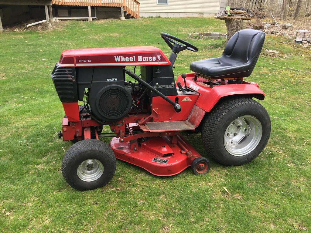

Sparky-(Admin) 26,304 #1 Posted May 1, 2020 Anyone else have a a Magnum continue to run after turning the key to “off”? Like the title says...buzzed around the yard on a 310 with a Kohler Magnum...turned the key to shut it off and it continued to run. Sputtered a bit eventually, then finally stopped running. Before I just go swapping out the ignition switch is there anything else I should be checking out. Maybe shoot some lube in the ignition switch? Could something be sticking in the switch that lube might cure? Share this post Link to post Share on other sites
