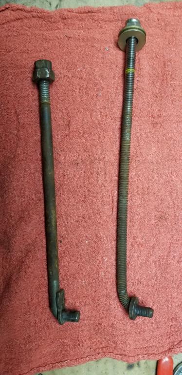

71_Bronco 1,073 #1 Posted April 30, 2020 Now that the summer is coming, I am working on rebuilding my gear-dive mower deck. I just bought all new bearings for it from "Wheel Horse Parts & More". I have 3 decks that I'm stripping down and merging into one, and will have parts left over as spares. One part I cant seem to find, is the adjustable lift rod, part number 6613. It is the "J" shaped rod that connects the deck to the lift-arm-thingy under the dash, and is what lifts the deck when you pull the handle. Not sure if there is a better way to attack this, perhaps a clevis bolt on the lift-arm, a steel cable, and a fixed eye-bolt on the deck? Thanks! Share this post Link to post Share on other sites
gt14rider 1,283 #2 Posted April 30, 2020 Here is the rod, one OEM, second made from threaded rod, heated and bent. Tack welded washer, drill hole for pin, easy peasy 1 Share this post Link to post Share on other sites
