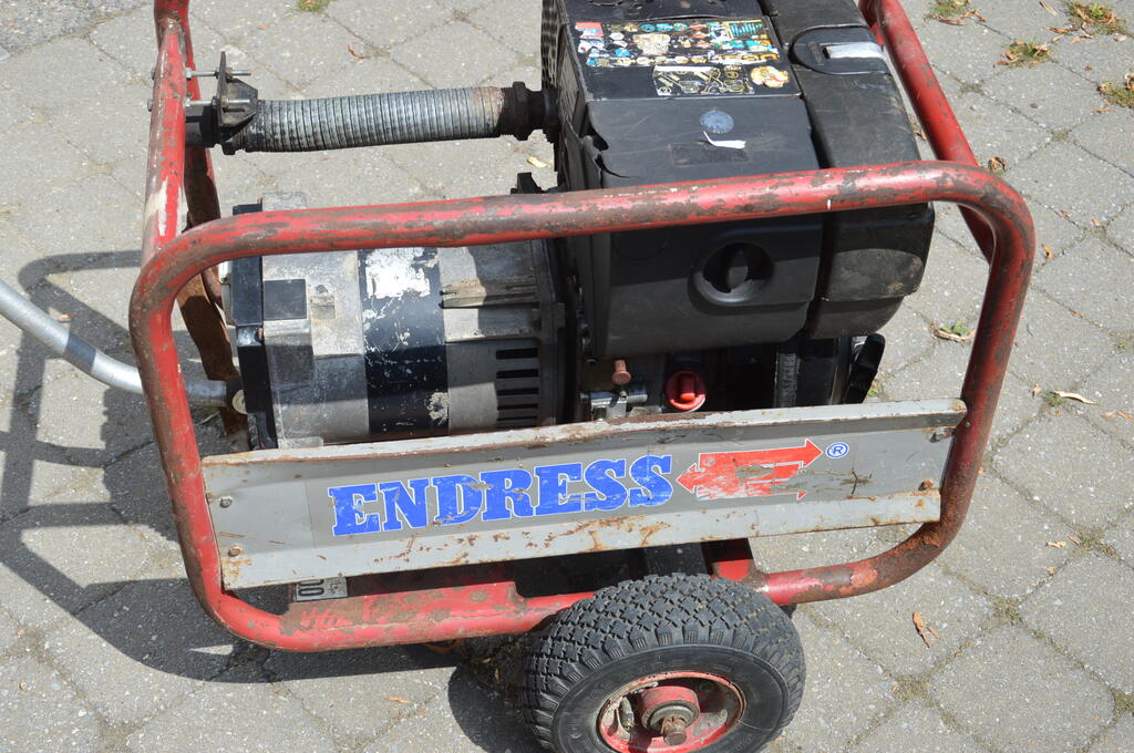

Maxwell-8 4,371 #2307 Posted June 7, 2021 (edited) I changed the oil in my Hatz diesel generator along with a new diesel fuel filter. The surging is gone now. Edited June 7, 2021 by Maxwell-8 3 1 Share this post Link to post Share on other sites

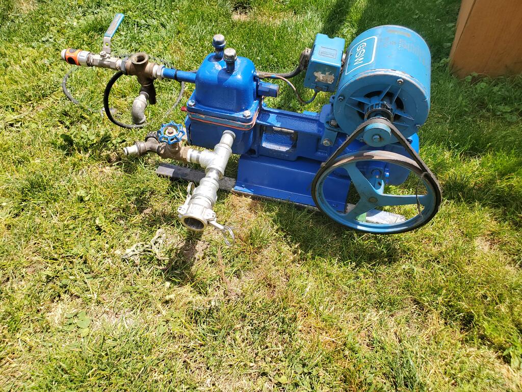

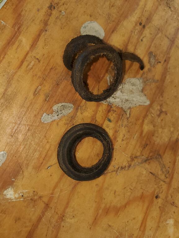

R Scheer 515 #2314 Posted June 8, 2021 I figured since I have a 30 yo tractor, 100 yo air compressor, I might as well refurb my 40 yo water pump. It's only used for lawn/ garden watering, so I've been putting off touching it, visions of brown welded bolts etc. Figures it took about an hour to disassemble, not one seized bolt. Go figure. New leather cups, packing, valves and springs, new gaskets, repair bad seal on motor end, change oil, and new pipe fittings on suction side. One of the old nipples had rusted through. Also cleaned up pump and gave it a rattle can paint job to keep the rust down. Pumps like new. The second picture was of the old leather cups, one looked more like on old leather washer. Further proof old iron is good iron. Ps if you need parts for these pumps, pompco has a great selection of kits.the 1 5 Share this post Link to post Share on other sites

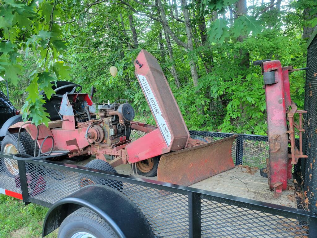

OldWorkHorse 3,153 #2324 Posted June 10, 2021 Bought a plow and it came with a parts tractor. Will see what can save but alot of the body panels going to scrap yard. If I get a working trans even if it needs seals and a set of rims I've made more then my investment back 4 Share this post Link to post Share on other sites
