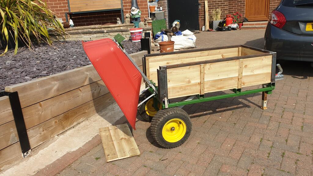

Mickwhitt 5,259 #1756 Posted April 19, 2021 Decided to modify the little flat bed trailer i made for Fred. It needs sides on it so I've welded some angle and tube up to create a frame for a wooden box. I will make a tailgate too so I can get long stuff in there. Once the wood is in I will take some snaps. Mick 1 Share this post Link to post Share on other sites

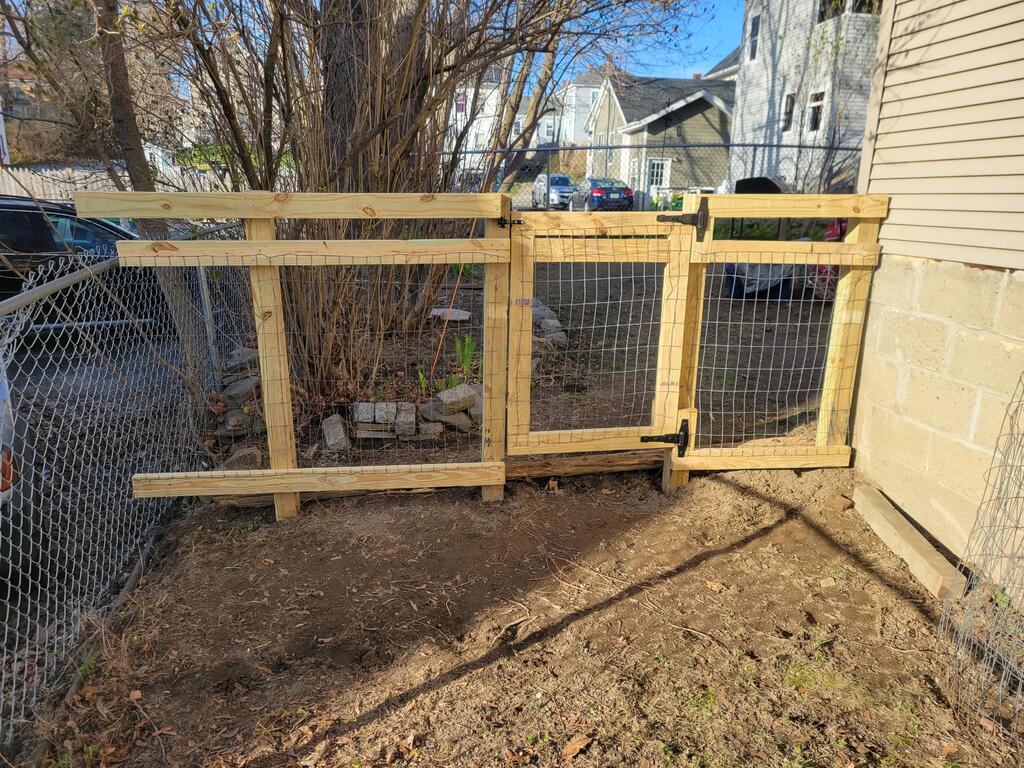

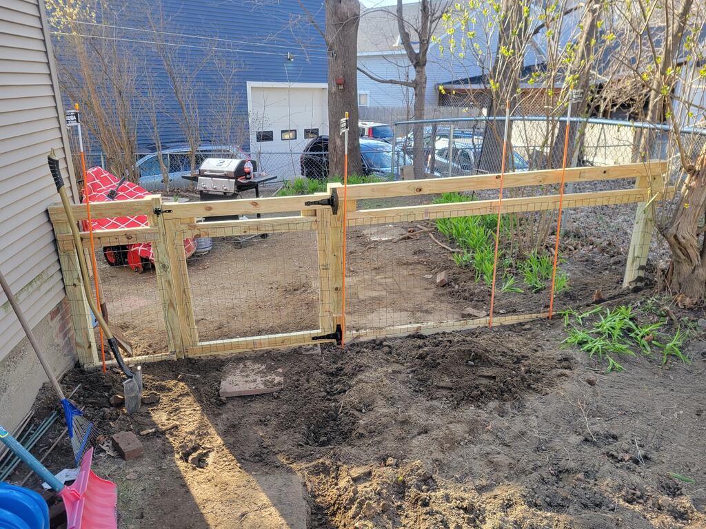

OldWorkHorse 3,156 #1757 Posted April 19, 2021 Built a fence at my mom and dad's house so the dog can roam the land. Made it from pressure treated gold too. 2 Share this post Link to post Share on other sites

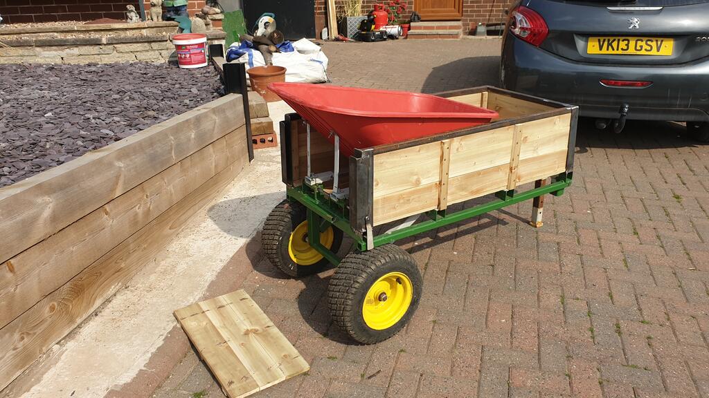

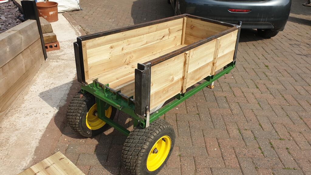

Mickwhitt 5,259 #1764 Posted April 20, 2021 Really warm spring day here, perfect for some outdoor welding and fabricating on my box trailer. I welded the basic frame on yesterday and went to the wood yard first thing for some timber to line it. Turns out fence palings were perfect, ready cut and treated. Just over a pound each I bought 20 and set about cutting and fitting.So a basic box shaped body made of 4 inch by 5/8 inch timber lengths. That way if one gets broken its easier to repair than sheet material. Its probably not as heavy duty as some would like but its only for tools and such like. I made a slide in tailgate. It didn't need hinges so it used angle iron to make slots on each corner upright into which my rear door slides. I wanted to retain the tipping wheelbarrow body that I had made and so made sure it would work on its current hinge system with the body sides in place. All in all it looks ok and works well. Just a bit of red paint to be splashed around tomorrow and it will look just the part. Next question is should I take off the fixed axle and fit rubber suspension arms so I can used it with my car? 6 1 Share this post Link to post Share on other sites

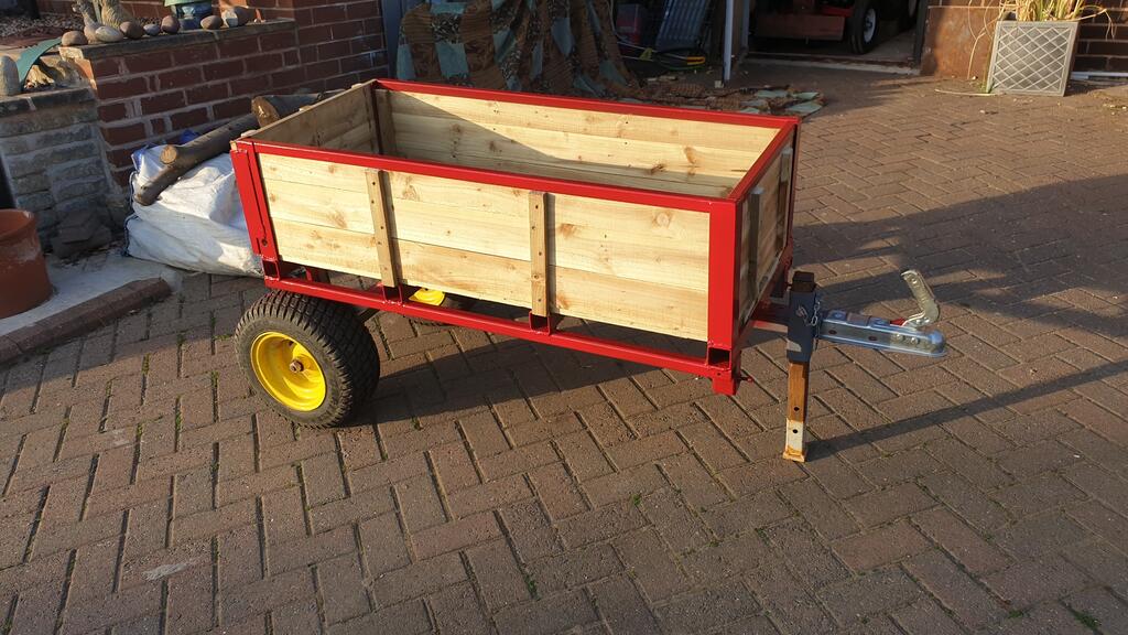

Mickwhitt 5,259 #1771 Posted April 21, 2021 This is the trailer in primer grey. Fitted on the tow ball of the car it seems to be at the right height and should benefit from a suspension upgrade. 2 Share this post Link to post Share on other sites
Mickwhitt 5,259 #1772 Posted April 21, 2021 Broke out the spray gun and shot a coat of red over the primer. Doesn't have to be anything special for this working trailer. 2 3 Share this post Link to post Share on other sites
