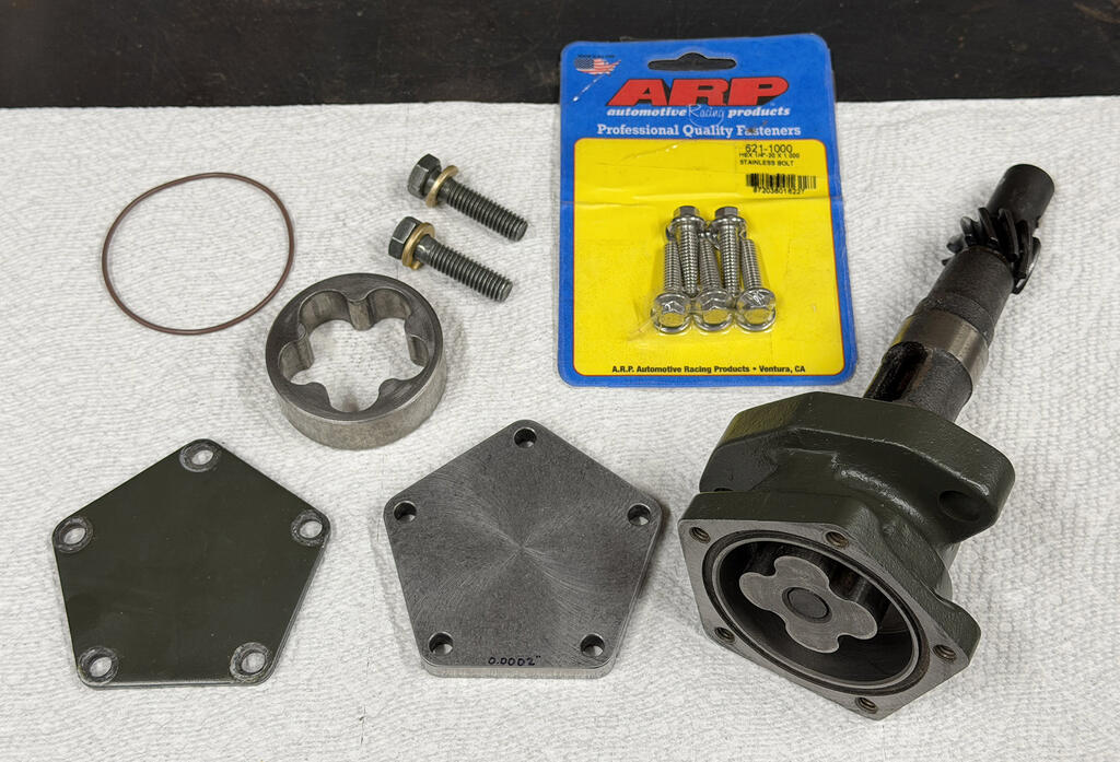

This pump has the cloverleaf-style rotors, which should put out about 10% more volume than the star-type rotors for this engine, according to what I've read.
I purchased a custom oil pump cover plate from Tony Smith that is flat within .0002" and thicker and more rigid than the original plate (original plate shown to the left of the new plate), along with a set of ARP bolts and washers of the appropriate length for use with the thicker plate. I gave the rotors and the end of the pump a very light dressing with a diamond hone plate, just to remove any high spots, and I ended up with .002" of end play, which should be about right. As with almost anything that I assemble, I cleaned the threads in the pump casting with a thread-chasing tool, solvent, and compressed air.
oil-pump-parts-and-new-cover-plate-smaller-image.jpg.1754d316a40c5ce56052ea93ddfd62e8.jpg

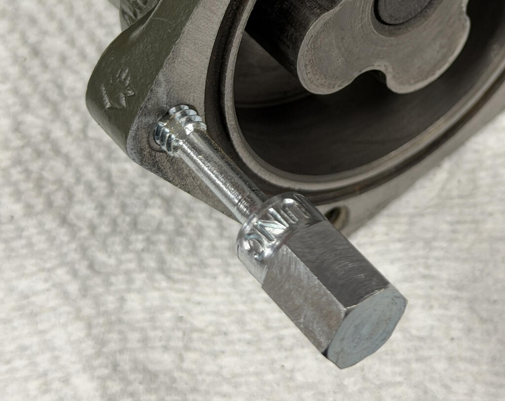

I'm also considering drilling an oil hole near the top of the casting to improve lubrication to the shaft. I'll try it first on the NOS pump to make sure it goes smoothly before doing it to the pump that I'll be installing.
As mentioned, I'm also planning to convert the engine to full-flow oil filtration, and I'll be using the 'green' (heavy) spring in the pressure relief valve. I might even consider converting the pressure relief valve to an adjustable version, which I've done with a couple of antique tractor engines.
The pump will be completely filled/flooded with lubricant prior to final assembly, as it's a bad idea to run these pumps dry, even for a few seconds.

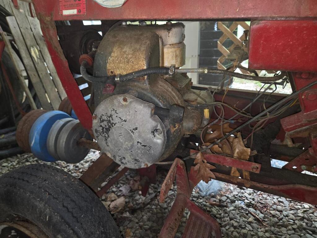

came across a couple oldies today -- inlcuding an old horse - I have little knowledge of the early era models - What is this Tractor? - -
Also found this belly grader under a 416 horse - is grader OEM ? Hopefully, I will get a better view in the future of both the oldie model tractor as well as the grader blade -- but in the mean time, any preliminary info would be appreciated ? Also, hoping to establish their approximate value ? thanks, Bill
Engine has bee swapped.
Tractor appears to be late 60s/ early 70s like a Raider or Charger.

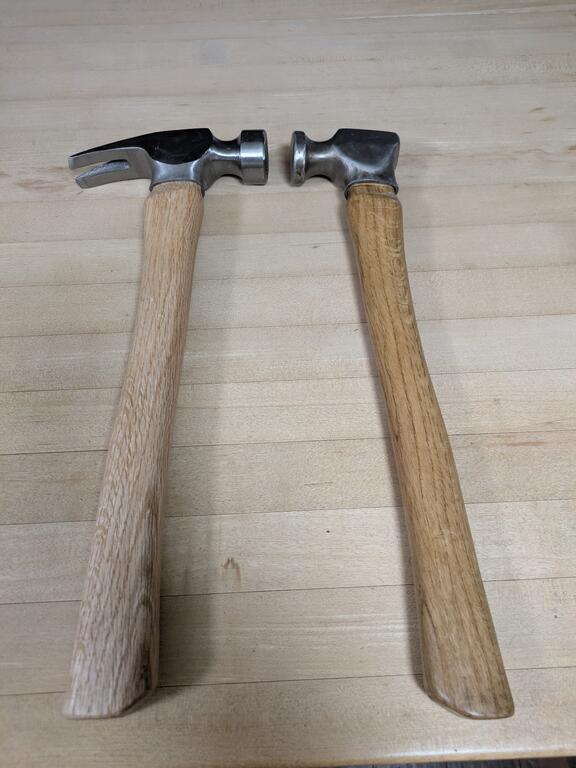

Finally I can load pictures again. Pictured here are two Pittsburgh Harbor Freight hammers. One has been heavily modified to reduce weight. The hickory handle they come with is hidden under some kind of ccc lacquer so I  let the wood out to breathe in some Danish Oil.  Big improvement..
   I can drive nails faster with the aprox. eighteen ounce head than with the original 24. Both hammers bought new were only fourteen dollars combined so I can afford having a little fun with them.

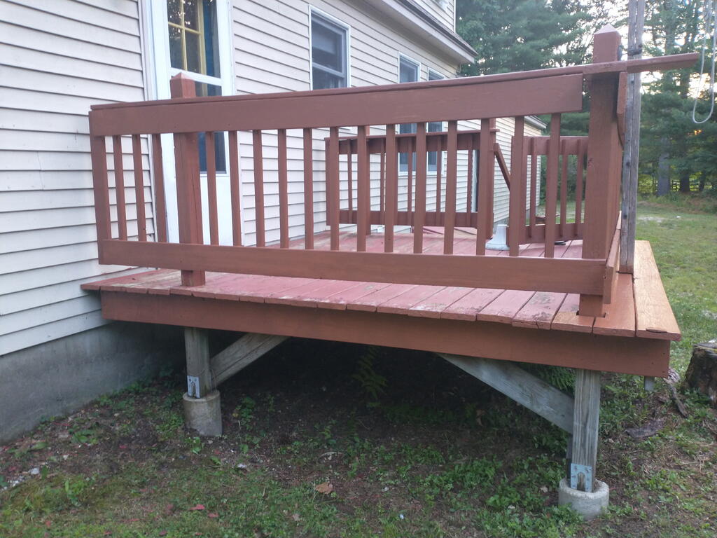

Down to Massachusetts helping my mom for a day.
Trina pressure washed the entire back deck.
Scraped the old paint off.
Repeat.
Repeat.
Then...
Removed the chicken wire that stapled all over the inside to keep the former dog in.
I added a few screws to the ballusters.
We replaced a post off the back steps.
Then Trina painted ALL of the vertical parts and rails and ballusters.
Inside. Outside. Steps. New. Old. Completed, not like it used to be - half covered.
Tomorrow morning she's intending to paint the deck surface.
