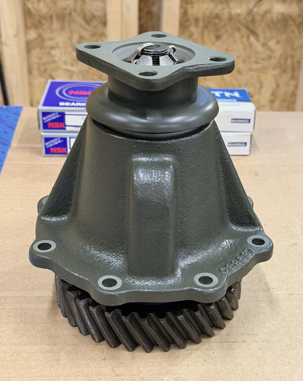

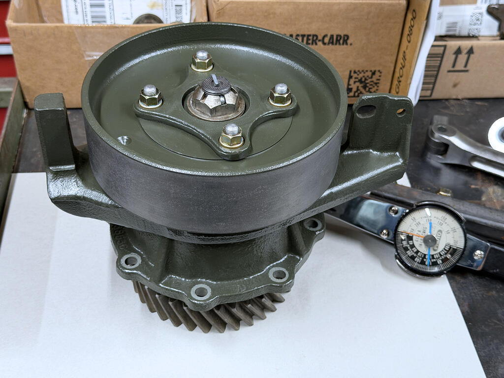

Blue Chips 881 #9779 Posted June 29 I'm still messing about with a pile of connecting rods, trying to come up with the best possible set of six for the machine shop to rework to what I hope will be better-than-new condition. I have a few more coming soon. Today I finished reassembling two sections of the my M37's transfer case. It took several shim adjustments per the procedure in the manual to come up with the proper preload on the tapered roller bearing sets. With the companion flange nut torqued to 140-160 ft-lb the preload should be between 15 and 30 in-lb (without the seal in place). I managed to adjust them both to exactly 24 in-lbs, figuring that since they are new bearings, I'd go just a bit above the mid-point, but still well within the target range, to allow for some slight break-in (and I corrected an obvious mistake in the manual while I was at it ). 3 Share this post Link to post Share on other sites

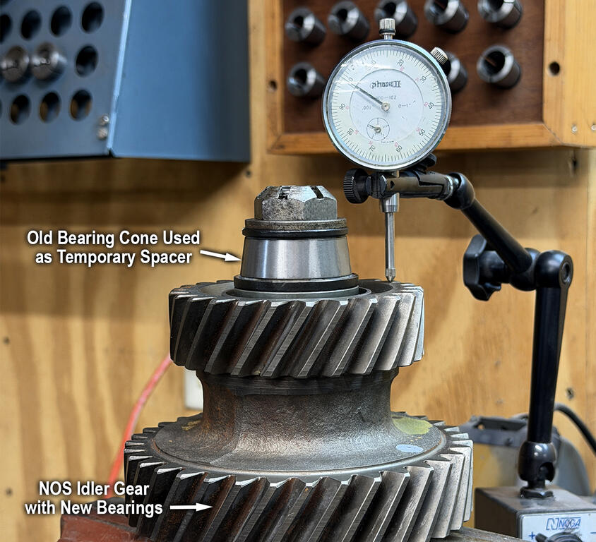

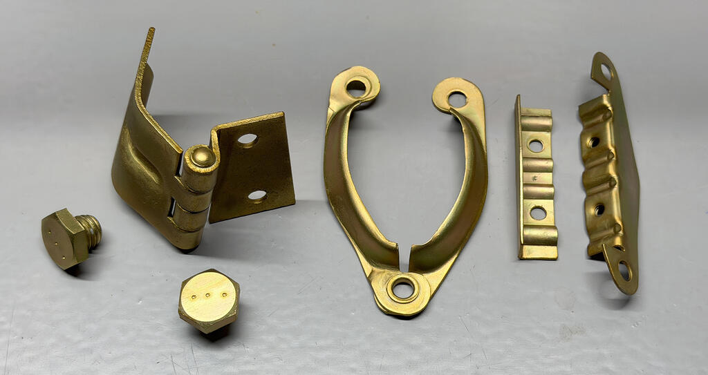

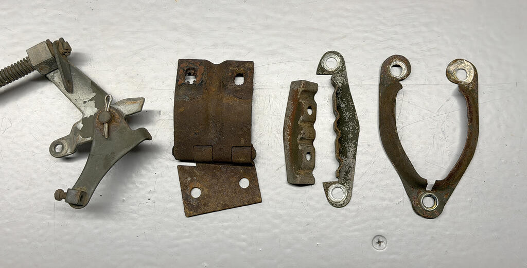

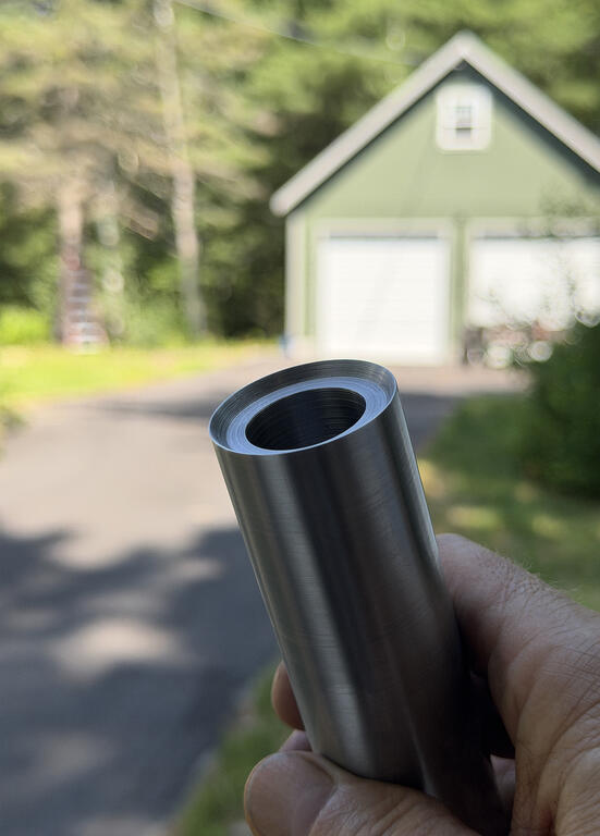

Blue Chips 881 #9782 Posted July 1 I zinc plated a few more of my Dodge M37 parts yesterday. Before: After: Set up the bearings for the transfer case idler gear: Made an arbor tool on the lathe this morning, which will be used to guide the transfer case idler gear shaft into the case and through the bearings and shims, while keeping the shaft straight relative to the case and preventing the shaft from catching on and damaging the adjustment shims as it passes through the gear. 2 4 Share this post Link to post Share on other sites

Handy Don 17,735 #9789 Posted July 2 21 hours ago, Blue Chips said: Assembly tools are underrated because they are uncommon outside of production lines. A couple years ago @ri702bill made me a manufacturer-spec tool for pressing in the bearings and seals during my gear mowing deck rebuild. Worked so well I was a bit disappointed at how quickly I finished the job! 2 2 Share this post Link to post Share on other sites

Blue Chips 881 #9798 Posted July 2 3 hours ago, Handy Don said: Assembly tools are underrated because they are uncommon outside of production lines. A couple years ago @ri702bill made me a manufacturer-spec tool for pressing in the bearings and seals during my gear mowing deck rebuild. Worked so well I was a bit disappointed at how quickly I finished the job! Yes, sometimes one can spend more time and do more damage by trying to "make do" with existing tools than the time or money spent to make or buy the right tool. A lot of auto parts stores loan tools for free these days, including some specialized tools for servicing newer or popular vehicles, but I'm always running into situations when working on an old vehicle or machine where I need some oddball gadget to finish the job properly. I don't consider myself a great machinist, welder, or fabricator, but I can usually cobble together something that gets the job done correctly. Antique vehicles tend to be simpler in most respects than newer models, especially when it comes to electronics and electro-mechanical devices, but they still had their share of proprietary designs that required special tools. For example, I have a couple of boxes of special Carter carburetor tools---probably over a hundred items---and I still don't have all of the Carter tools. For general maintenance work on my 1954 M37, the manuals list 35 special tools in addition to the standard array of tools that a mechanic would have been expected to have at the time. I've either purchased or made several of them, and in some cases I've been able to substitute another tool to do the job, but it sure makes a difference when you have the right tool for the job. 2 Share this post Link to post Share on other sites
