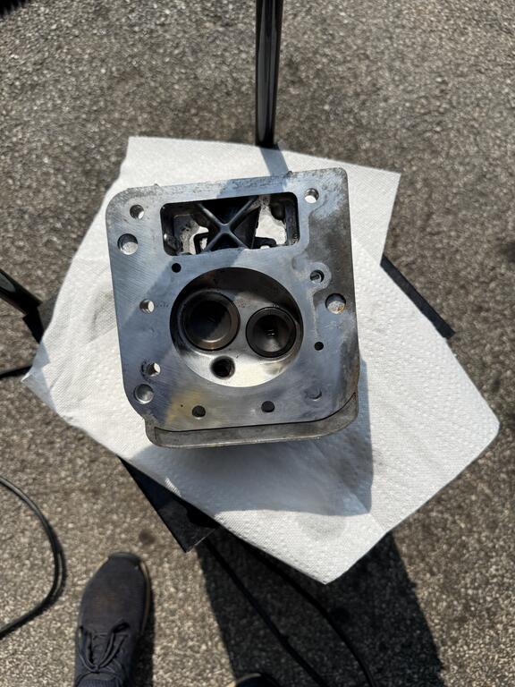

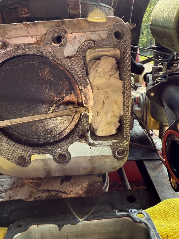

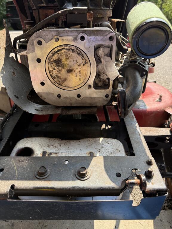

nylyon-(Admin) 9,196 #8306 Posted June 11, 2025 My neighbor asked for help, he said the engine on his craftsman was blown and needed a tractor. I was able to get a nice Workhorse Automatic off of a member here and helped haul it from Mass. to NY for my him. Anyway, the “blown” engine was a Briggs Intek OHV which was burning a LOT of oil. Told my neighbor I would take the craftsman for him, here’s what I found, from what I hear, it’s pretty common: Got everything all cleaned up, new gasket and runs great now! 9 Share this post Link to post Share on other sites
SylvanLakeWH 32,921 #8307 Posted June 11, 2025 My brother had exact same problem... Share this post Link to post Share on other sites
lynnmor 9,081 #8308 Posted June 11, 2025 BTDT on a 17.5 B&S. Just look at the distance the head bolts are apart at that point. What could possibly go wrong? It is a good idea to flatten the head, they warp as well from the stupid design. Share this post Link to post Share on other sites

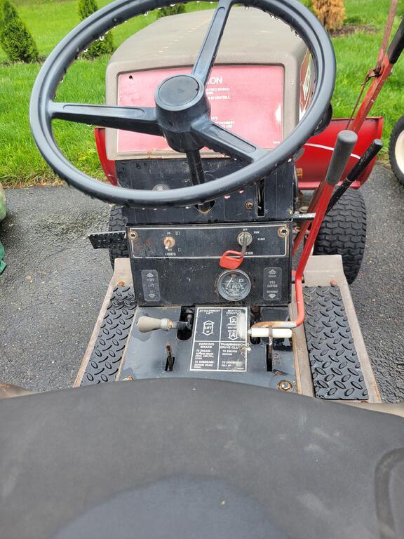

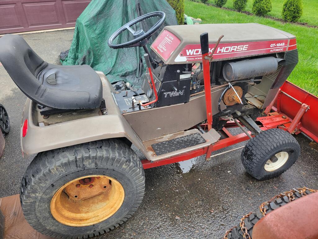

nylyon-(Admin) 9,196 #8310 Posted June 11, 2025 No plow and the PTO was reinstalled. Eaton 1100, with Kohler Magnum 10hp 4 2 Share this post Link to post Share on other sites
Sparky-(Admin) 26,898 #8311 Posted June 11, 2025 6 minutes ago, nylyon said: No plow and the PTO was reinstalled. Eaton 1100, with Kohler Magnum 10hp Decent looking rig! 1 Share this post Link to post Share on other sites
adsm08 5,247 #8312 Posted June 11, 2025 7 hours ago, nylyon said: My neighbor asked for help, he said the engine on his craftsman was blown and needed a tractor. I was able to get a nice Workhorse Automatic off of a member here and helped haul it from Mass. to NY for my him. Anyway, the “blown” engine was a Briggs Intek OHV which was burning a LOT of oil. Told my neighbor I would take the craftsman for him, here’s what I found, from what I hear, it’s pretty common: Got everything all cleaned up, new gasket and runs great now! It's common to find paper towels stuffed in the intake runner? 3 Share this post Link to post Share on other sites
nylyon-(Admin) 9,196 #8313 Posted June 11, 2025 2 minutes ago, adsm08 said: It's common to find paper towels stuffed in the intake runner? Haha, only when I put them in there. That is actually the passage to the block that the push rods go through. When the head gasket goes bad, that is where is sucks oil into the cylinder and super pressurizes the crankcase. 3 Share this post Link to post Share on other sites
adsm08 5,247 #8314 Posted June 11, 2025 Just now, nylyon said: Haha, only when I put them in there. That is actually the passage to the block that the push rods go through. When the head gasket goes bad, that is where is sucks oil into the cylinder and super pressurizes the crankcase. Reminds me of when I started my first job at the dealership. The one guy was doing the intake on his own truck for the second time that week. I didn't see the first time, but I'm told he did the intake gaskets, hit the key, and it just wouldn't start. He forgot to pull the rags out of the runners. 4 Share this post Link to post Share on other sites

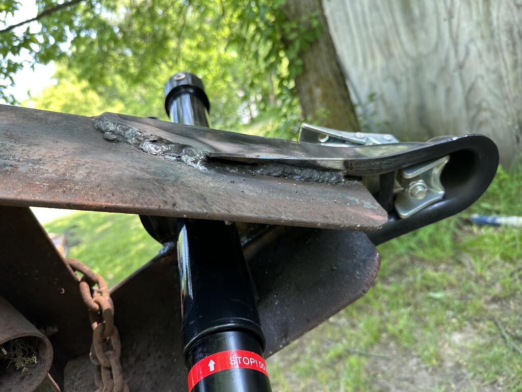

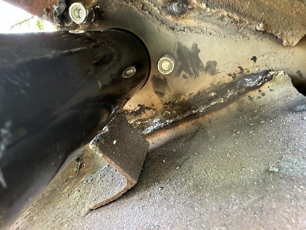

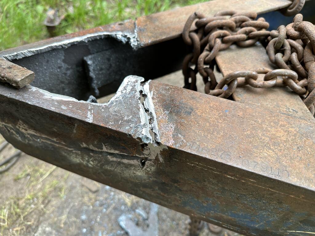

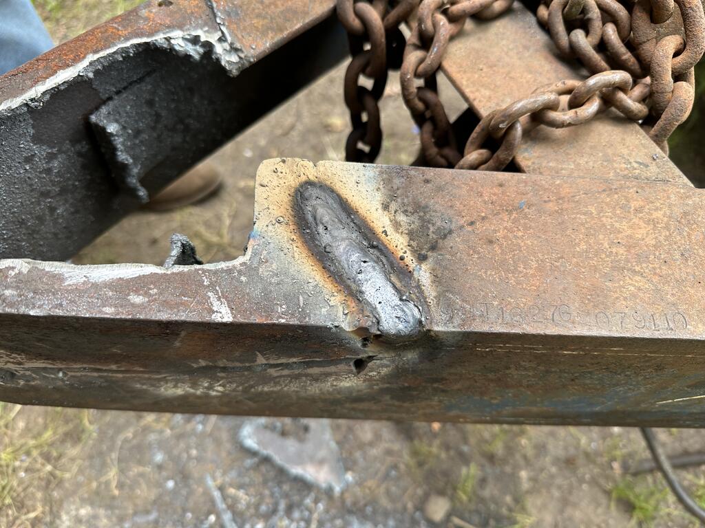

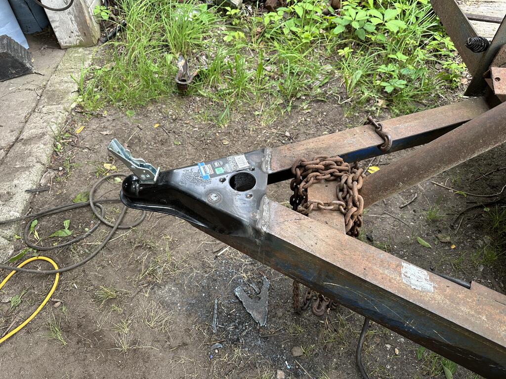

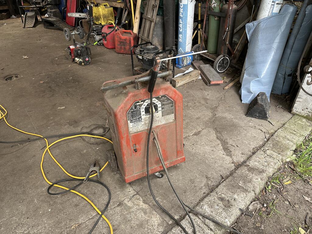

Pullstart 71,561 #8320 Posted June 13, 2025 The grandparents have been keeping me quite busy lately. Mrs. P was out of town for work M-W this week and I was supposed to be doing a last shop push to get Big Show ready. One grandpa had open heart surgery this week, and I visited in the hospital a bit with him. He likes tractors and hot rods. We had lots to talk about. Another grandpa had a RR wheel bearing and axle seal go bad on his truck. That became a fiasco, when we found the tone ring for the ABS to be torn up inside the axle tube as well. The third grandpa, had the latch on his trailer break. Before I could get there to inspect, he had removed the latch assembly with the hot wrench. I cleaned up some of the tongue, and got to work with the ole’ buzz box and some 6011 rod. It’s been 20 years or so since I stick welded. It was a chore, but became more fun as I went. I returned home with a full belly and some big C-clamps! 3 3 2 Share this post Link to post Share on other sites

953 nut 70,649 #8322 Posted June 13, 2025 6 minutes ago, Pullstart said: got to work with the ole’ buzz box and some 6011 rod. It’s been 20 years or so since I stick welded. It was a chore, but became more fun as I went 9 minutes ago, Pullstart said: The grandparents have been keeping me quite busy lately. You are a good man Kevin. I have a good MIG but the Lincoln Buzz Box is my go to. 5 Share this post Link to post Share on other sites
