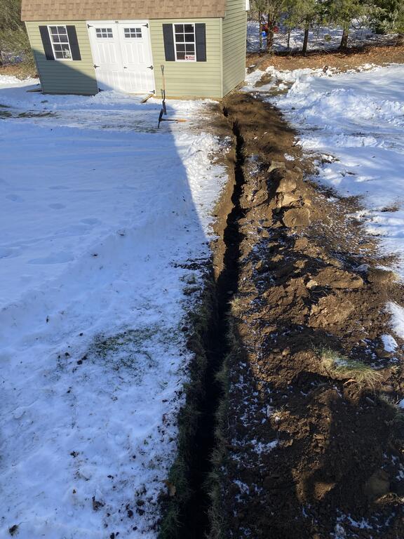

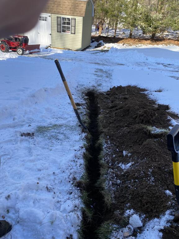

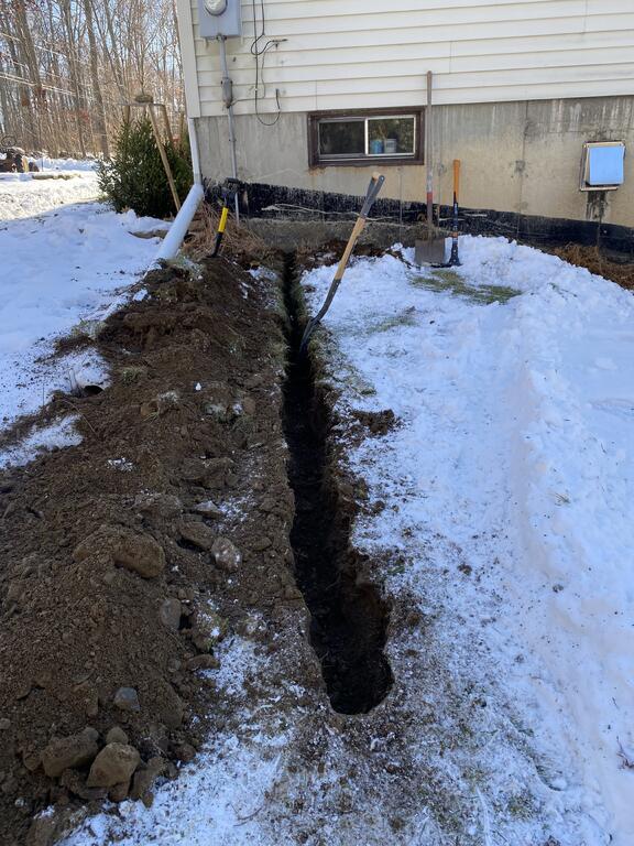

Sparky-(Admin) 26,514 #7452 Posted December 7, 2024 Started digging the trench from house to shed for power. Typical of me…I waited to long and now I’m fighting with a couple inches of frozen ground. Having to pick-axe my way thru the top layer, then shovel it out. 6 Share this post Link to post Share on other sites

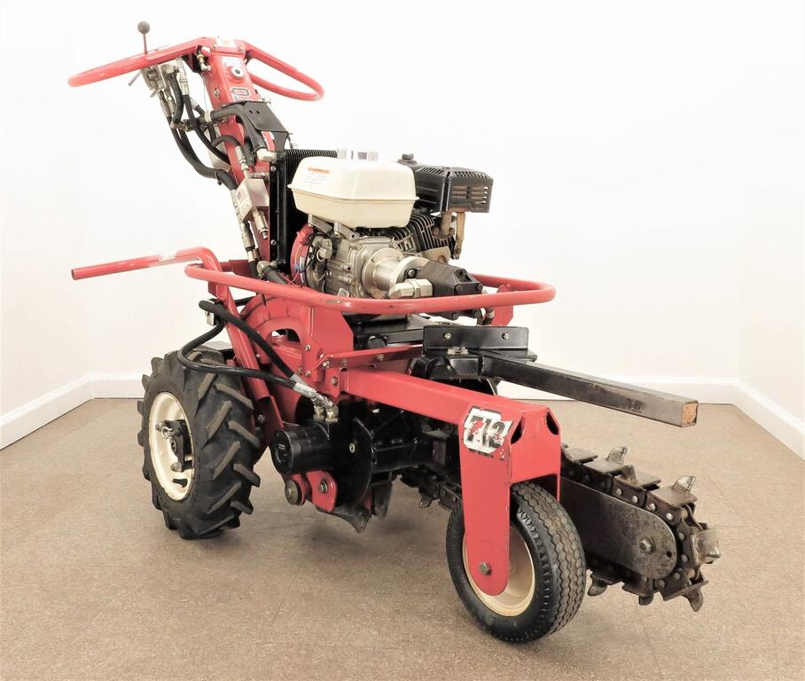

Brockport Bill 2,483 #7453 Posted December 8, 2024 You can rent cheap a trench digger from Home Depot 3 Share this post Link to post Share on other sites
wallfish 20,679 #7454 Posted December 8, 2024 13 minutes ago, Sparky said: Started digging the trench from house to shed for power. Typical of me…I waited to long and now I’m fighting with a couple inches of frozen ground. Having to pick-axe my way thru the top layer, then shovel it out. My offer to run the trencher for it still stands. $0 They rent the same one at Home Depot and it's only $125 for 4 hours. It will take you longer to pick it up and bring it back to the store than it will to cut that trench. Maybe 10 minutes for that short run 4 Share this post Link to post Share on other sites

Sparky-(Admin) 26,514 #7464 Posted December 8, 2024 53 minutes ago, 953 nut said: You all seem to forget that Mike @Sparky is one of those exercise nuts. Haven't you seen his bike trip posts he rides from point A to point A, never gets anywhere but loves it. More power to him. National electric code only requires 24", who was running that job? Thanks! My bike has been hung up for the winter so that 45’ long trench is all the exersize I’ll get for awhile. Here they want to see 18” depth if using conduit which I am. Hope ya’ll can keep a secret, this trench is more like 12-14” deep 1 1 Share this post Link to post Share on other sites

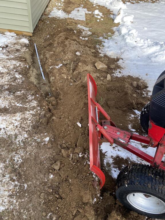

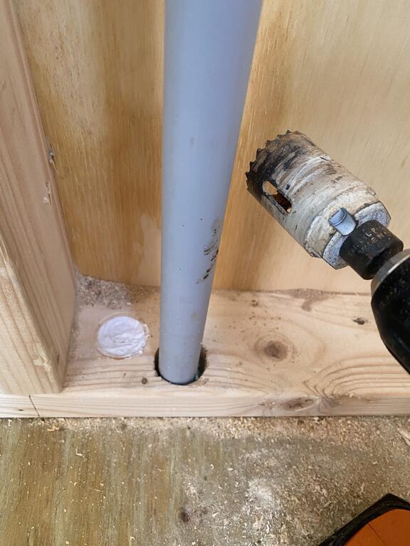

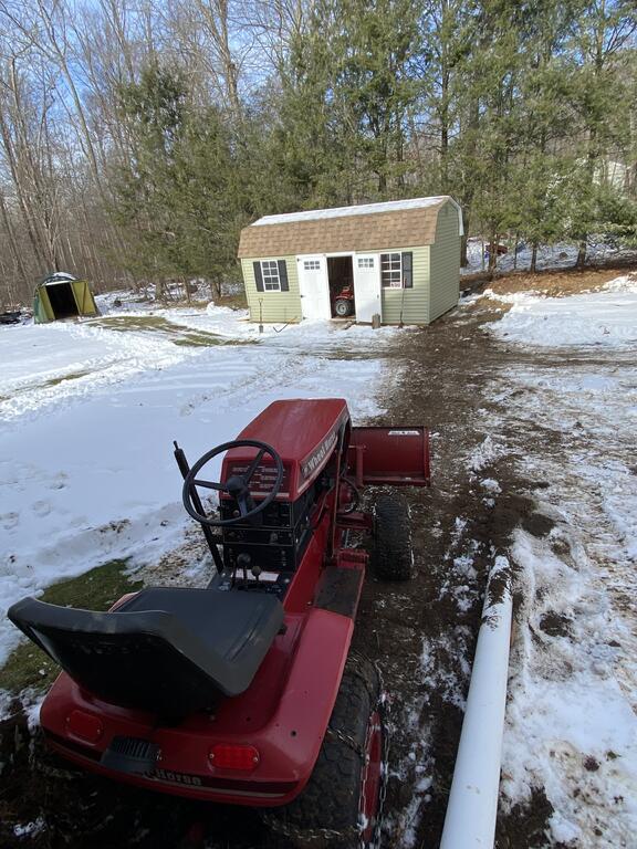

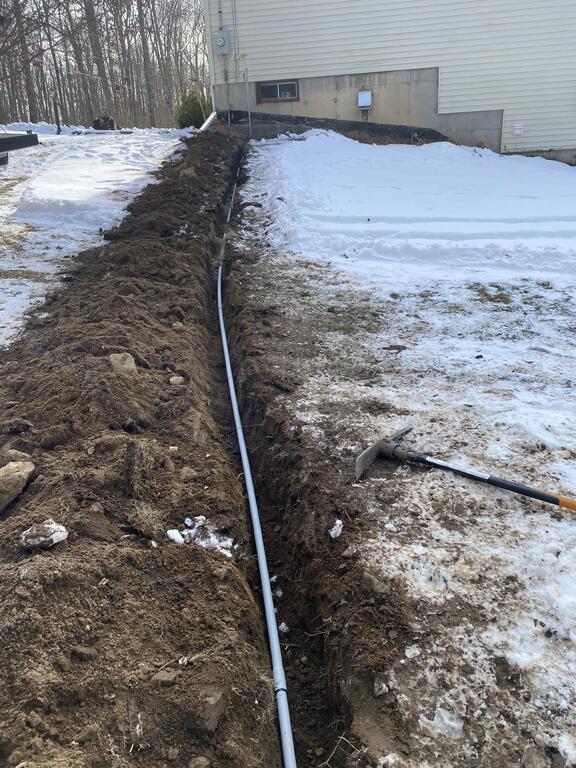

Sparky-(Admin) 26,514 #7468 Posted December 8, 2024 Finished the trench and got the conduit in! Screwed up the first hole thru the shed floor Backfilling was much more fun that digging! The 308-8 with a 42” blade, 75#’s on each rear tire plus 4 link chains made that task fast and easy. This spring I’ll have to level and seed it. 6 Share this post Link to post Share on other sites
