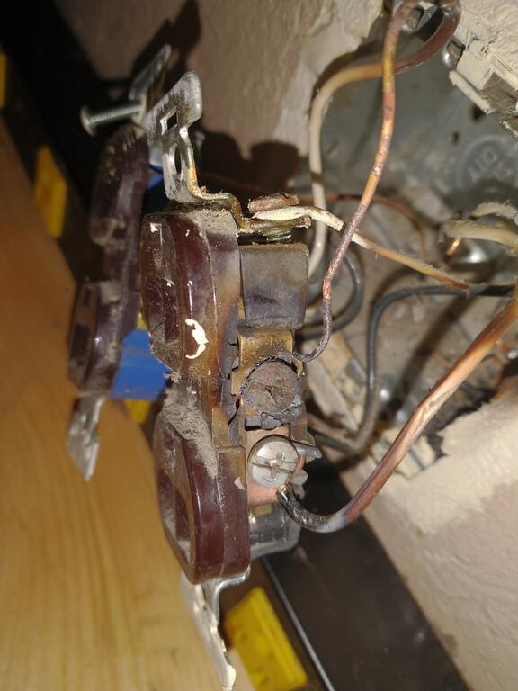

lynnmor 9,081 #6578 Posted February 24, 2024 (edited) 19 hours ago, squonk said: wife called Tues whilst I was at work. Dryer quit working. She tried another plug and got it done. Today was spent at the outlet! I see a photo of a failed 120 volt receptacle, not a plug. A clothes dryer would use a 240 volt receptacle. Was it a hair dryer? Just wondering about the actual failure. Edited February 24, 2024 by lynnmor Share this post Link to post Share on other sites

squonk 48,428 #6580 Posted February 24, 2024 (edited) 29 minutes ago, lynnmor said: I see a photo of a failed 120 volt receptacle, not a plug. A clothes dryer would use a 240 volt receptacle. Was it a hair dryer? Just wondering about the actual failure. Gas Dryer. Dryer rated at 6 AMPS. Inrush at start up (centrifugal switch engaged ) is 36 amps for 1 second. Amp draw with igniter activated is 7.1 Amps and when just the tumbler motor 4.4 Amps Edited February 24, 2024 by squonk 2 Share this post Link to post Share on other sites
ebinmaine 81,282 #6581 Posted February 24, 2024 10 minutes ago, squonk said: Gas Dryer. Dryer rated at 6 AMPS. Inrush at start up (centrifugal switch engaged ) is 36 amps for 1 second. What size breaker do you use for that?? Share this post Link to post Share on other sites
Ed Kennell 47,950 #6582 Posted February 24, 2024 10 minutes ago, squonk said: 36 amps for 1 second Ya think that was enough to smoke it, or was it a bad connection? Share this post Link to post Share on other sites
squonk 48,428 #6583 Posted February 24, 2024 (edited) 9 minutes ago, ebinmaine said: What size breaker do you use for that?? 15 Amp circuit 8 minutes ago, Ed Kennell said: Ya think that was enough to smoke it, or was it a bad connection? Sure it was either a bad connection or worn out recep. I installed this about 30 yrs. ago. Old house. When the front load washer has an unbalanced load it shakes the floor pretty good and of course the wall. All of that bouncing around takes it's toll. I don't remember what grade recep I used way back then but I used to top level HD grade on the repair. Funny story about the word Receptacle. Years ago at work our electrician was looking at paper work from a Grainger order we just got. He says " This invoice says 10 black receptacles came in. I didn't order any. Where are they? " I pointed behind him to the stack of 10 black trash cans the grounds crew ordered! Edited February 24, 2024 by squonk 1 4 Share this post Link to post Share on other sites
squonk 48,428 #6584 Posted February 24, 2024 Checked the outlet and plug with it not running with a laser thermometer 71° After 10 minutes of run time 73° 1 1 Share this post Link to post Share on other sites
ebinmaine 81,282 #6585 Posted February 24, 2024 2 minutes ago, squonk said: Checked the outlet and plug with it not running with a laser thermometer 71° After 10 minutes of run time 73° Thats a wee bit better Share this post Link to post Share on other sites
