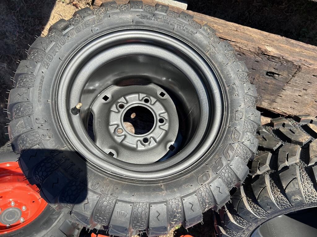

19richie66 17,932 #5009 Posted December 1, 2022 41 minutes ago, sjoemie himself said: That's looking really sweet. I like the color @Snoopy11 you seeing this?? This is the color I was talking about It is charcoal metallic Rustoleum. Almost the same as my gt14 wheels. These are painted with PPG Umbra grey metallic (Ford mustang color) 5 Share this post Link to post Share on other sites

19richie66 17,932 #5013 Posted December 2, 2022 2 hours ago, PeacemakerJack said: Zachman has decided after riding Skittles that he wants to paint his wheels on Blackbeard the same color…😎 I’m glad they got to do some driving while you guys were here. I plan on painting Karen’s wheels the same color and maybe even the D. I like the color as it’s not plain and I think it’s a nice contrast to the red and black. Just my preference. 3 Share this post Link to post Share on other sites
sjoemie himself 3,186 #5014 Posted December 2, 2022 (edited) 9 hours ago, 19richie66 said: It is charcoal metallic Rustoleum/PPG Umbra grey metallic (Ford mustang color) Thanks for the info. The Mustang color also looks delicious Very nice set of wheels. Think I'm gonna do a similar color on the 512-D wheels once I get to restoring that. Edited December 2, 2022 by sjoemie himself Added info 1 Share this post Link to post Share on other sites
19richie66 17,932 #5015 Posted December 2, 2022 4 hours ago, sjoemie himself said: Thanks for the info. The Mustang color also looks delicious Very nice set of wheels. Think I'm gonna do a similar color on the 512-D wheels once I get to restoring that. Thank you. These were blank shells and I had the centers cut out of 3/8” steel plate. Kinda hefty too. I like the later model color combos 👍 3 Share this post Link to post Share on other sites

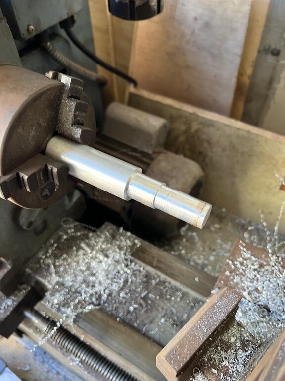

19richie66 17,932 #5016 Posted December 2, 2022 (edited) Made an adapter to make an adapter Making a coupler to mount an Eaton hydro to a D200 flex joint. Had to make a 3/4” down to 5/8 spindle to keep the center straight. Hairbrained idea but stay with me……. Edited December 2, 2022 by 19richie66 8 1 Share this post Link to post Share on other sites
8ntruck 9,254 #5017 Posted December 2, 2022 (edited) I have been wondering if there are some industrial couplers that would replace the Wheel Horse part in this application. LoveJoy is a brand that comes to mind. If I remember correctly, thay are a modular system that allows you to mix and match parts to match the shaft sizes in the application. The curve ball here is the splined input shaft on the pump. Edited December 2, 2022 by 8ntruck 3 Share this post Link to post Share on other sites
19richie66 17,932 #5018 Posted December 2, 2022 (edited) 7 minutes ago, 8ntruck said: I have been wondering if there are some industrial couplers that would replace the Wheel Horse part in this application. LoveJoy is a brand that comes to mind. If I remember correctly, thay are a modular system that allows you to mix and match parts to match the shaft sizes in the application. The curve ball here is the spliced input shaft on the pump. This pump uses a 3/4” keyed shaft, not splines like the sunstrand. This Eaton transmission will have the axle tubes cut off of it and sealed up. The transmission will be turned sideways and a drive will be made off of the brake shaft. There is a powerking 3 speed and a Panzer tractor axle in the mix also. If I make this work, there will be a splined coupler for sale There is a guy on Youtube that used a manual wheelhorse transmission this way in his home brewed tractor. I just won’t have to deal with a clutch as mine will be hydrostatic. Edited December 2, 2022 by 19richie66 1 3 Share this post Link to post Share on other sites
8ntruck 9,254 #5019 Posted December 2, 2022 Sounds interesting. Going to post some pictures? 1 Share this post Link to post Share on other sites
ebinmaine 80,485 #5020 Posted December 2, 2022 17 minutes ago, 19richie66 said: WHEN I make this work, Looking forward to seeing this. I've seen the video of the Horse transmitted homemade rig. Neat work. 2 Share this post Link to post Share on other sites
19richie66 17,932 #5021 Posted December 2, 2022 1 hour ago, 8ntruck said: Sounds interesting. Going to post some pictures? It’s going in here. Going to stick out the side a little but won’t be too bad. I was going to wait till I got it mostly figured out to do a build thread as I don’t want to curse myself 2 Share this post Link to post Share on other sites

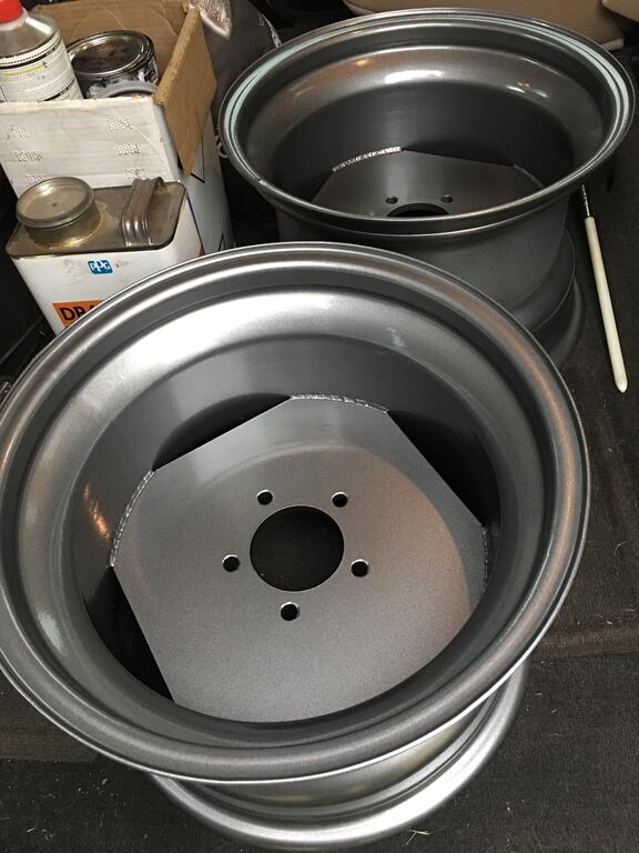

sjoemie himself 3,186 #5022 Posted December 2, 2022 7 hours ago, 19richie66 said: These were blank shells and I had the centers cut out of 3/8” steel plat Very nice. Any 'dish' in the center plates or just flat plate? They seem bigger than 12" diameter, are they 15" x 10"? 1 Share this post Link to post Share on other sites
19richie66 17,932 #5023 Posted December 2, 2022 10 minutes ago, sjoemie himself said: Very nice. Any 'dish' in the center plates or just flat plate? They seem bigger than 12" diameter, are they 15" x 10"? They are 15x10 with 3.5” backspace. The center plates are flat. 1 Share this post Link to post Share on other sites
8ntruck 9,254 #5024 Posted December 3, 2022 (edited) given the low speed, low load application, they should be fine. Still, keep an eye on the lug nut holes and the ends of the welds for cracks after you start using them. Observations and comments from someone who spent a 40 year engineering career in the steel wheel industry. Edited December 3, 2022 by 8ntruck 1 1 1 Share this post Link to post Share on other sites
19richie66 17,932 #5025 Posted December 3, 2022 43 minutes ago, 8ntruck said: given the low speed, low load application, they should be fine. Still, keep an eye on the lug nut holes and the ends of the welds for cracks after you start using them. Observations and comments from someone who spent a 40 year engineering career in the steel wheel industry. Appreciate it. I mig welded them in on the backside and had my son tig the rest of the way around. They are overkill compared to the factory wheels and i will never overwork them. 👍 1 Share this post Link to post Share on other sites
