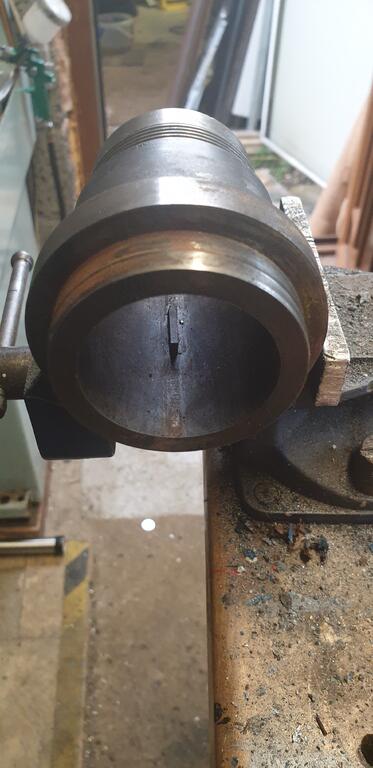

Mickwhitt 5,259 #2779 Posted August 2, 2021 If you could find a cop anywhere near a bridleway you would then have to hope he knew the law in relation to them and that he gave enough of a toss to do something about it lol. Got the grindstone separated from its hub. Lot of huffing and puffing involved but I got it split. There is a drive key wedged into that slot and I will make one thats 3/16 thick not the 1/16 that's left of the old one. 3 Share this post Link to post Share on other sites

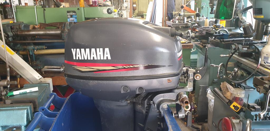

Mickwhitt 5,259 #2781 Posted August 2, 2021 What am I doing? A guy asked if I could have a look at his outboard motor which is not running right. I'm just going to clean the carb and if that doesn't cure it he will have to find a proper marine mechanic. Can't get involved in learning another skill set. 1 3 Share this post Link to post Share on other sites
Dan.gerous 2,696 #2782 Posted August 2, 2021 24 minutes ago, Mickwhitt said: What am I doing? A guy asked if I could have a look at his outboard motor which is not running right. I'm just going to clean the carb and if that doesn't cure it he will have to find a proper marine mechanic. Can't get involved in learning another skill set. It's still just a motor 🙂 Probably the main difference to land based stuff would be the cooling system... 1 Share this post Link to post Share on other sites
Mickwhitt 5,259 #2783 Posted August 2, 2021 If I start this thing up does it need to be in water then? Otherwise will it overheat. 1 Share this post Link to post Share on other sites
Gregor 4,848 #2784 Posted August 2, 2021 DON"T start it without water. Easily ruin the water pump ! 2 Share this post Link to post Share on other sites
Ed Kennell 46,508 #2785 Posted August 2, 2021 Yes the water cooling pump must be under water. Either submerge in a tub or cover water intake with water mufflers. https://www.amazon.com/BESPORTBLE-Flusher-Universal-Professional-Rectangular/dp/B085PPM5CT/ref=pd_lpo_1?pd_rd_i=B085PPM5CT&psc=1 1 Share this post Link to post Share on other sites
Horse Newbie 7,405 #2786 Posted August 2, 2021 16 minutes ago, Gregor said: DON"T start it without water. Easily ruin the water pump ! Fair warning...DO NOT rev it up too high in a container. IT WILL implode the container with the negative water pressure created by the propeller...Ask me how I know... 2 Share this post Link to post Share on other sites
Mickwhitt 5,259 #2787 Posted August 2, 2021 Good job I asked. I will give it a clean and hand it back. Not at all confident with it. 2 Share this post Link to post Share on other sites
Dan.gerous 2,696 #2788 Posted August 2, 2021 1 hour ago, Horse Newbie said: Fair warning...DO NOT rev it up too high in a container. IT WILL implode the container with the negative water pressure created by the propeller...Ask me how I know... Dont put it in gear! 2 Share this post Link to post Share on other sites
Tractorhead 9,217 #2789 Posted August 2, 2021 It appears to be a standart 2 Stroke Engine. Im not familar with the Yamahas, i had in the Past only Johnson or Mercruiser‘s But they be as simply as an Engine can be - except the impeller ( watercooling) and the Angle Gearshaft. Clean the Carb, best is to change the Sparkplug also. The modern Engine habe typically pointless ignition systems. and take definitely a look on the rear side of the Engine while it‘s idles. There must be a control water spill. while revning the Engine a little up the Water spill must be stronger. If not - change urgently the impeller for the waterpump, otherwise this Engine has just a short life. if you don‘t see anything spilling it appears the impeller of the Waterpump is done or faulty or you touched the Engine too deep into the water. And don‘t see it. you will see the outlet on the rearside of the Engine ( propellerside) about 40-70cm above the finn - depending on shaft lenght. There is a small hole for the control Water spill. Check optically the Water intake fences next to the fin, they must not be clogged, they must urgently be free and clean also. on most Engines i kew, th3 can be screwed down to be easier cleaned. the most Engine problems i have seen, was troubles with clogged Watercooling systems, or bad Maintenence. That is a typically reason also for a worse running Engine, they overheat, sometimes because the impeller was not regulary changed. and the Watercooling system was not able to give the Engine enough cooling Water. The change of the impeller this is not a big Deal. The shaft is just screwed together and the impellers shall be regulary changed for Service to keep the Engine healthy. The gaskets on the cooling waterpump may vary, but it normally is selfdeclaring how they work. after change the impeller urgently check, if the Waterpump will work as needed. 2 1 Share this post Link to post Share on other sites
Tractorhead 9,217 #2790 Posted August 2, 2021 8 minutes ago, Dan.gerous said: Dont put it in gear! Coward... 😂😂😂😂 5 Share this post Link to post Share on other sites

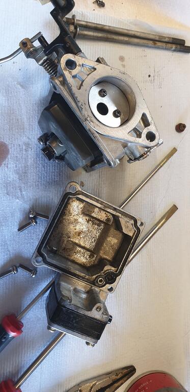

Mickwhitt 5,259 #2791 Posted August 3, 2021 So. Took off the carb, full of muck. Took off the fuel separater, some muck in it. Cleaned it all out and rebuilt it. Plugs were OK but gap was only 20 thou when the engine label says 40 thou so I reset them to the right gap. Pulled it over and it fired so all looks well. I'm going to let the owner have it back as I cant do much more than that and I don't fancy humping a bin full of water round the shop just to try it. Thanks to all for their input and guidance as always. Mick 3 Share this post Link to post Share on other sites

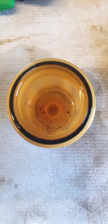

Ed Kennell 46,508 #2794 Posted August 3, 2021 Based on the shape of the hood, it looks like an older 2 stroke. When you removed the carb, was there a screen filter at the fuel line connection. There should also be a in line filter. 1 Share this post Link to post Share on other sites
Mickwhitt 5,259 #2795 Posted August 3, 2021 There was a fuel filter in the line but not at the carb. 1 1 Share this post Link to post Share on other sites
lynnmor 8,885 #2796 Posted August 3, 2021 With all that muck, the owner might want to dump the fuel tank and flush it. 1 1 Share this post Link to post Share on other sites
Mickwhitt 5,259 #2797 Posted August 3, 2021 This is the float chamber. Pretty messy in there. Hopefully a good clean will have sorted it out. this is the filter trap with plenty of sediment in the bottom. 2 Share this post Link to post Share on other sites

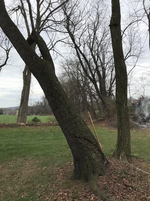

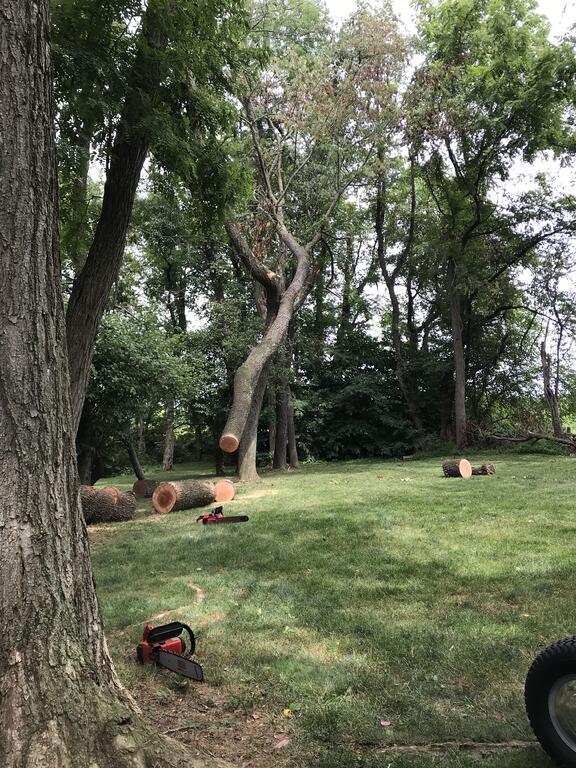

lynnmor 8,885 #2798 Posted August 3, 2021 I finally put this miserable cherry tree on the ground. It was rotten at the bottom and leaning so i left Mother Nature do her work. After months of increasing lean it finally snapped and landed in a crotch of another tree. I started by sawing pieces from the bottom till it was about five feet above the ground, then used a come along to tilt it away from the crotch. This was quite a fight because or the rigging in several directions and the wedging needed on a number of cuts. It fell the best way possible and will be reduced to firewood tomorrow. 4 Share this post Link to post Share on other sites
ebinmaine 79,577 #2799 Posted August 4, 2021 2 hours ago, lynnmor said: It fell the best way possible and will be reduced to firewood tomorrow Nice work there. Is that good firewood? We don't have those type cherry trees here. Share this post Link to post Share on other sites
lynnmor 8,885 #2800 Posted August 4, 2021 1 hour ago, ebinmaine said: Nice work there. Is that good firewood? We don't have those type cherry trees here. I would rate it at fair to good, burns a bit too fast and does create more creosote than oak. To give you an idea of the size, a 20” chainsaw wouldn’t reach thru till I was up 15 to 20 feet. We have carpenter ants that are steadily destroying trees here. They bore tunnels from the bottom up and build a condo, then water gets in starting rot from there down. I was fortunate on this tree, the condo was down low and the bulk of the wood is fine. Many of the locust trees are destroyed bottom to top and makes poor firewood. Good well seasoned locust is an excellent firewood or fence post. My lot was a jungle when I bought it and I cleared hundreds of trees and that payed for the land, this tree caused me more fear and trouble than any. I lost some nice large cherry trees last year and I couldn’t sell the logs or even give away some nice chunks to local wood turners. I thought that the wood had a higher and better use than firewood. I do burn about seven cords per year. 1 Share this post Link to post Share on other sites
