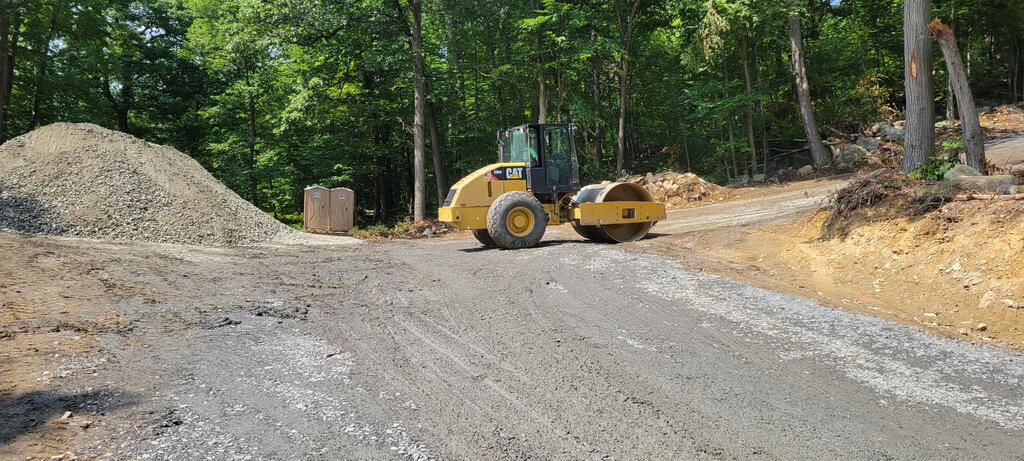

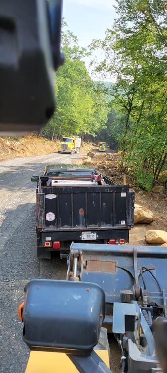

formariz 12,379 #2689 Posted July 26, 2021 @AMC RULES Big kid playing with the big Tonka Toys. 1 1 Share this post Link to post Share on other sites

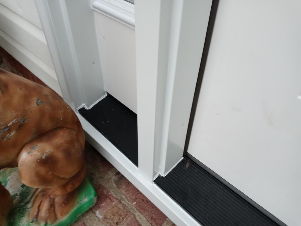

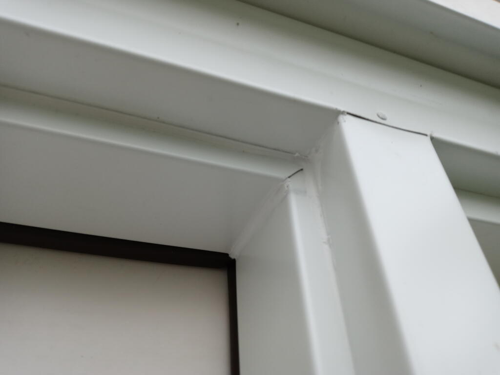

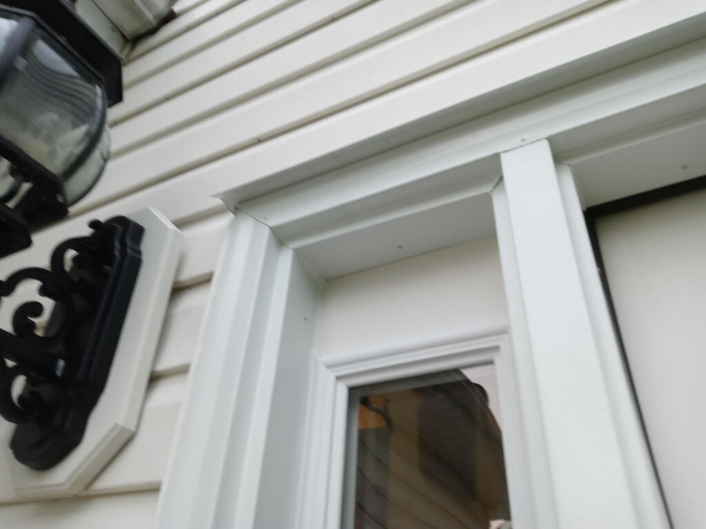

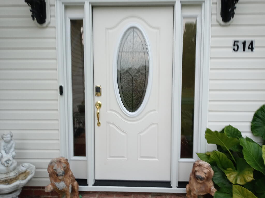

Horse Newbie 7,405 #2692 Posted July 26, 2021 So my neighbor had a new door with side- lites installed... As many of you know, and I personally do too, the brick mold and trim around these door units are not made of anywhere near hardwood. Even with proper installation and protective covering(paint), the wood seems to be prone to premature rot and decay... The best way to combat this is to cover the brick mold, and as much of the exposed wood with trim metal as possible. So I have a metal break, and that's what we did... What do you think ? 4 4 Share this post Link to post Share on other sites
tom2p 2,394 #2693 Posted July 26, 2021 nice job newbie ! 1 1 Share this post Link to post Share on other sites
Gregor 4,848 #2694 Posted July 26, 2021 I also have a break, and have done a lot of trim work. Nice job. 1 1 Share this post Link to post Share on other sites
Jeff-C175 7,209 #2695 Posted July 27, 2021 1 hour ago, Horse Newbie said: prone to premature rot and decay... One of my upcoming projects is to repair mine. I've had good luck using composite decking boards and machining replacement pieces about a foot up from the bottom. It's usually just the bottom part. My jury is out on the cladding. I am conflicted on protecting from, or trapping in, the moisture. Next one I install is going to get multiple applications of some sort of wood preservative before installation. 1 Share this post Link to post Share on other sites

rjg854 13,167 #2699 Posted July 27, 2021 10 hours ago, Jeff-C175 said: One of my upcoming projects is to repair mine. I'm sure you know that brickmold also comes in composite material like deck boards, even azek or similar products. May have to be ordered, but it is available. 2 Share this post Link to post Share on other sites
ebinmaine 79,574 #2700 Posted July 27, 2021 5 minutes ago, rjg854 said: I'm sure you know that brickmold also comes in composite material like deck boards, even azek or similar products. May have to be ordered, but it is available. We sell the CertainTeed brand at our location in portland. Keep a bunch of vinylboard moldings in stock. As we do the work to our own home Trina is changing all the moldings and trim over to vinyl board. 1 Share this post Link to post Share on other sites
